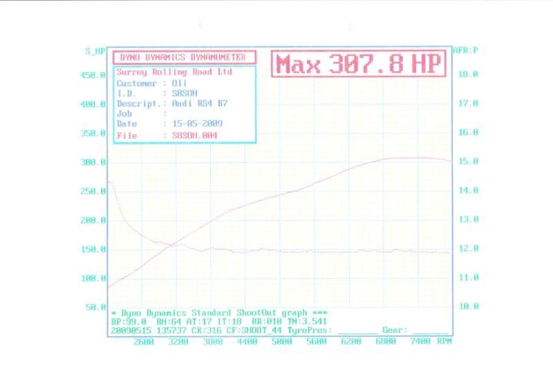

307.8bhp.....

Is your graph any different to that you got at Paramount?

Post by Oli » Fri May 15, 2009 4:49 pm
P_G wrote:Is your graph any different to that you got at Paramount?

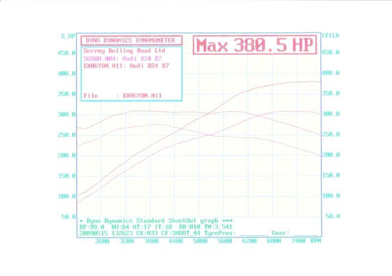

No not really, but quite clearly shows there still is a problem.. Sonny was there with his car, and that was nearly 80bhp more!! I guess I'll be keeping my appointment with Audi. CHarlie from SRR, suspected it was a gummed up inlet manifold, clogging the valve, and it feels just like the throttle isn't fully open.
I'll stick the plot up soon.
Andy, please can you pm your plot, so that I can show the dealer the differences

Cheers SH. First of all Audi is having mine back to investigate - It certainly doesn't have the power increase/surge @ 5000+rpm, and when I finally get my scanner to work you can see my power/torque is low all the way through, when compared to Sonnys car

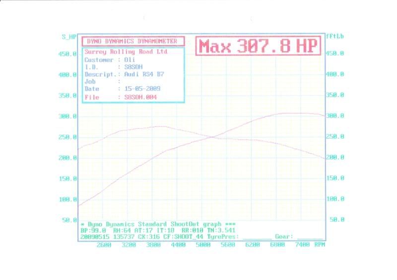

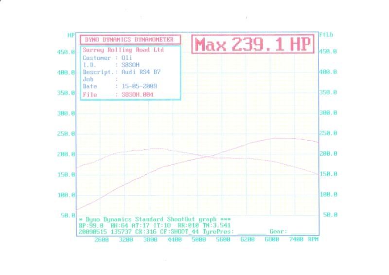

Post by Oli » Fri May 15, 2009 8:38 pm
As promised - sorry they are faint - Not sure how to darken them up??
Corrected flywheel graph
Wheel power - I think?
I believe this shows BHP as well as fuelling? Is this correct?
This is my plot against Sonnys, you can see my car is lacking right from the start
Comments Audi??
