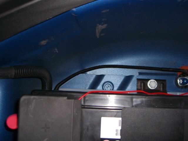

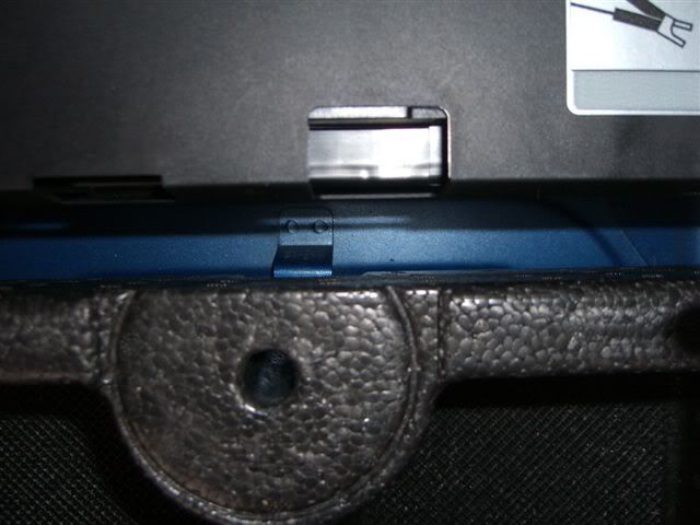

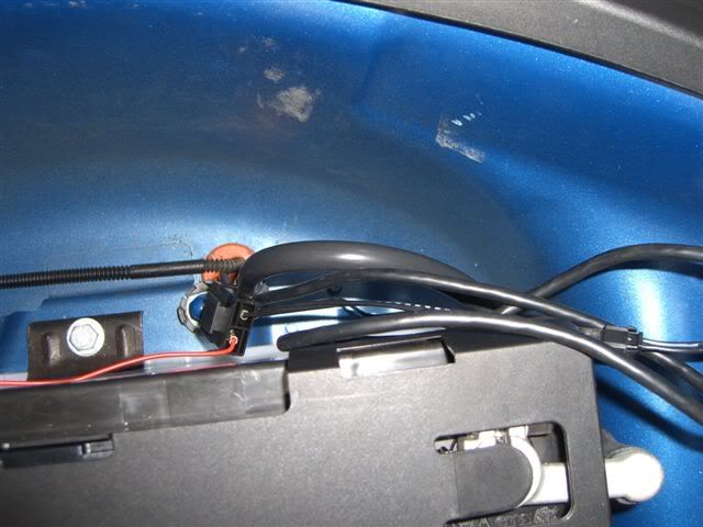

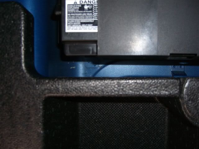

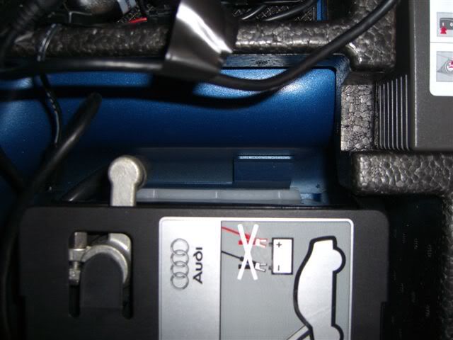

I have an Avant ... no sign of any crack ..
Which picture would show your crack ?

Andyuk911
Posts: 1128
Joined: Sat Sep 23, 2006 9:59 pm
Post by Andyuk911 » Thu Feb 05, 2009 8:10 pm
Ugh .. I bet I can guess what that is .. below are the DRC Cylinders .. so remove and weld ...
I am not letting them near my car unless it has the problem ...
