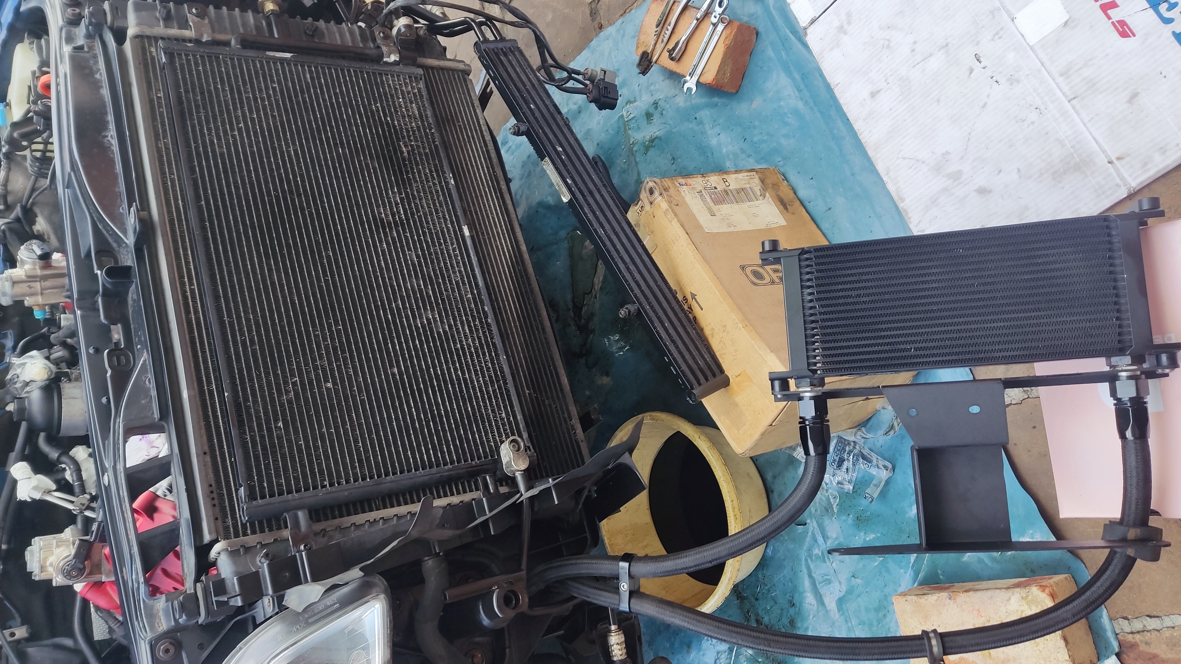

Thanks, have gone with the Radtec.
Caught just in time it seems!.....
Lines will make up using Forge adaptor to engine and AN12 braided hoses.

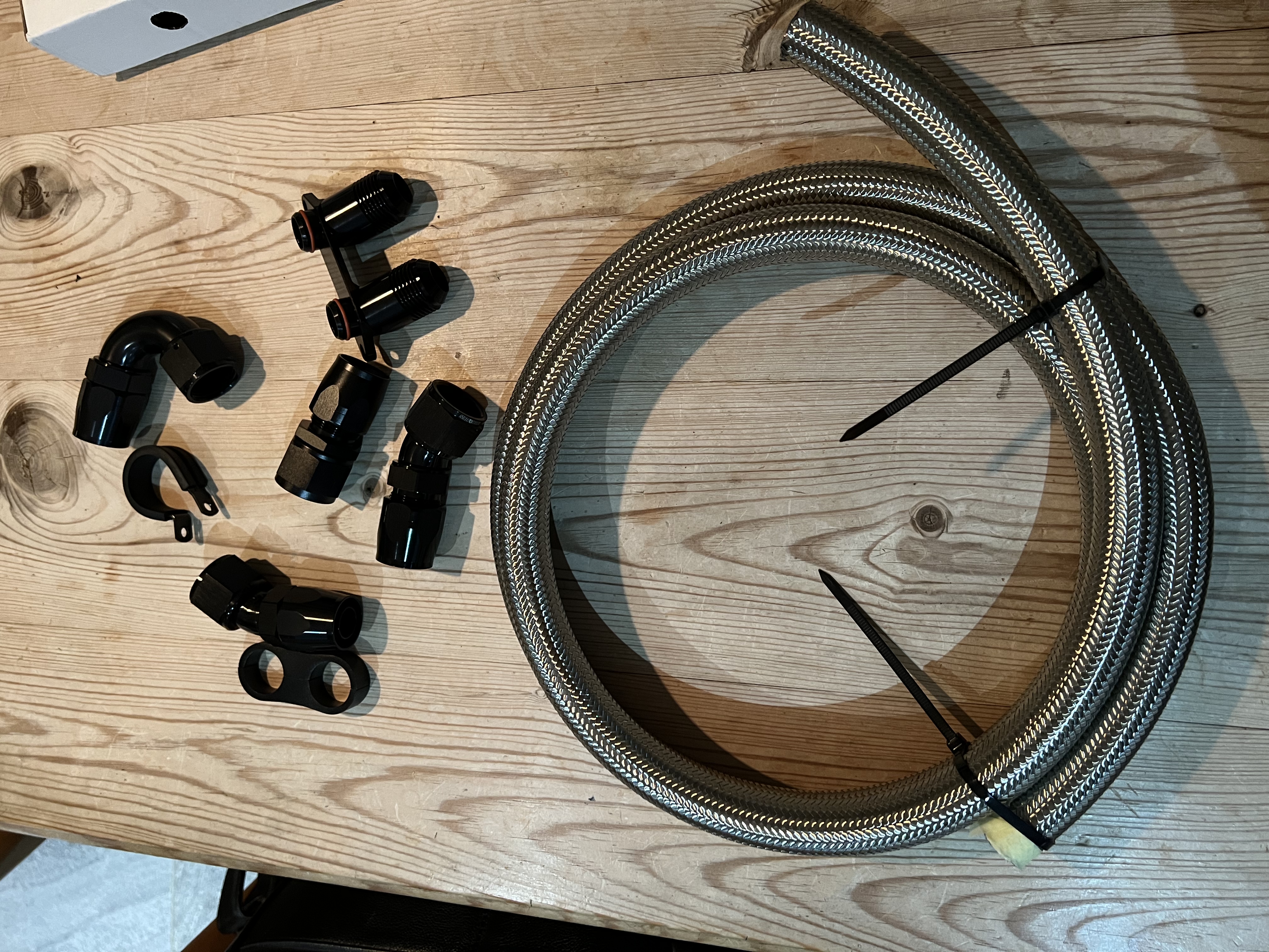

New AN lines ready to make up. I went for stainless braided over nylon braided per originals and for a stonger hose.
Will spray black.
Waiting on delivery of Radtec cooler.

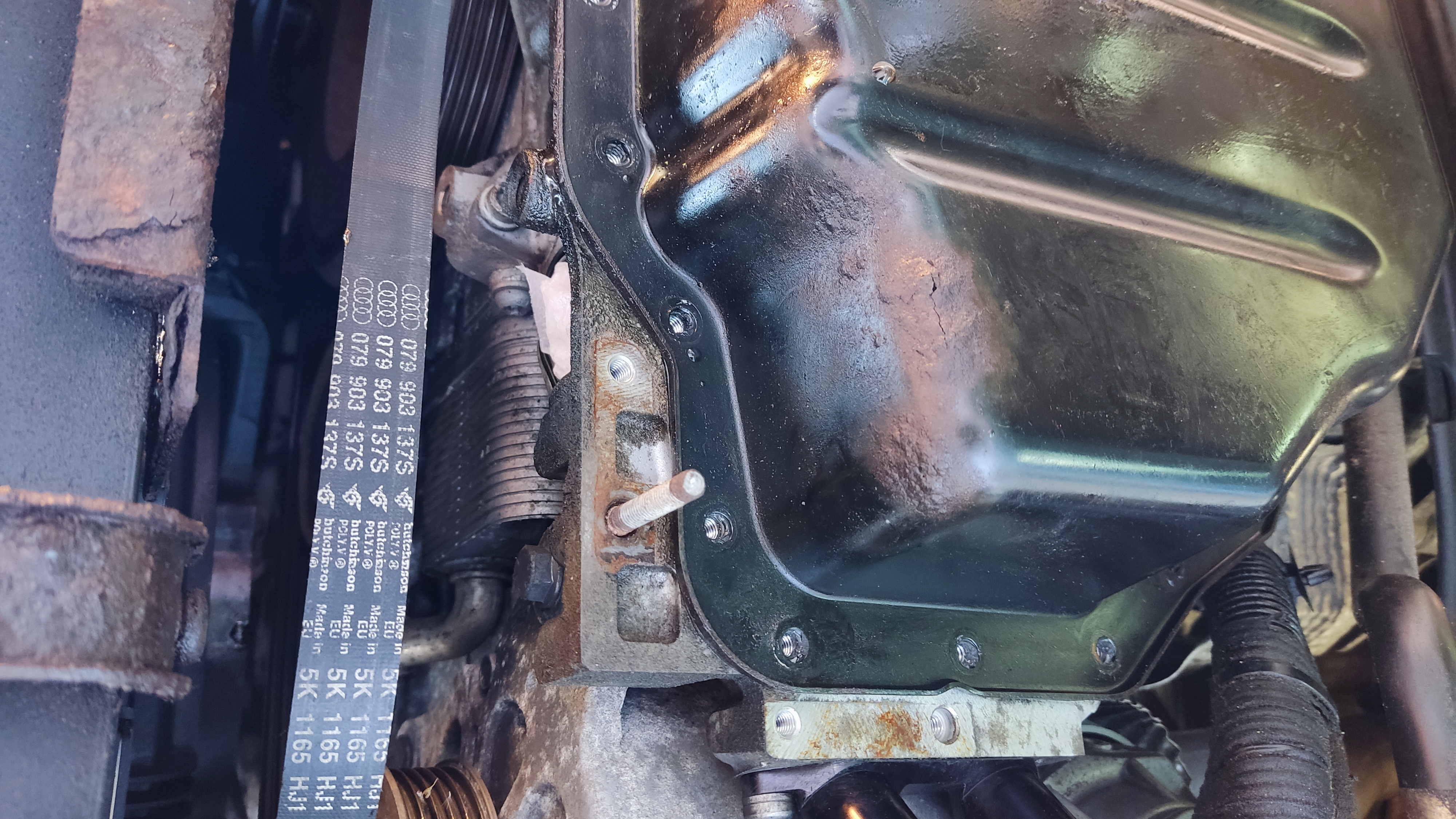

Access to and removing the sump (which is quite rusty) is a bit of a ball ache..
Firstly, as you have to remove the Coolant supply hardline pipe [079121481R] from the water pump to the engine block.. and I managed to strip one of the torx bolts in the process :oops:
Don't worry. Managed to partially drill out and remove the bolt .. thankfully without damaging the threads on the block..
-Would you know the torque valves for these Torx Bolts please?

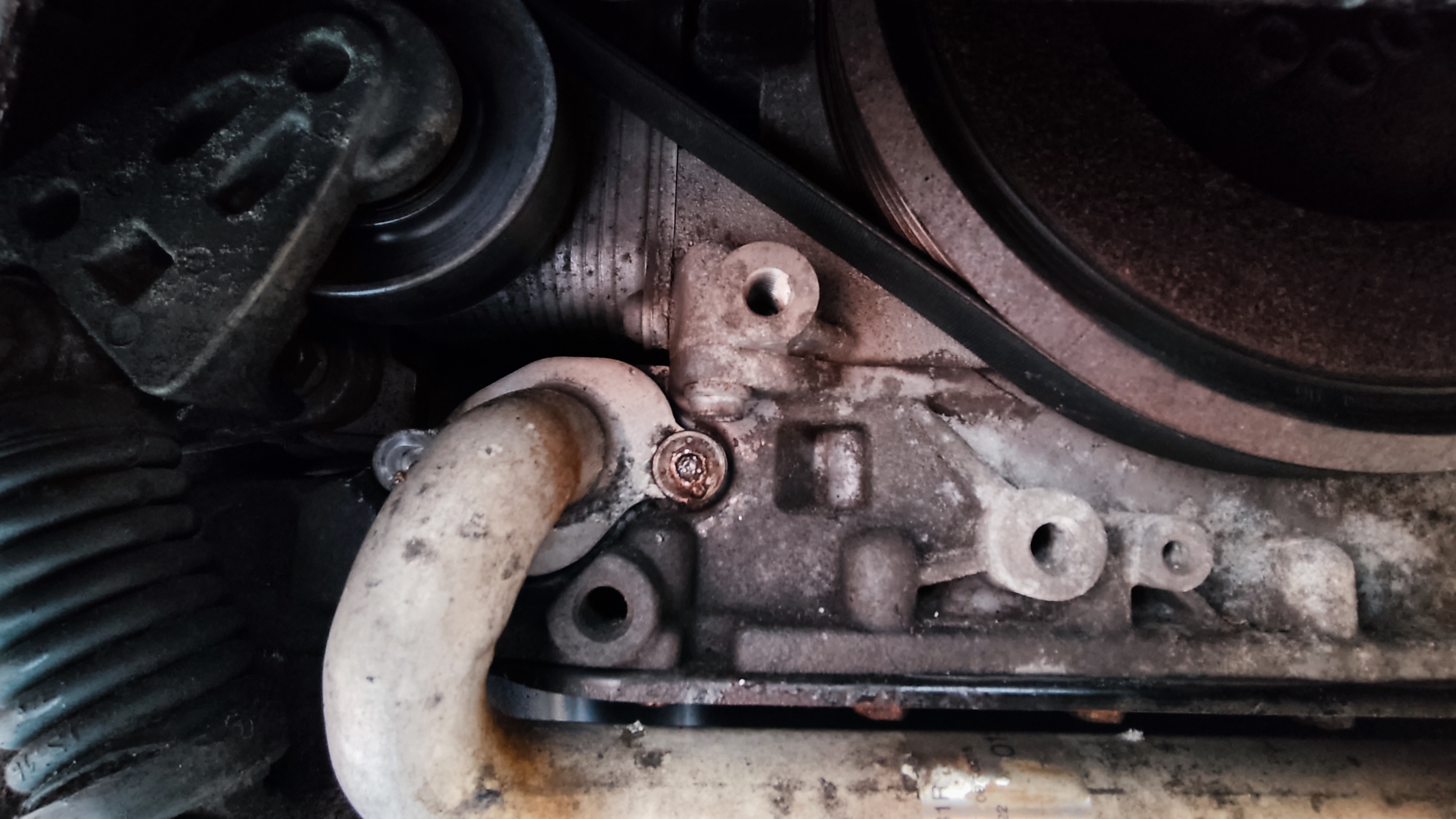

Secondly, have to remove the Bracket for Belt Tensioning Damper along with the tensioner damper itself.
Straight forward enough. until the the head one of the Torx bolts snapped :roll: - (I am not using power tools btw):
Torx Bolt is properly bonded / rusted to the block :evil:

lugars4 wrote:
Sun Nov 05, 2023 6:23 pm
Will spray black.

Looks great! I would have gone for the Radtec setup too.. ended up with the Forge Cooler unit which I'm also installing at the mo - as got for decent price (otherwise I think they're quite pricey)
