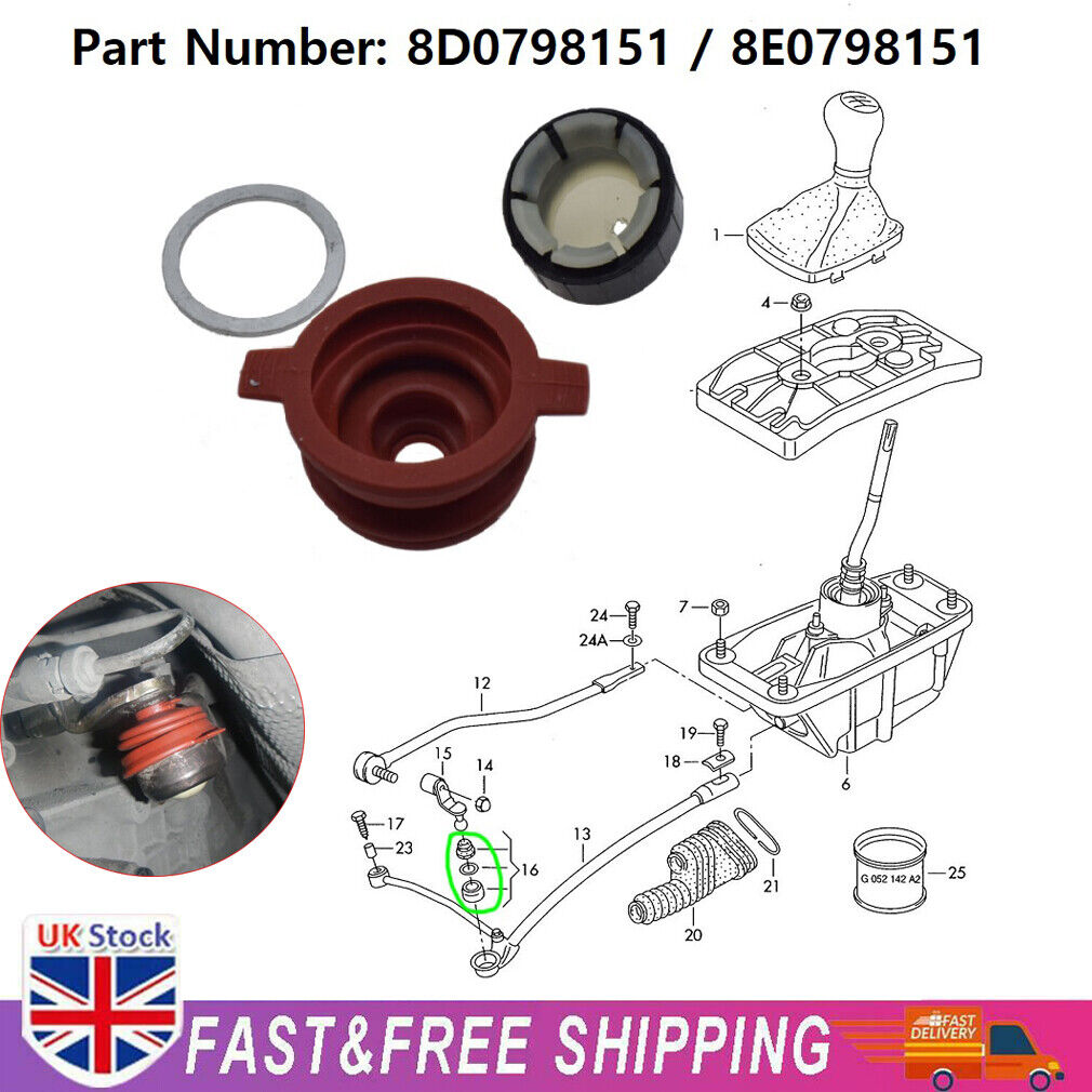

I was also thinking about replacing the (8D0798151) part, see image below.
I've heard it wears and makes a difference.
Does anyone know how easy this is to replace, i.e. access etc?

My mechanic replaced that when i had the prop shaft repaired ( feltham prop repairs ) they fitted a cosworth knuckle as mentioned it’s the only one that is strong enough ?? Certainly took the hum out of my car when above 40mph
The audi design was a bit crap and unrepairable
That gear ball joint has made my gearbox excellent again. 1st / 2nd was sometimes a no go and had to hit reverse first and then 1st
