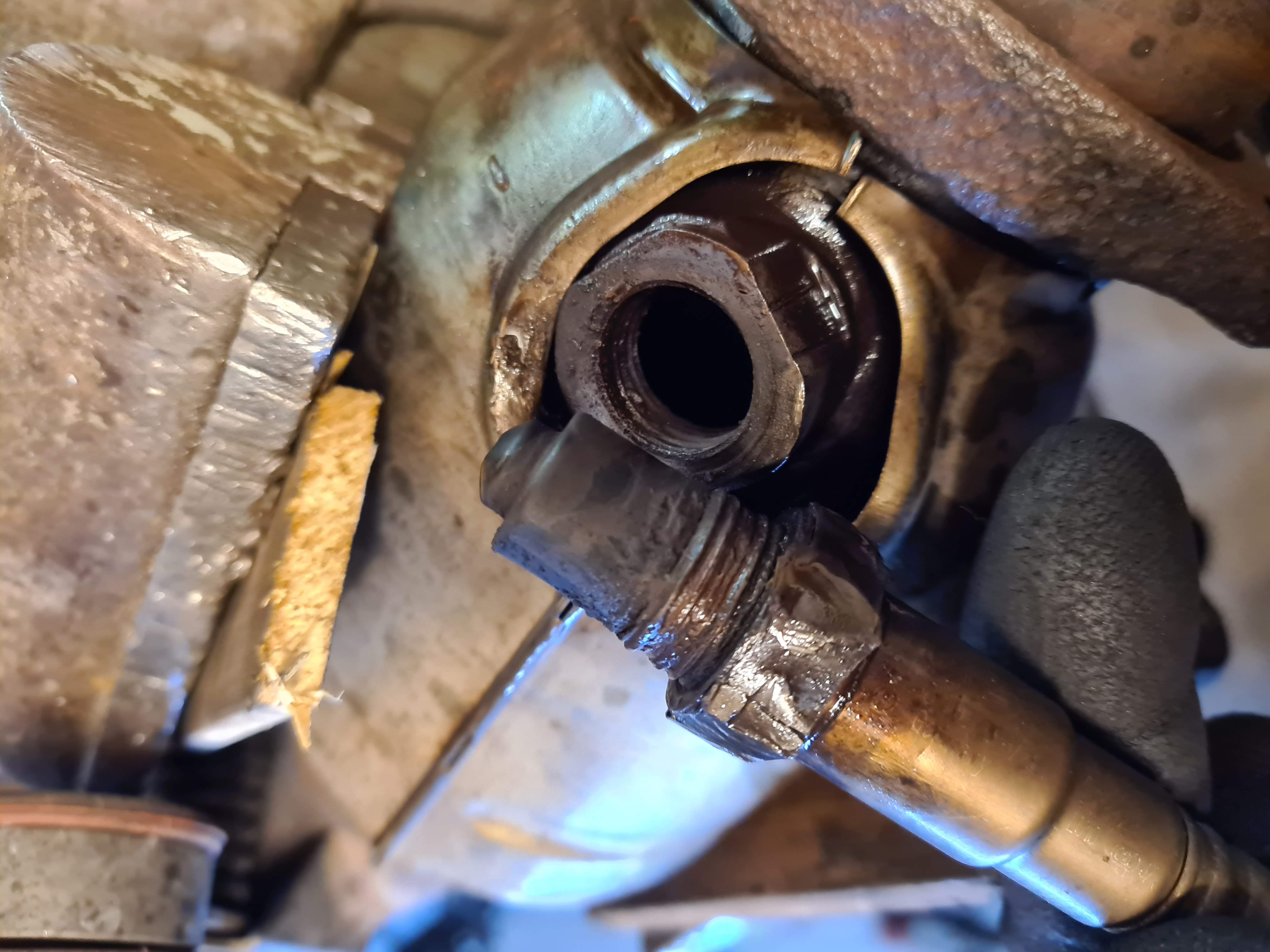

I've been doing a lot of work at the moment on mine. While the front subframe and gearbox and downpipes are out, I decided to do some preventative maintenance and loosen the 4 lambda sensors, clean the threads and re-apply some anti seize paste, the idea being that if one failed in the future, the hard work would be done, and I wouldn't need to drop the subframe/downpipes again. 3 of the 4 came out ok with a heatgun and some WD-40, but of course the 4th picked up the thread badly, and was a bitch to get out. Going by the manufacturer production date, all 4 appear to be original sensors from 2006, so I am thinking about changing both fronts.
