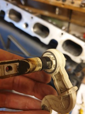

The potential reason for the "P2015 -008 Implausible Signal - Intermittent (Manifold Flap Bank 1)" fault code could be that was a lot of wear and free play between the plastic arm and the plastic gear on the tumble shaft.
https://youtu.be/XCnIKsblM1E
https://youtu.be/Ot5BaZGHfAQ
Only one of the arms was worn, the other was absolutely perfect, which is unusual, because they do the same amount of work. So, for me, it was worn because it was misaligned when it was built from the factory or when it was apart during the last carbon clean (i have no way of knowing). When you move it by hand or with a vacuum hand pump, you could see that it was also pulling to one side and not really following the stroke of the pneumatic actuator. I released the 2 fasteners, bent the bracket slightly, and re-tightened again. I used Würth PLASTIC ADHESIVE REPLAST EASY UNIVERSAL part glue to bond the arm to the gear and shaft. The surface needs to be rough. If I want to remove this again, I will just need to use a heatgun to de-bond it.
The decision to "de-flap" the manifold or not, was made for me. I did not have the correct Loctite to refit the screws back on and I wanted the car mobile again relatively quickly. I was not going to take a risk with the wrong loctite. I used the 034 Motorsport guide for fitting their Billet arms for info, and they recommend Loctite 290. If someone recommends something else, or can confirm what the factory uses, please let me know.
What I did notice, which is a little worrying, is that some flap screws felt OK, and you had to break the Loctite before they moved, but some came out pretty easy. too easy in fact... it was clear that the ones that came out easy (no snap or crack from the loctite breaking) had much less loctite on the thread. Again, I cannot say if this was from the factory, or if it was from the previous carbon clean.
