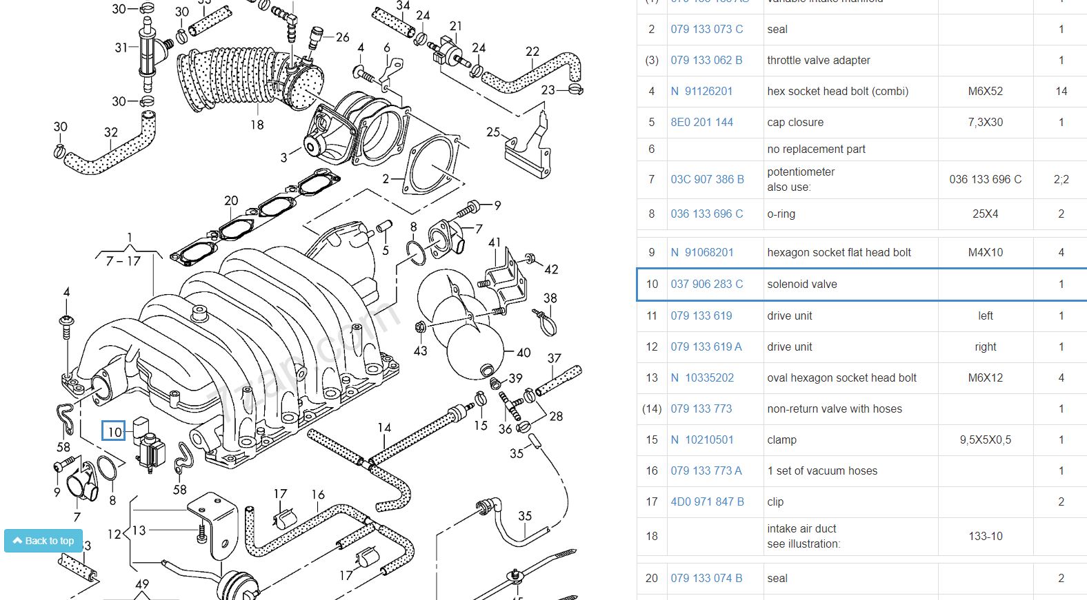

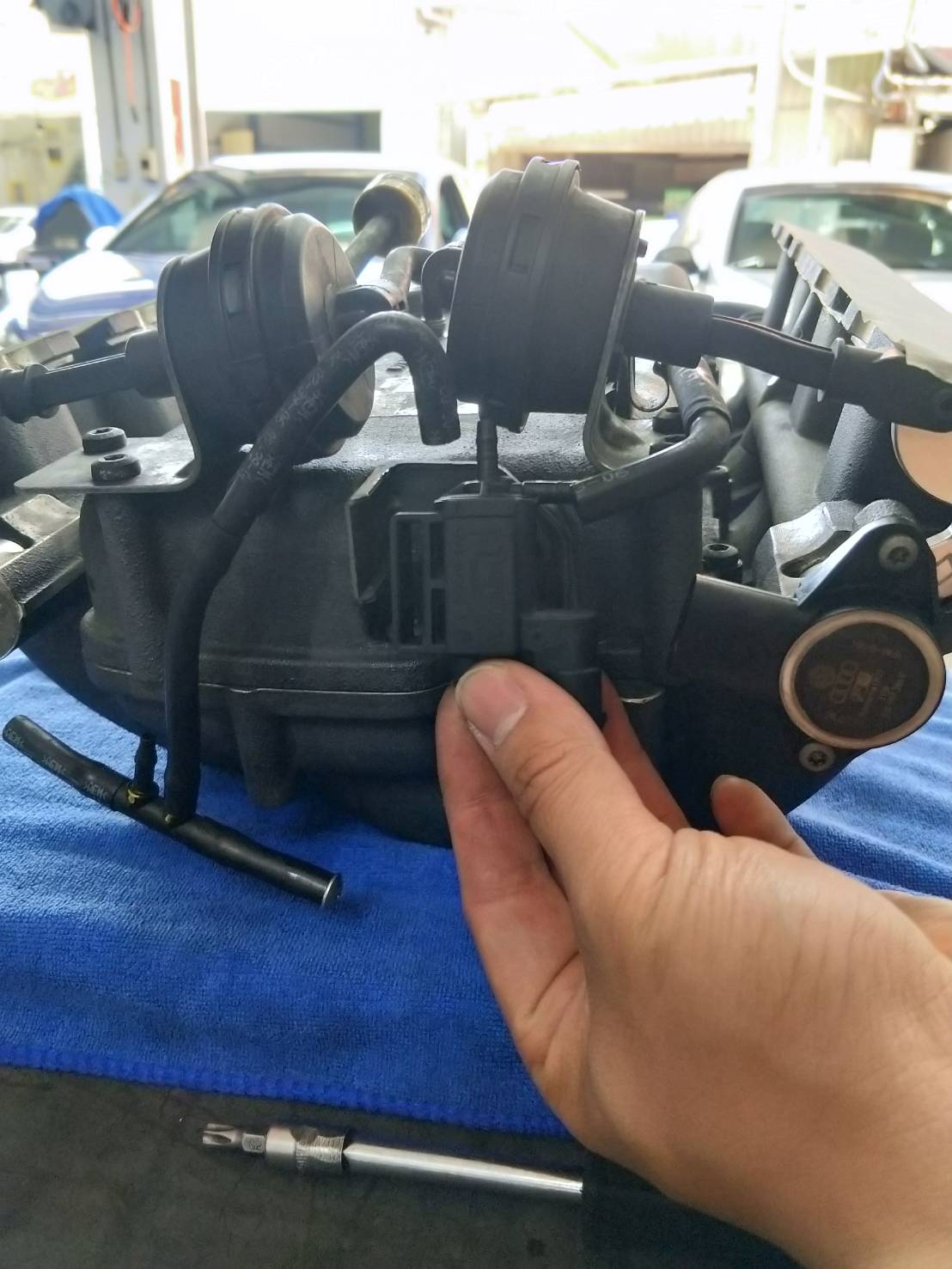

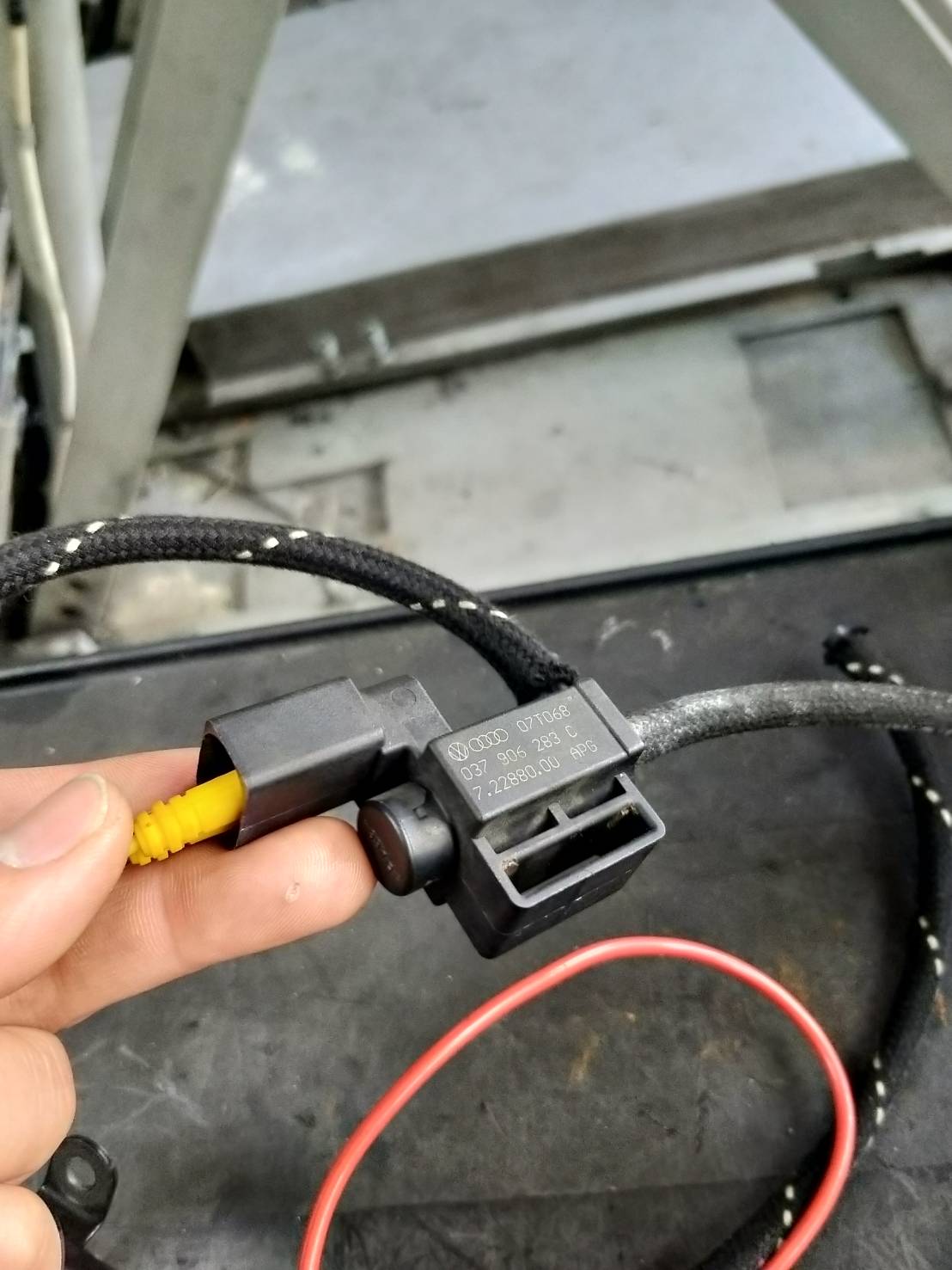

Thank you for your reply
So I spend a week on the test. Every time the test I need to wait for a car cold down. Finally, the problem solved today!
I check the MAF, ECU, Test vacuum leak (use the Smoke machine)... The problem is the solenoid valve. The problem not easy to find it, because it isn't obvious in the Smoke machine test.
Thank you, everyone. I thought I can not find it, until yesterday I ask on here.
