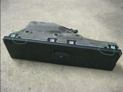

Has anybody retrofitted a fridge / cooling box to their B7? I've got a second hand one but it's currently installed in an old glovebox and apart from using brute force to remove I can't figure out how to get it out.
There are 3 x torx screws along the bottom, which I've undone, and that's as far as I've got....
Can anyone help?

Open the cooler door and at the back there may be the inlet plug from the A/C. Unscrew and remove that and the whole unit should slide out, if you’ve removed the 3 T8 screws.

Kenny147 wrote:Open the cooler door and at the back there may be the inlet plug from the A/C. Unscrew and remove that and the whole unit should slide out, if you’ve removed the 3 T8 screws.
Thanks Kenny - have removed the inlet plug and the 3 x screws so just keep pulling?

Forgot.....there are two clips about 4 cm in from each end at the top. You’ll probably need to “lift” the glove box shelf above the cooler, up a bit to get it out.

Kenny147 wrote:Forgot.....there are two clips about 4 cm in from each end at the top. You’ll probably need to “lift” the glove box shelf above the cooler, up a bit to get it out.
You're a legend. Thanks mate
Thank you again for this. Just released the cooler by prying up the 'shelf' which would normally hold the CD changer and it came out very easily.
For anyone else looking at doing this remove the 3 Torx screws, unscrew the vent at the back (inside the cooler) and then lift up the shelf with a trim removal took to release these 2 catches and it'll slide out.
