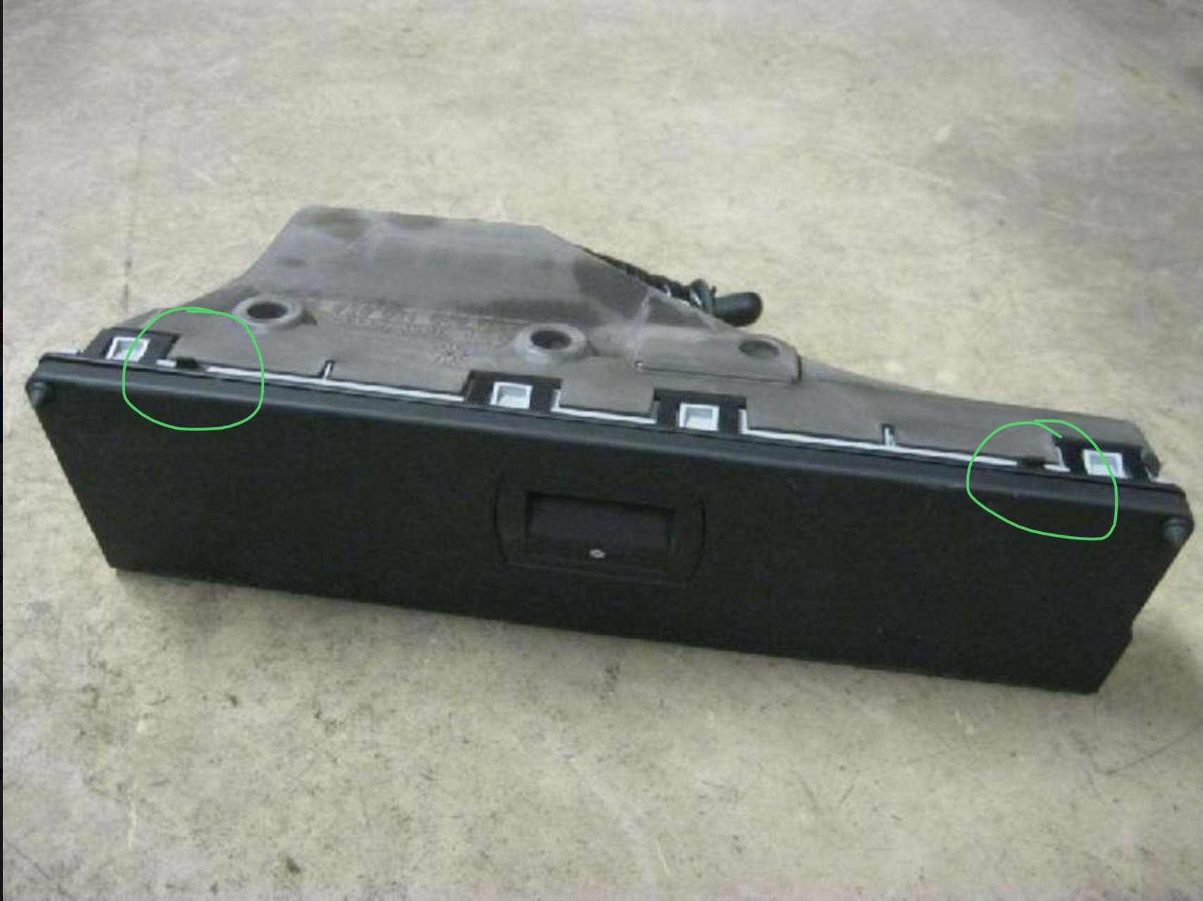

Forgot.....there are two clips about 4 cm in from each end at the top. You’ll probably need to “lift” the glove box shelf above the cooler, up a bit to get it out.

Kenny147 wrote:Forgot.....there are two clips about 4 cm in from each end at the top. You’ll probably need to “lift” the glove box shelf above the cooler, up a bit to get it out.
Thank you again for this. Just released the cooler by prying up the 'shelf' which would normally hold the CD changer and it came out very easily.
For anyone else looking at doing this remove the 3 Torx screws, unscrew the vent at the back (inside the cooler) and then lift up the shelf with a trim removal took to release these 2 catches and it'll slide out.
