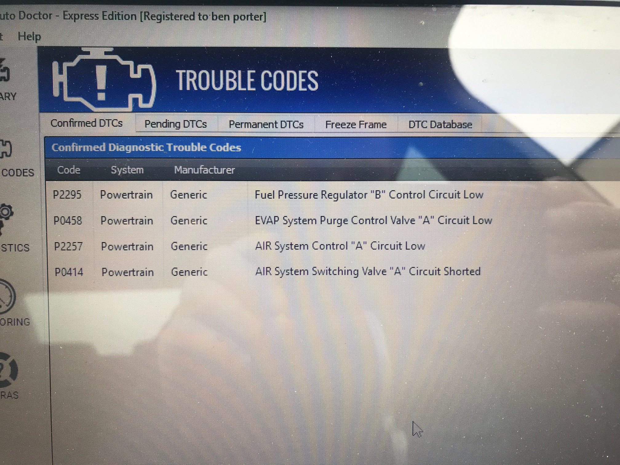

Do you have the codes that were showing?
Ta
Mike
Sent from my PRA-LX1 using Tapatalk
slowcoach
Posts: 35
Joined: Thu Jul 30, 2015 1:20 pm
Re: B7 Electrical issues , Wiring diagrams Etc
Post by slowcoach » Fri Apr 12, 2019 10:45 am
Stupidly i cleared all codes first, this is what i got immediately afterwards.
They are saying there is more codes with the kit they use.
