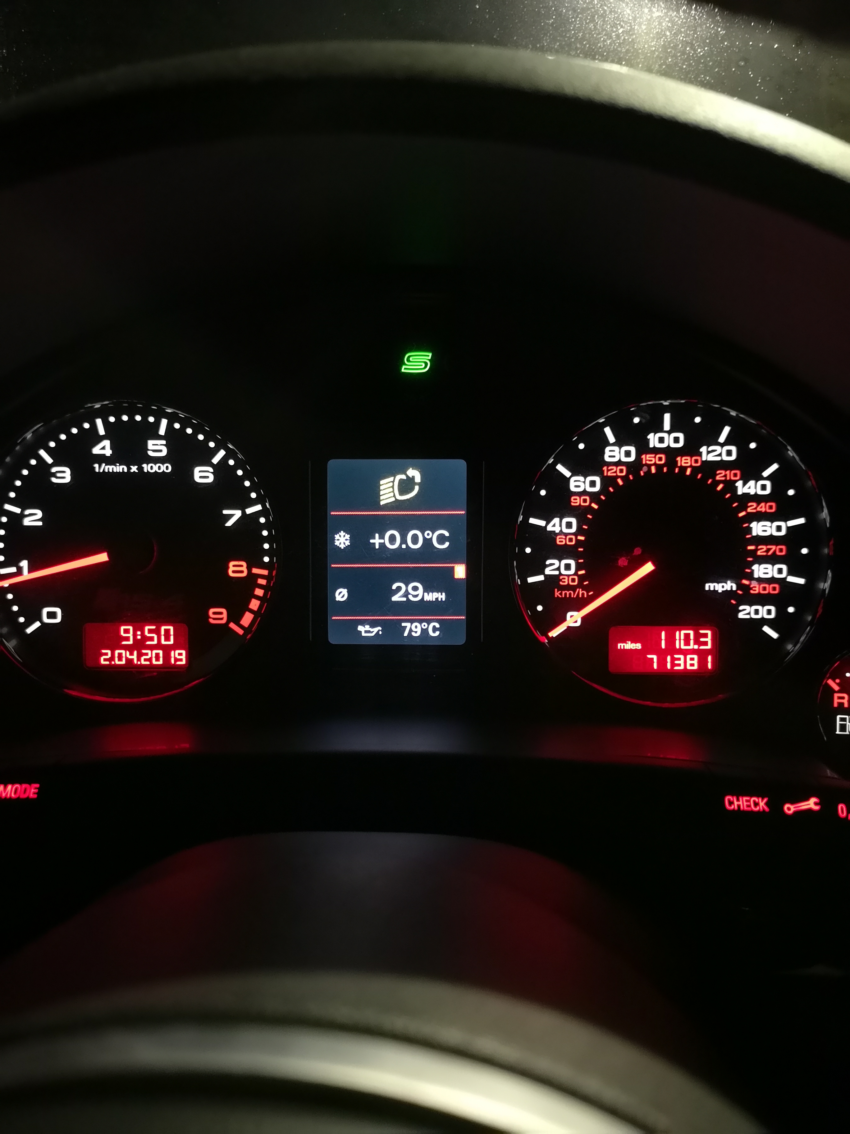

Picture of fault light

I am not sure that light is a ballast error - I think it might be the self levelling lights in error.
That error can mean a multitude of things and without running a scan with VCDS, you’ll simply be throwing parts at it, unless you get lucky.
Because I’m an idiot and refused to simply throw money at my car, I learnt more than I ever wanted to know about the ballasts and headlights, in our cars. From memory, some of the things that can cause that error symbol to show up........
Bad bulb....you’ll get a flickering light first. Goes away when you turn the lights off, then on.
Bad ballast....lights won’t do the up/down/left/right dance, when you turn them on.
Chaffed wire inside the headlight unit.....As above for a bad ballast.
Bad leveling sensor....not sure about this one but a quick check of the two sensors might reveal whether this is the cause.

I don't throw money at things either. I had it scanned when it was in for a service I'll dig out the codes. The lights scan up and down but not left and right. The lights flicker sometimes and go out but switching them off and on brings the light straight on.
J667 - power output module for headlight(rep. Gr. 94)
0055 power regulation
2233 14 left power output stage (faulty static)
