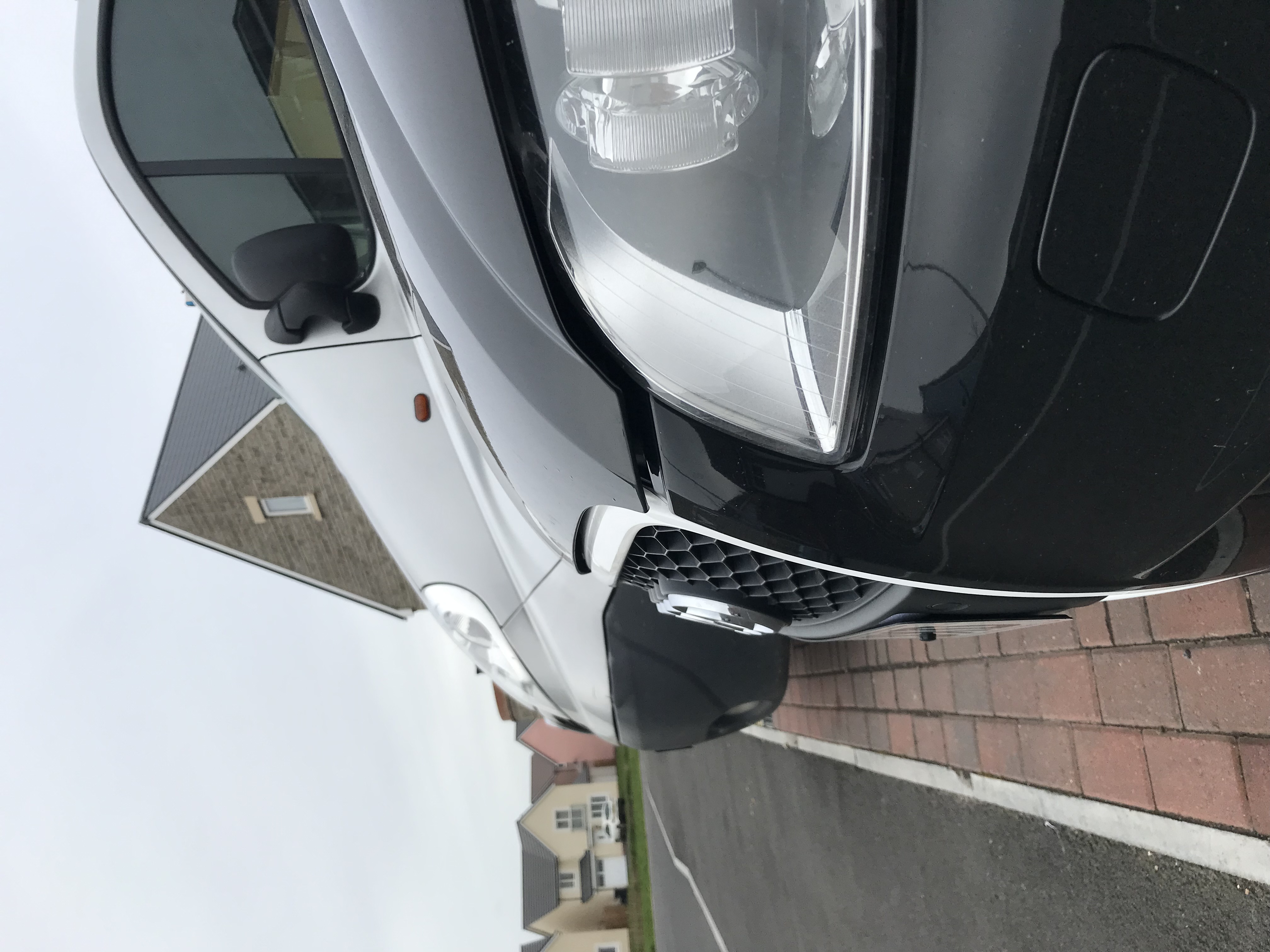

I am getting pee’d off with this gap below the centre of my bonnet, pretty sure that is not supposed to be like that, although half the rs4’s I see have it...... is there anyway to fix this without taking it to a body Shop??

I would say the gap on yours is fairly small. Mine is on the larger side and waiting until it goes to MRC before doing anything about it. There’s a screw type stop either side of the grill that the bumper sits on and it’s these that you need to adjust to reduce the gap.

I think you need to slacken off the bolts holding the front bumper on first before turning the adjusters, otherwise they break.

Yeah I'm sure there's a 'how to' on here somewhere. There is a certain amount of adjustment using the two adjusters but I found with mine I also had to slacken off the retaining fixtures for the whole bumper, some of which are in the wheel arches and a pita to get to. Even then I never managed to get it perfect, certainly no better than in the OPs photo!

If you have a search you'll find a couple how tos. May also need to loosen off the headlights. It's a prick of a job, need a long handled torx for it as well.
Yours isn't that bad though. You might get it a little better but likely not a lot.

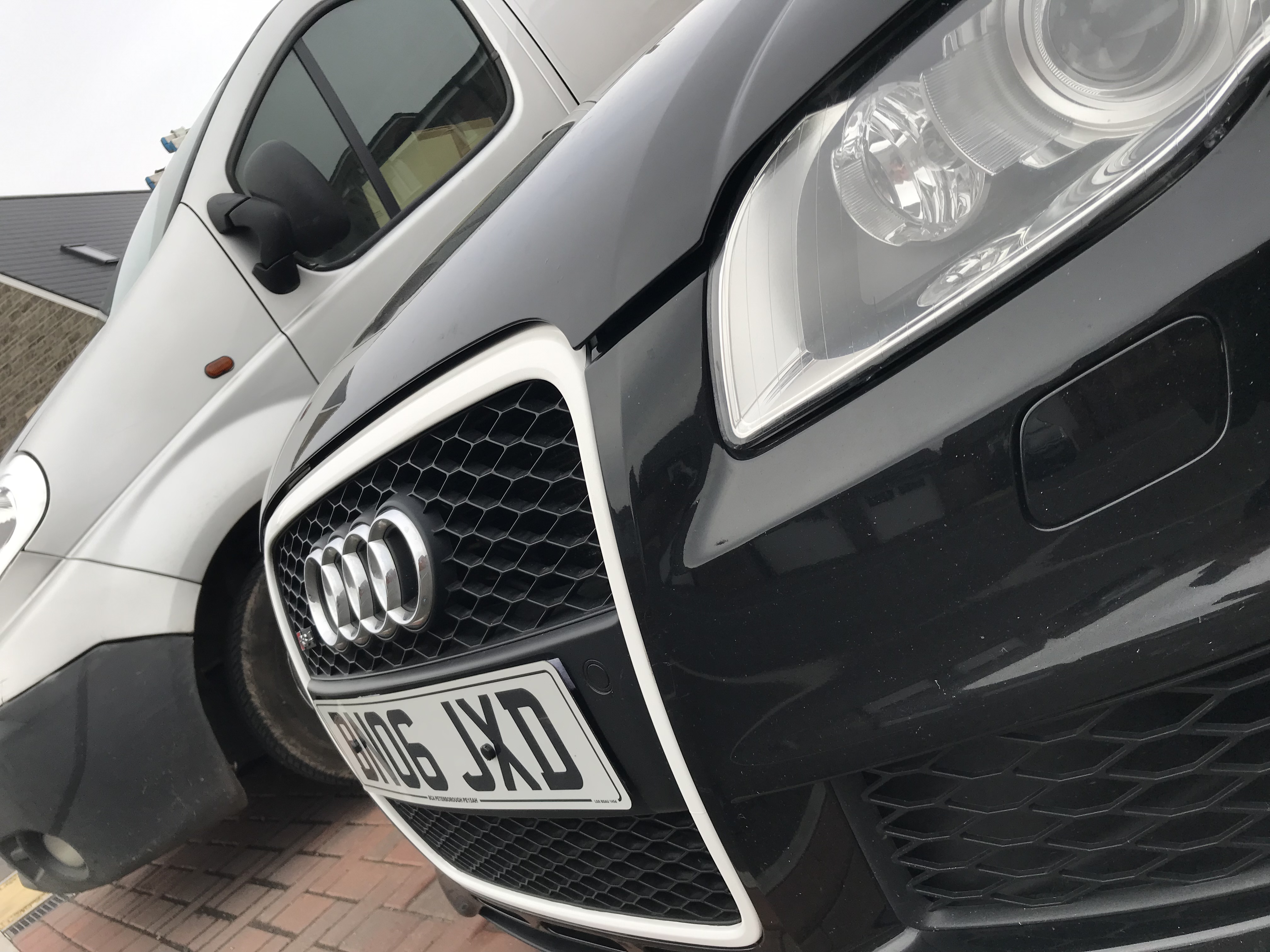

Maybe is just me,but I thought it looked pretty bad from these angles

I’ve had to take mine off a few times, so I’ve gotten quite good at getting it close but I still can’t get it down to the 5mm the manual says it should be. WTF?
It looks like you’re bumper can go up a few mm’s as there’s a gap below the headlights. You’ll need to loosen the 3 headlights screws on each side and all the bumper mounting points before you adjust the bumper. It’s a pain to get right on your own and much easier if you have some help.
