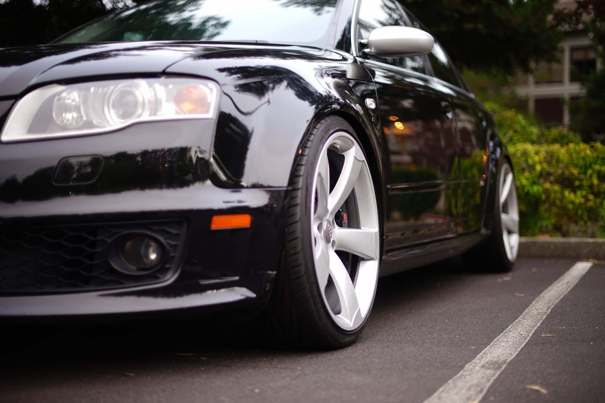

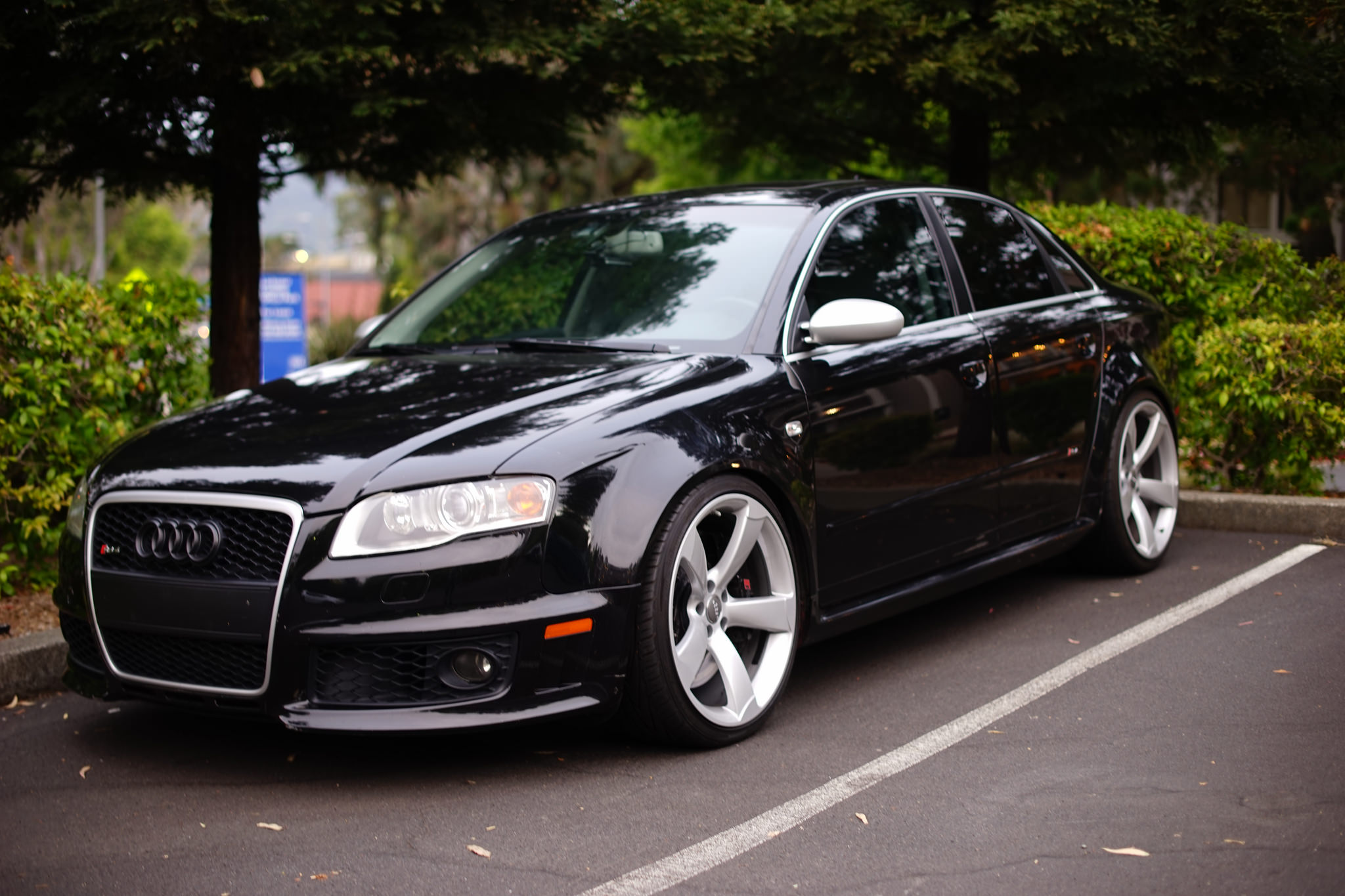

255-30-20 seems to be a popular choice. (Photos form the net with these size tires)

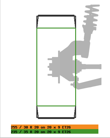

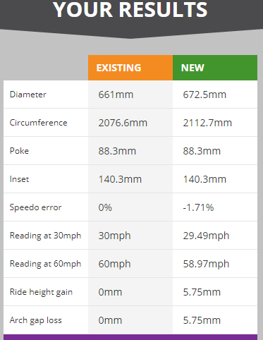

Did some basic sizing on "willtheyfit.com". If, I were to go with the more easily available 35 profile. I could come close to the 255-30-20 profile.
235-35-20 is almost the same as 255-30-20. There is a ride height gain of only 5.7 mm. Which I can live with as the 35 profile would give just the slight bit of extra cushion compared to 30. Not to mention the cost saving.
