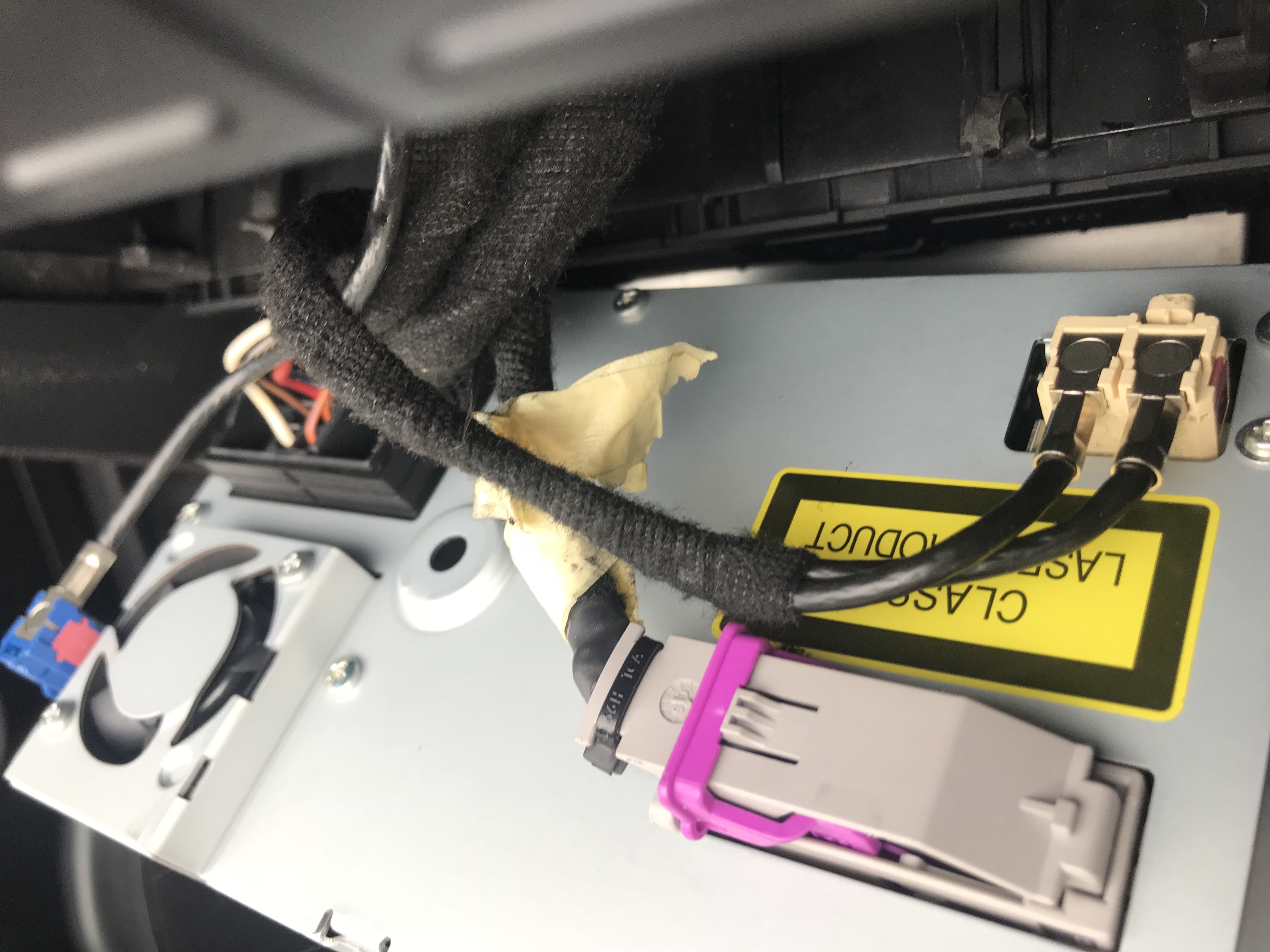

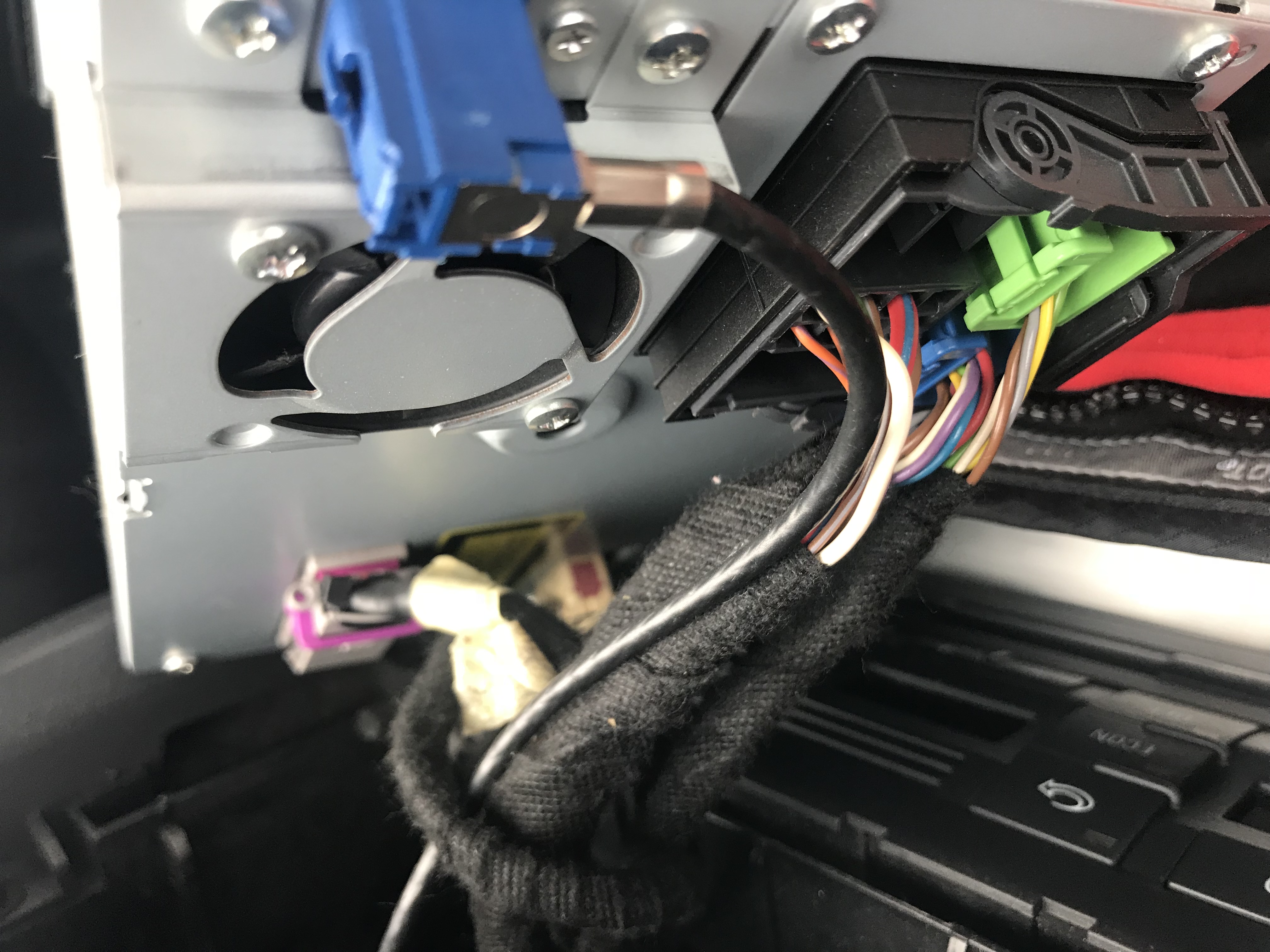

looks like you've already got something hooked up to the socket where the aux in goes.
Do you have a tv tuner / camera or similar?

Yep, something already in the slot, see what that is first, likely to be tv tuber which doesn't work now anyway. The bottom of the two links is all you need. It's three wires, nothing special.
