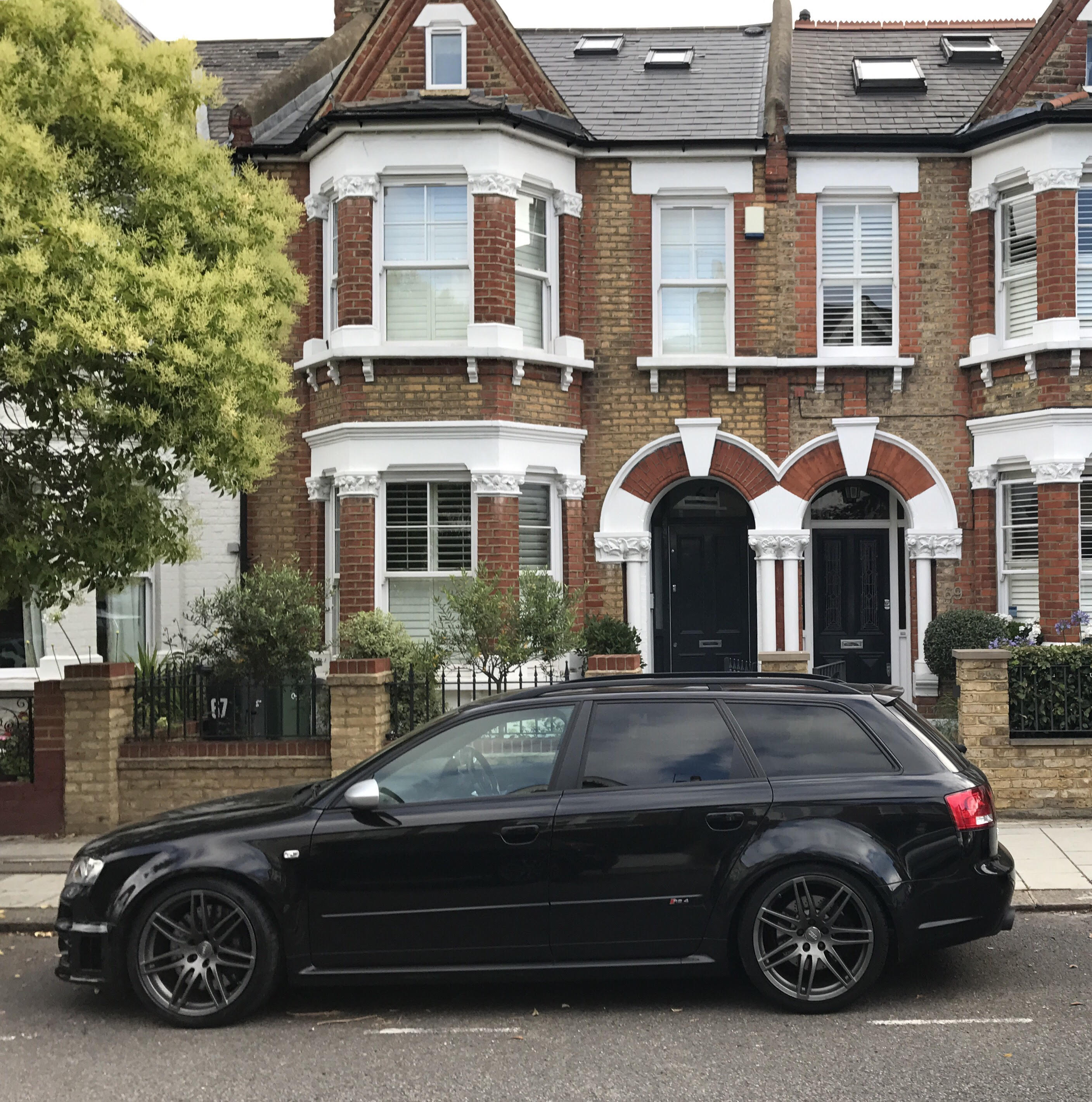

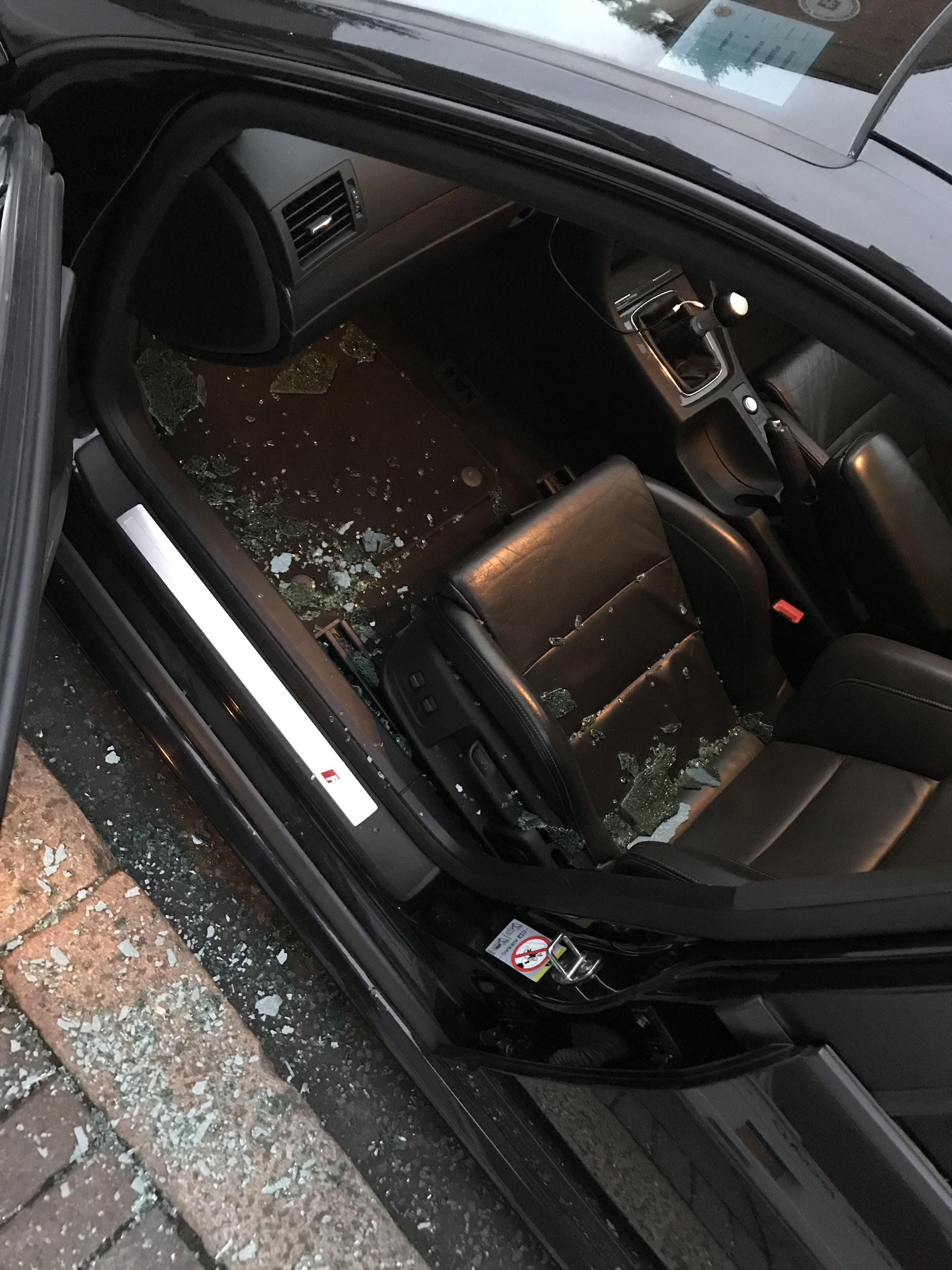

Hi all,
I've been a long time browser on the forum and recently bought my first B7 RS4 Avant from fellow forum member Kenny in Glasgow. I've had the car for a few months now and loving it!
Sadly this morning I came out to a smashed passenger window which at first I thought was just vandalism. On getting into the car I noticed they had started to rip the internal light unit from the roof liner. I understand this is how thieves are disabling the alarm to then freely work at getting the seats out. I feel lucky that someone must have interrupted them or driven past!
Assuming they were trying to get at the seats, I am worried they now know where the car is... I will park off street at a friends house for now but as a more permanent solution, I am thinking of having the alarm upgraded. Have any of you guys done this and if so who would you recommend. It looks like the viper system from Securemycar is a good job from initial investigations.
Any help much appreciated.

To the OP, yes I would say that was an attempted seat theft not vandals.

These seats are being stolen due to 2 flaws with the oem alarm; it is almost silent and easily disabled.
An aftermarket alarm with proximity sensor that will beep at them when they peep in the windows will be a good detterent because it is much louder than the near silent oem alarm and they know it is not disabled as easily as the oem one from the courtesy light.
I would also fit some security film to the insides of the windows, as this should stop them even being able to get into the car to steal the seats and stop a lot of the damage that happens from breaking in and stealing ie the door cards damaged, seats ripped etc.
