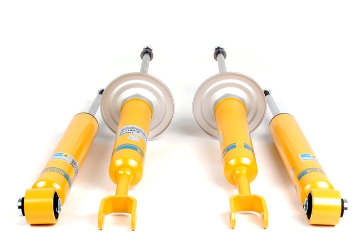

Has anyone on here got any experience with the Bilstein B8 Damper?

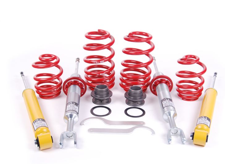

When I bought my RS4 here in Germany, it was already fitted with a H&R coilover kit, so I dont have any experience with the original DRC suspension. It was set too low, so after removing and cleaning up all the threads, I raised the front 20mm, and then could only raise the rear 15mm. there was no notes from the previous owner on how low he went front and rear from the standard car. regardless, its still too low anyway for normal use.
Maybe I am getting old, but to be honest, I find this H&r kit a little harsh. it doesn't really ride the small bumps well, and even has a little of the Porsche front end bobble going on when the tarmac has some waves in it! I'm just not happy with it, as it doesn't seem to do anything well.
I'm interested to hear if anyone on here has fitted the B8 dampers with the standard springs. I really want something back close to the standard ride height, and this seems like an easy way to get there.

i looked at the b8 -the only thing putting me off them is the very thin looking front damper rod
other than that these would fit the bill for me with standard rs4 springs

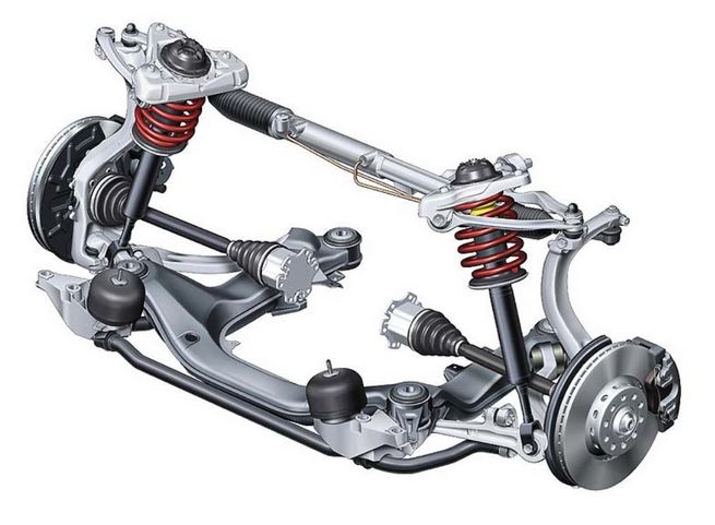

I'm not so worried about that...Bilstein got a good name for their "upside down" front damper, with the large diameter outside tube to take some side load when cornering.
But the Audi suspension set-up on the front is more like a double wishbone style, so all the side loads go through the suspension lower and upper arms, distributed by the large upright. This means that the front damper only sees forces in the compression (and a little in rebound) direction, so the tube doesn't need to be that big. in fact, the smaller it is, the less friction it has!

its most likely up to the job-but bigger damping rod has to be better at transferring heat,stronger by design-and the flagship dampers[b14/16] have the bigger rod for a reason...they would work out just over half the price of b14 and are still a quality item

I did find some info from a US website, that said that B8 were "shortened struts" for lowering springs, and the B6 was standard strut length.

i had a change of heart-ordered and paid for kit early on week
found out my cars original springs werent going too appear,coupled with the fact that the german b8 seller was still unsure if they were correct for rs4 i cancelled my order
ordered set b14 and will see how they do
