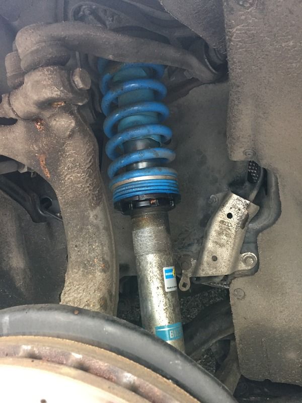

weekenny
Posts: 163
Joined: Sat Apr 23, 2016 10:56 pm
Location: Glasgow Area-ish
Re: Bilstein b14 quetion
Post by weekenny » Sat Feb 18, 2017 9:34 pm
I've attached a picture of mine. I wasn't sure about how it would seat but went with the instructions. The B16 it goes to the bottom.

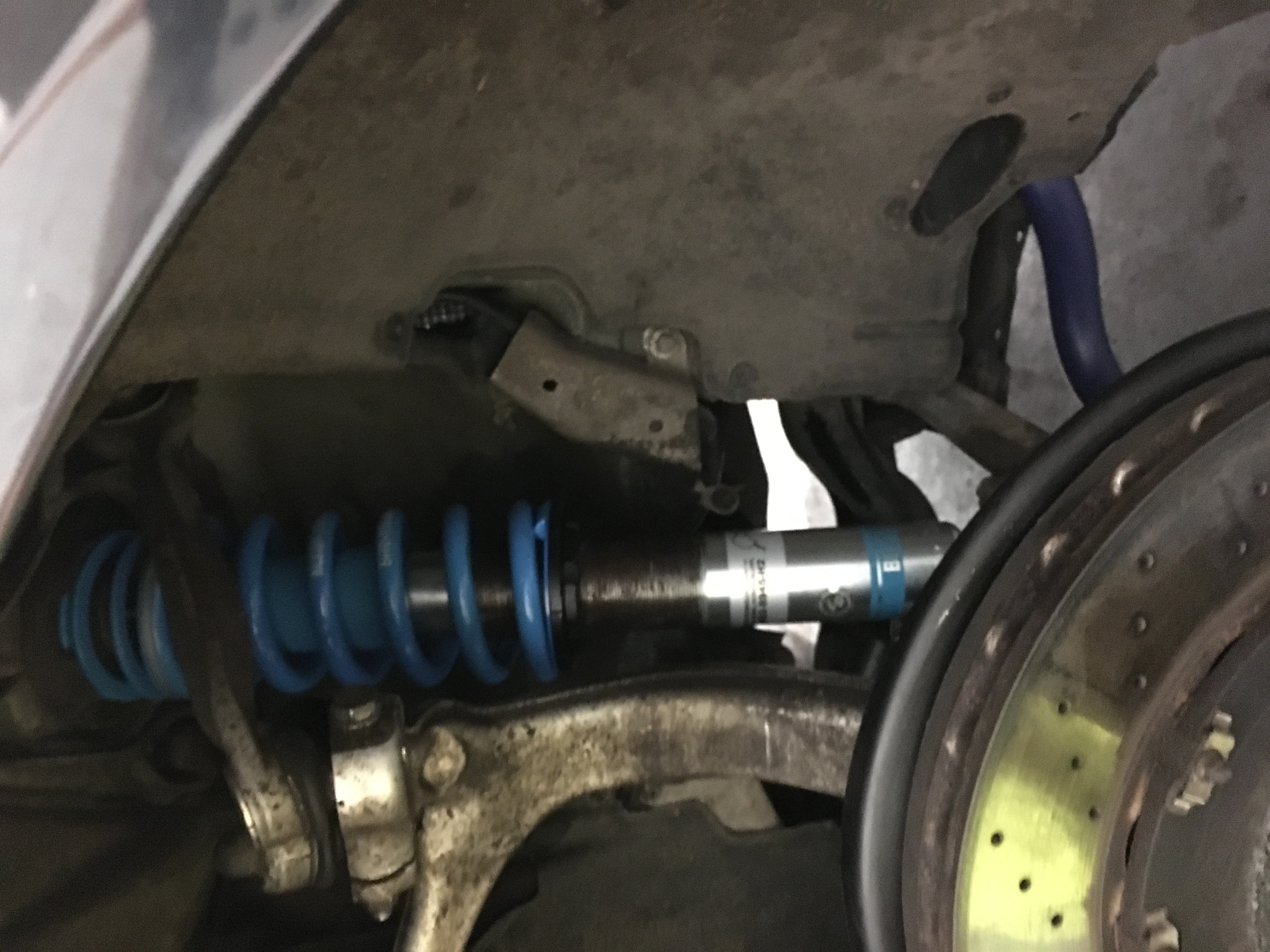

pule333
Posts: 1408
Post by pule333 » Sat Feb 18, 2017 11:46 pm
I have fitted mine at the bottom as it would not fit correctly at the top. I have spoken with bilstein regarding this and they said it makes no difference really where it is fitted because it will be compressed anyways at normal riding conditions. As long as the top spring fits correctly in to the cup.Image

pule333
Posts: 1408
Post by pule333 » Sun Feb 19, 2017 12:08 am
Starry wrote:
That was my thought, the thick spring sits properly in the top rubber mount. Cant work out why my helper springs are fully compressed whilst jacked up...
Yeah agree that's a bit wierd. Mine not like that when jacked up. Maybe your set very hight?? Image

pule333
Posts: 1408
Post by pule333 » Sun Feb 19, 2017 12:16 am
Same as me. Wierd..Image
