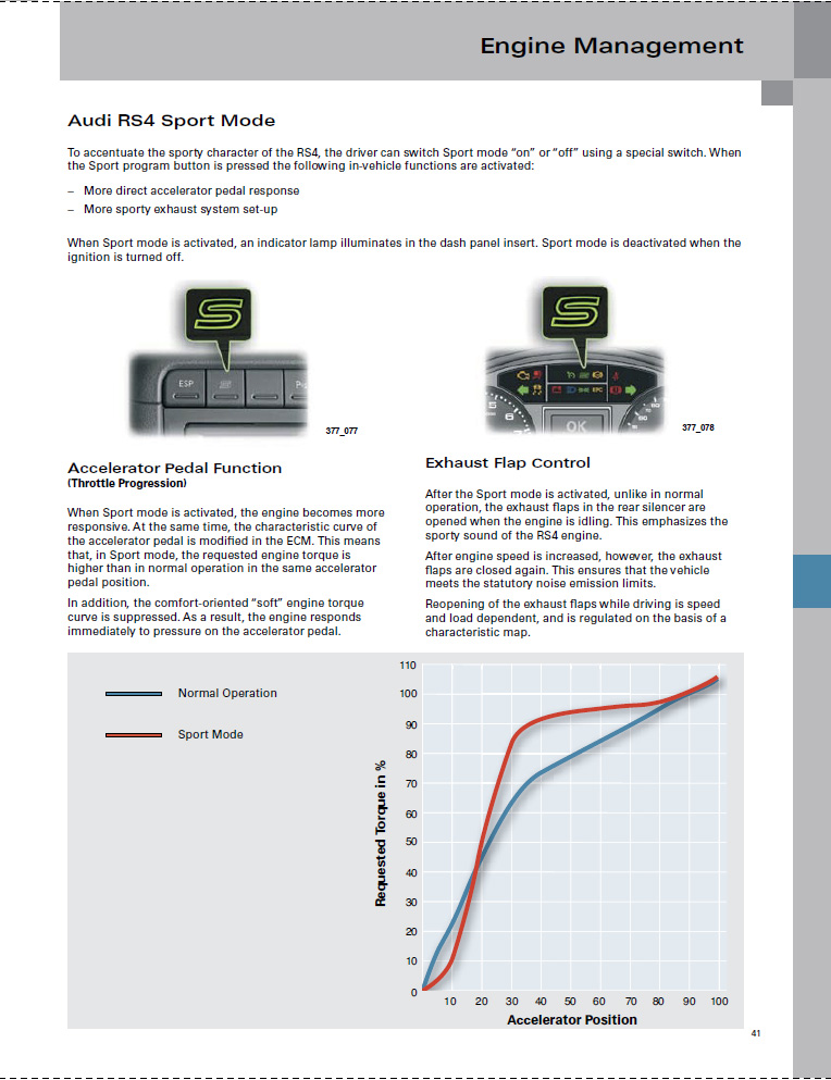

Is there anyone who has driven his car on a dyno and check difference when the sport button is activated or unactivated?
Would be interesting to see the difference on a dyno.

The sport button only changes the throttle pedal mapping, opens exhaust valves and inflates the bucket seat bolsters. It has zero effect on power.

Thanks for the answer, I thought that it affects the Power.

Unfortunately not, just changes the characteristic of the power delivery. You can see more in this extract below from the self-study guide which Audi published.
Click to enlarge:
Sport Mode

Thanks for the guide, explained what I should have known as a RS4 owner :bigwave:
