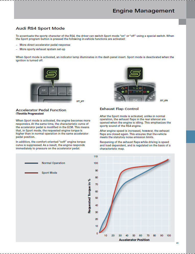

Is there anyone who has driven his car on a dyno and check difference when the sport button is activated or unactivated?
Would be interesting to see the difference on a dyno.

The sport button only changes the throttle pedal mapping, opens exhaust valves and inflates the bucket seat bolsters. It has zero effect on power.

Unfortunately not, just changes the characteristic of the power delivery. You can see more in this extract below from the self-study guide which Audi published.

Thanks for the guide, explained what I should have known as a RS4 owner :bigwave:
