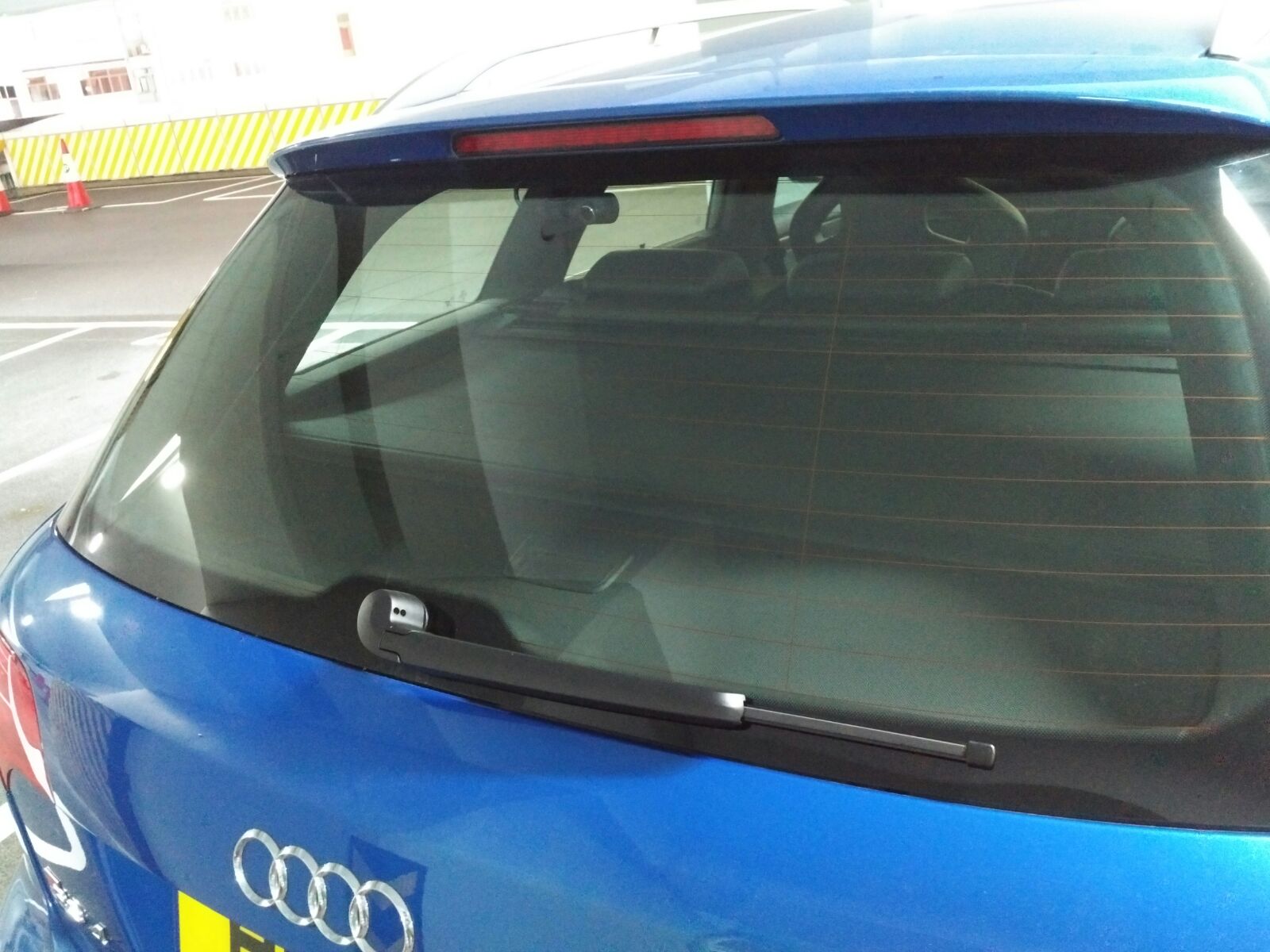

Ok I finally managed to have time to do this quick mod which takes a few minutes. I think the key is to get the pulley extractor, as many have suggestions on line to take the wiper out stress free and cleanly. I tried to just yank it out before for a good hour and it didn't move a bit. Went to the hardware store to get a 3-legged pulley extractor and it took me - 2 secs !!
The Q5 wiper I got plus the blade wipes cleanly with a good clearance from the top.
Here's the after:
With Q5 wiper
The wiping action is superb and clean and no more smudges in the middle of the blade to give clean rear vision !
