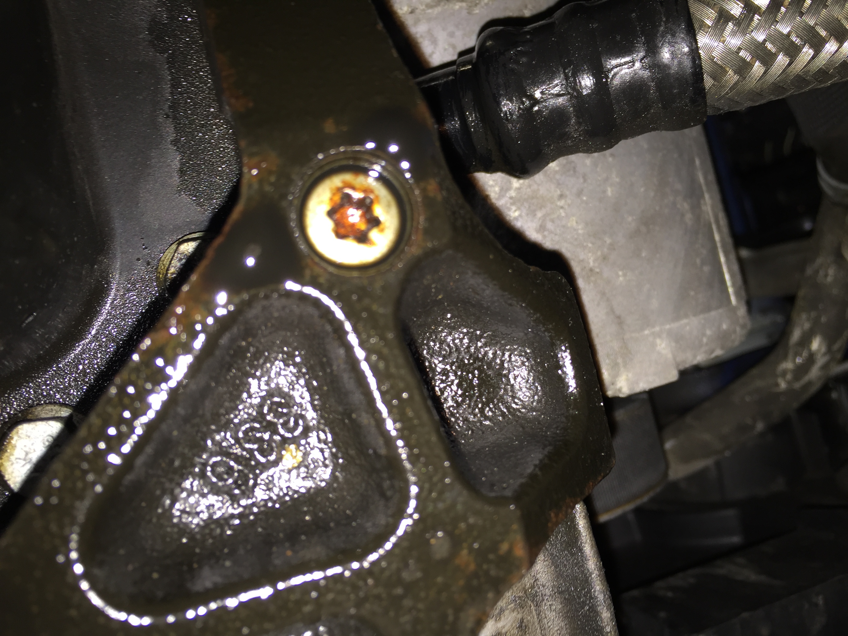

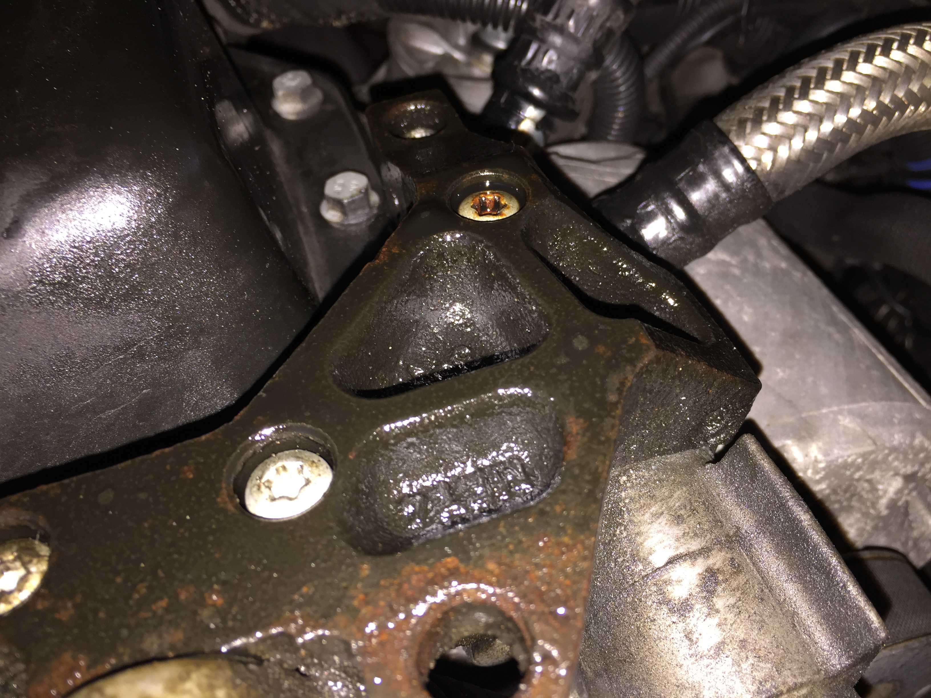

Guys
Cars developed a small oil leak from what I can see its dripping off the part where the oil cooler hoses attached to the block just under the belt tensioner. Took a couple pics. Has anyone experienced this before and what kind a job was it to repair.

The oil leak will most likely be coming from the oil cooler pipe on the engine block side. Each pipe has a rubber o ring which seals. If the o ring is faulty, then will need replacing. From memory, its circa £25 from Audi.

It is quite an easy procedure. All you need is an allen key on an extended ratchet. Once screw removed, pull the pipe off. Replace o-ring and do the reverse to get things back in place.
Before putting the new o-ring on make sure you oil it up, so it doesnt catch anywhere.

will the engine need to be drained before removing the pipe ?

I don't remember draining the oil when I changed the cooler on mine (which involved new pipes too so necessitated undoing the connector you're referring to).boombastik wrote:will the engine need to be drained before removing the pipe ?

got an update on this leak
ive noticed when using the car the leak stops, then when I leave the car for a few days it starts again, I can only presume due to the change in temperature, my garage is pretty cold during the winter if its minus outside then its the same in the garage.
orings are designed to hold pressure once energized so this will be once its running and up to temp it stops
any way I went to Audi last week and purchased the 2 orings £72 for the 2 I took them to my mate that's got an interest in a seal manufacturer for the oil & gas industry... they have sized measured and done all sorts of fancy tests on the orings and they have sourced the very same one from a manufacturer in Germany that produces these for the automotive industry
the minimum order he could take was 100 items........ so he ordered 100 for me with fedex hot shot shipping to the UK for a grand total of............................................drum roll please.......................................... £12
so I plan to visit audi today to return the two purchased for a refund as the parts guy said this wouldn't be an issue as its a stock item
any one wanting oil cooler pipe orings then please let me know id be happy to share these
