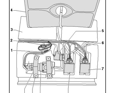

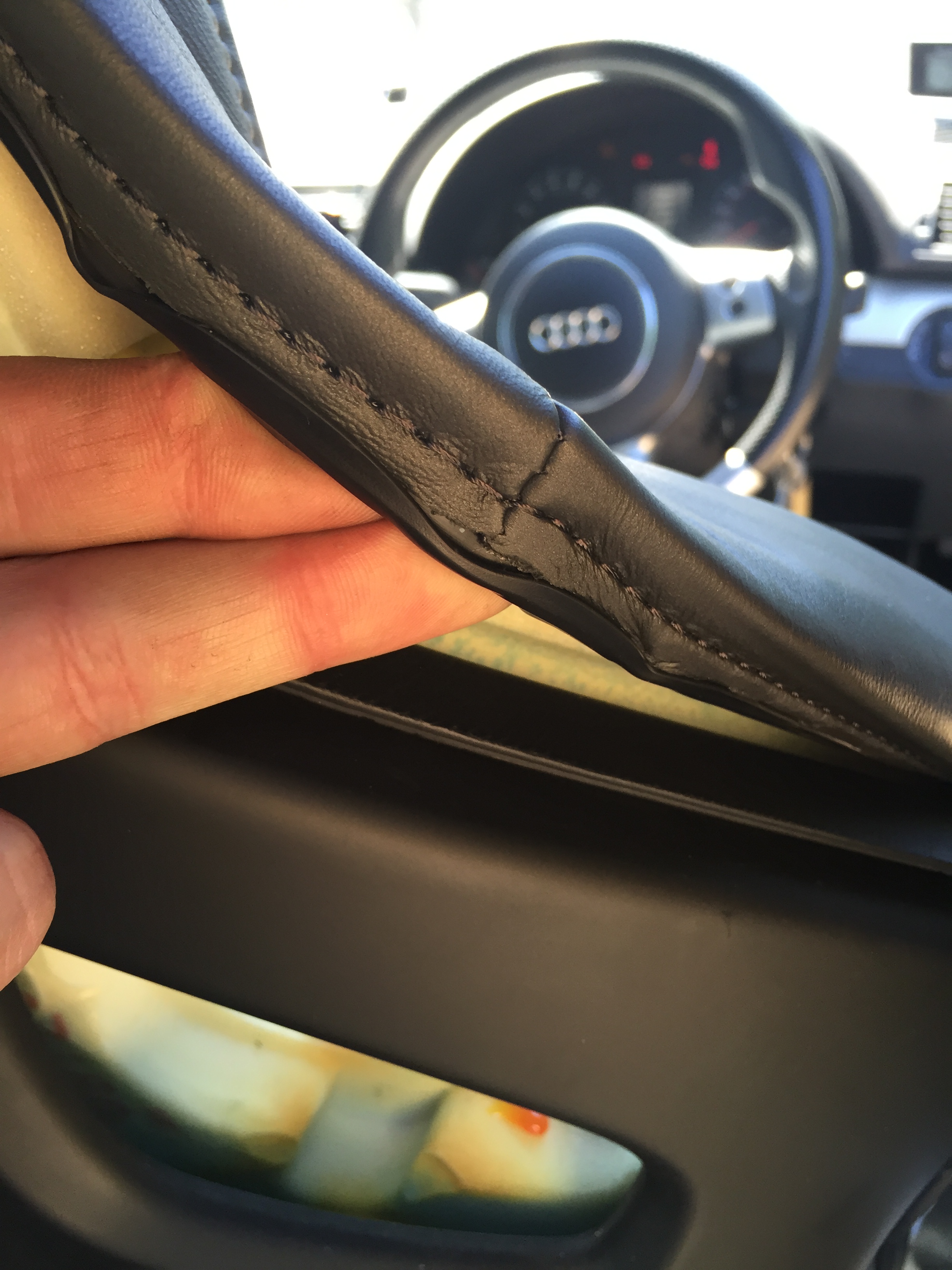

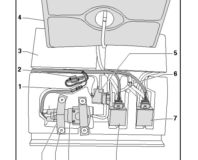

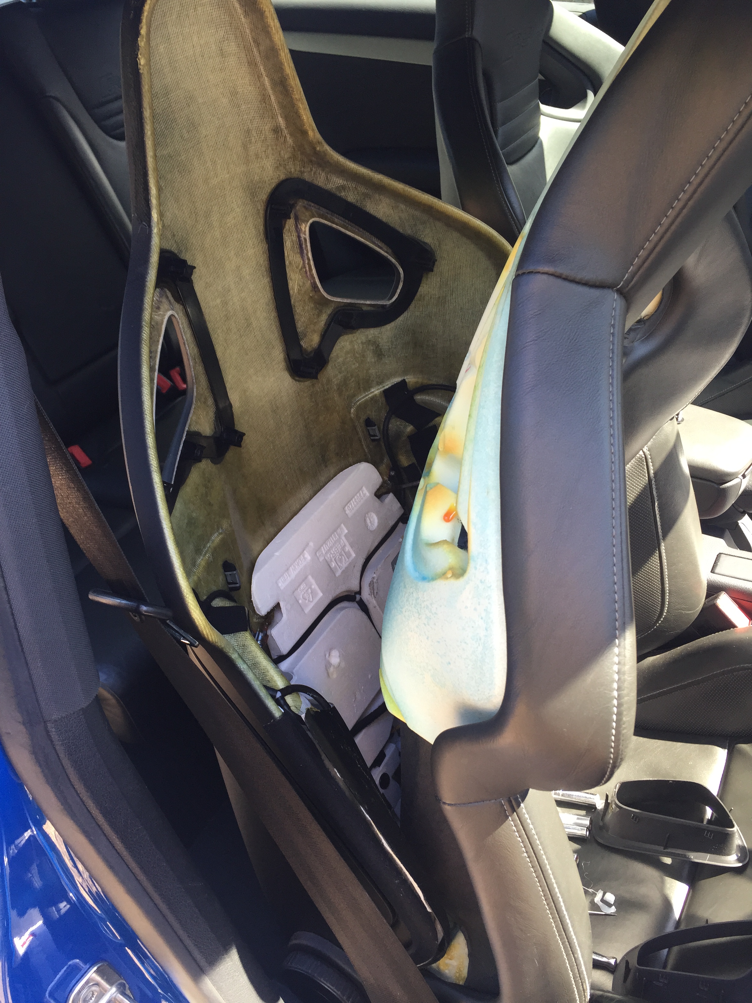

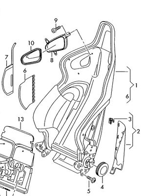

First remove the recaro seatbelt loops, item 10 in the image. They are retained by tabs on item 8. I did it from the back seat of the car, gently levering item 10 up and away from item 8. Its common to break the tabs on item 8 doing this, as Audi did when they replaced my valves some years ago!!

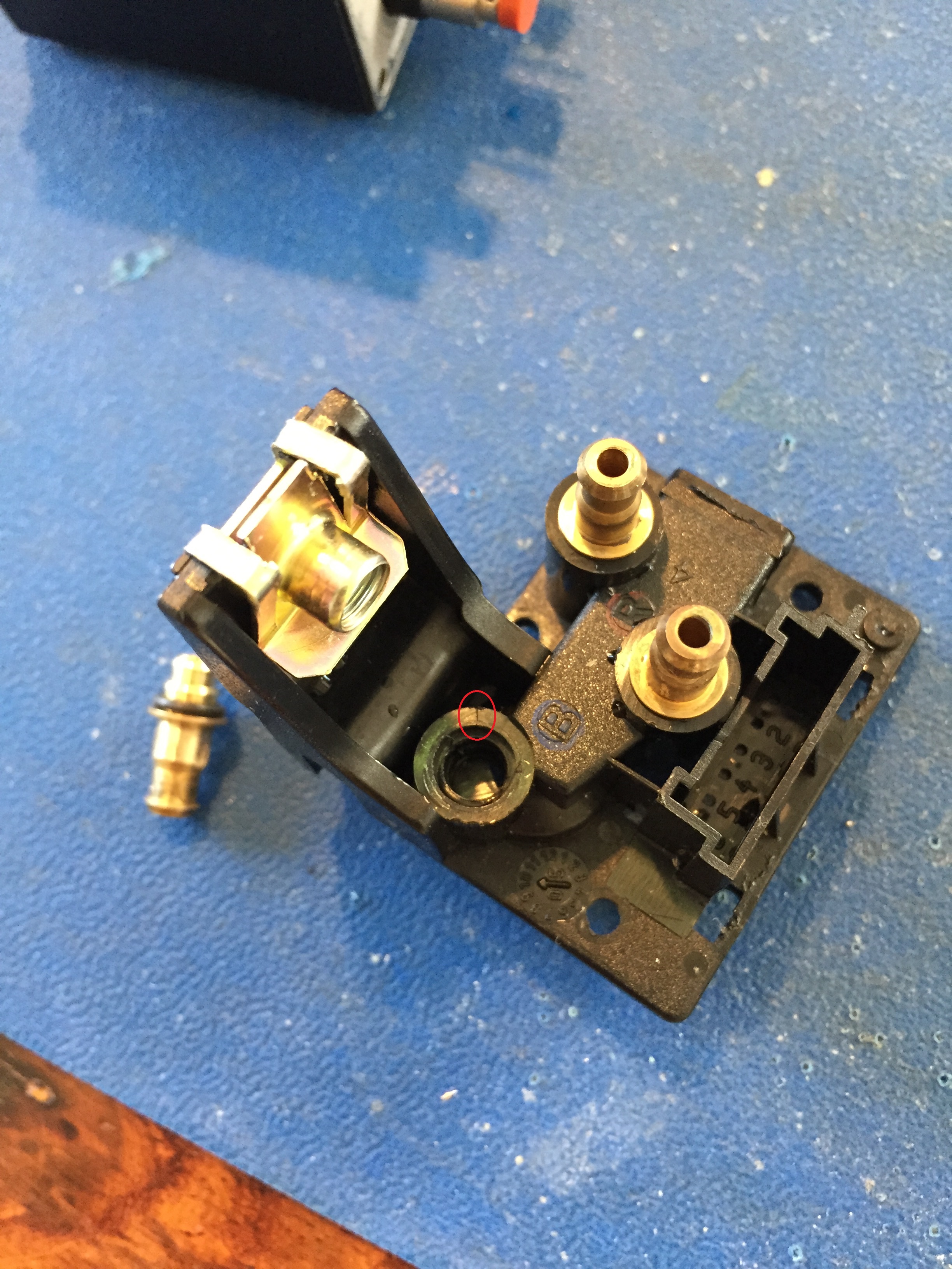

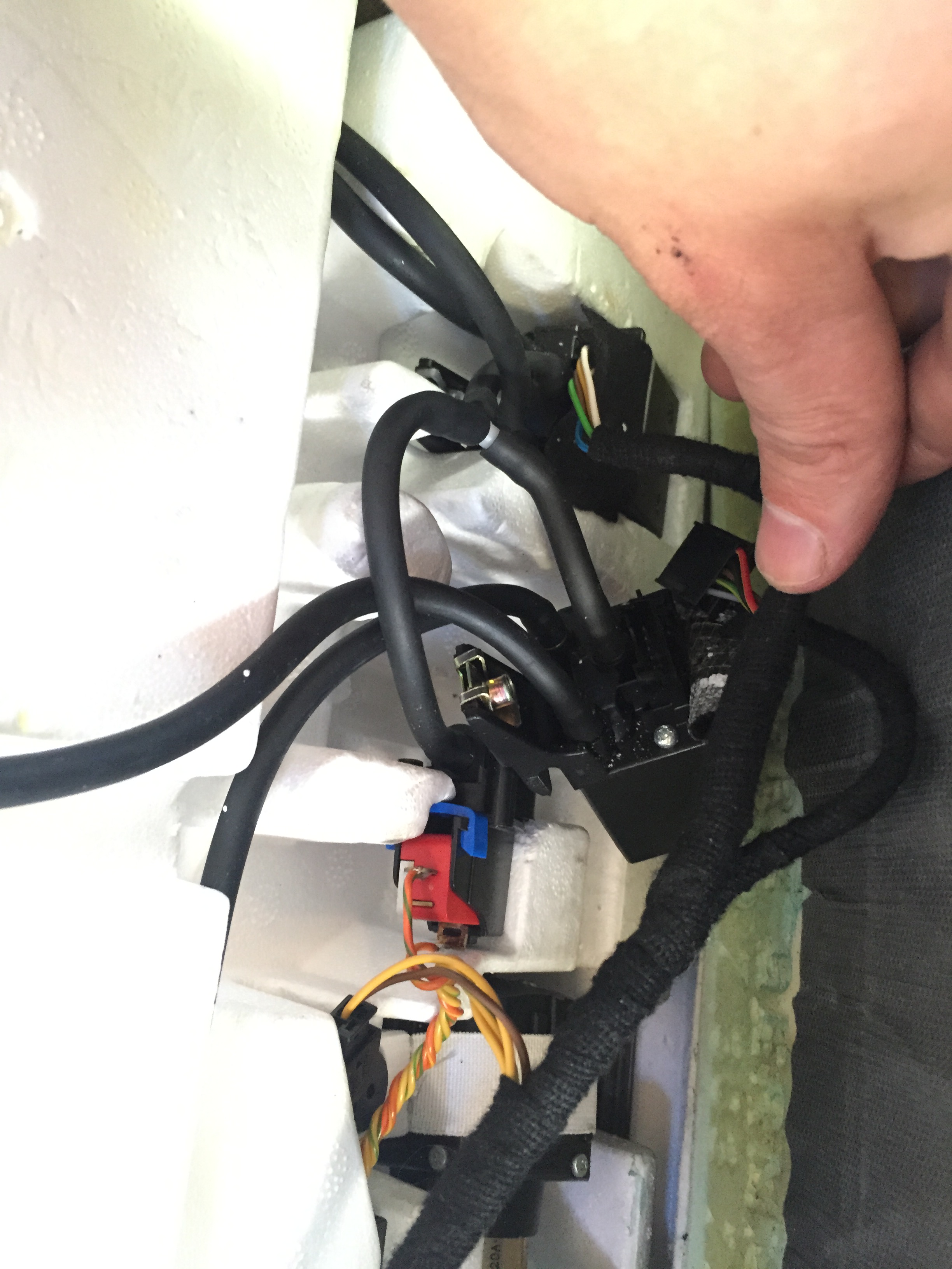

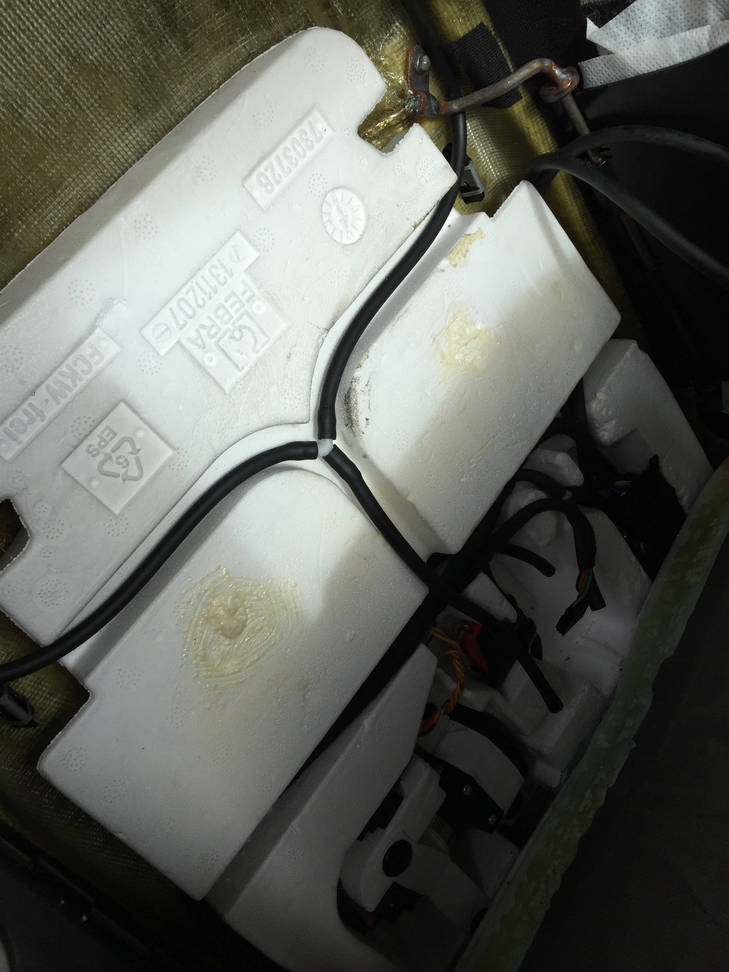

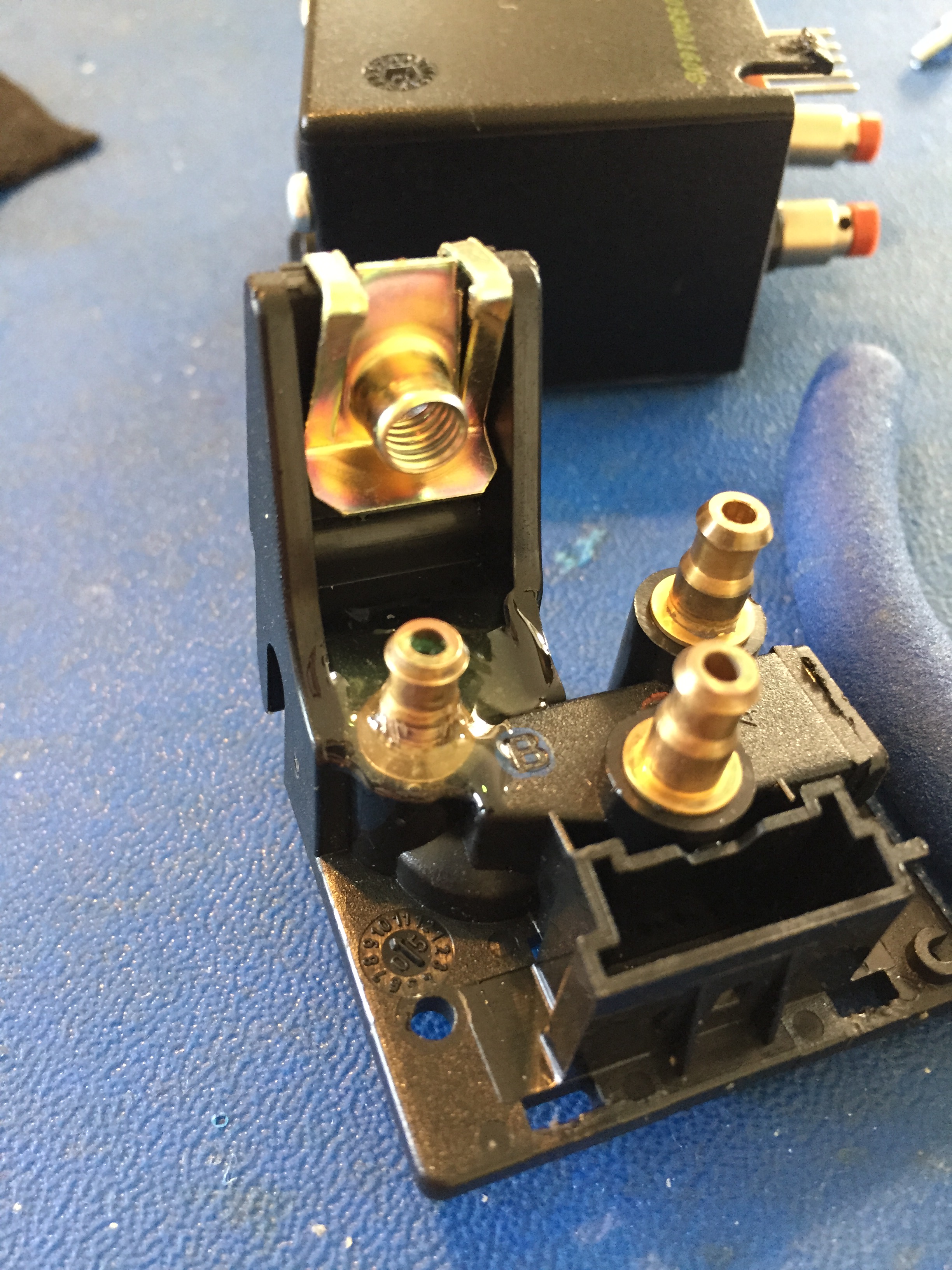

So i am purchasing new item 8's. Next, release the leather. It pulls out of the retaining grooved in the backrest as shown. Releasing the leather all the way around the backrest, the seat cover can pivot forward. (I left the leather attached at the base). The lumbar pad is removed in this image, exposing the valves. The left valve (Item 7) controls the side bolsters. The right valve (also item 7) controls the Lumbar. To remove the valve, disconnect the connector and carefully pull the hoses off, noting their locations for re-fitting! After hours of investigation and leak tracing, i found this crack. (Circled red). (Don't remove the brass insert, it is not necessary.)
The crack is most likely caused by the the brass insert being too large and splitting the plastic housing open over time.

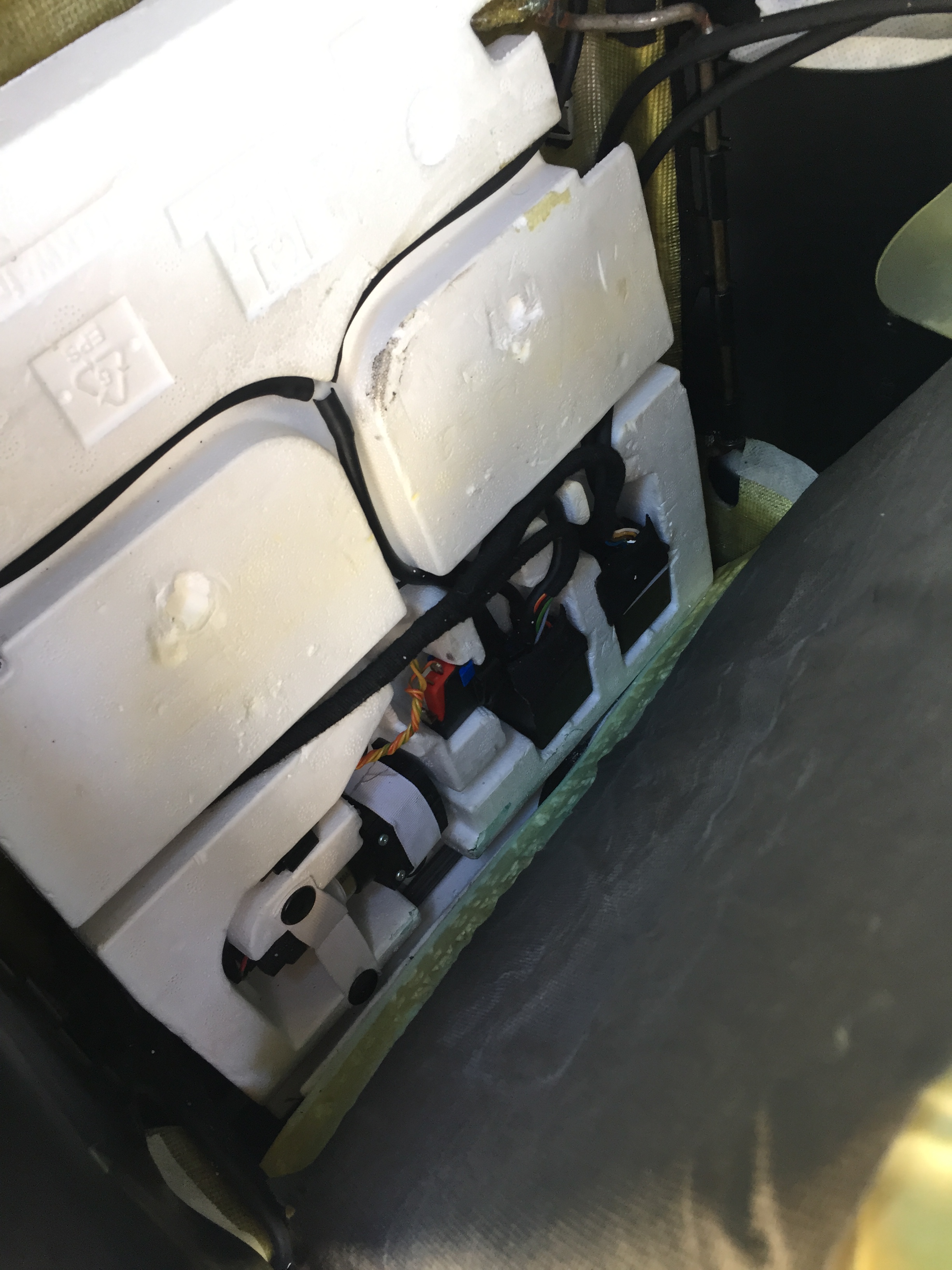

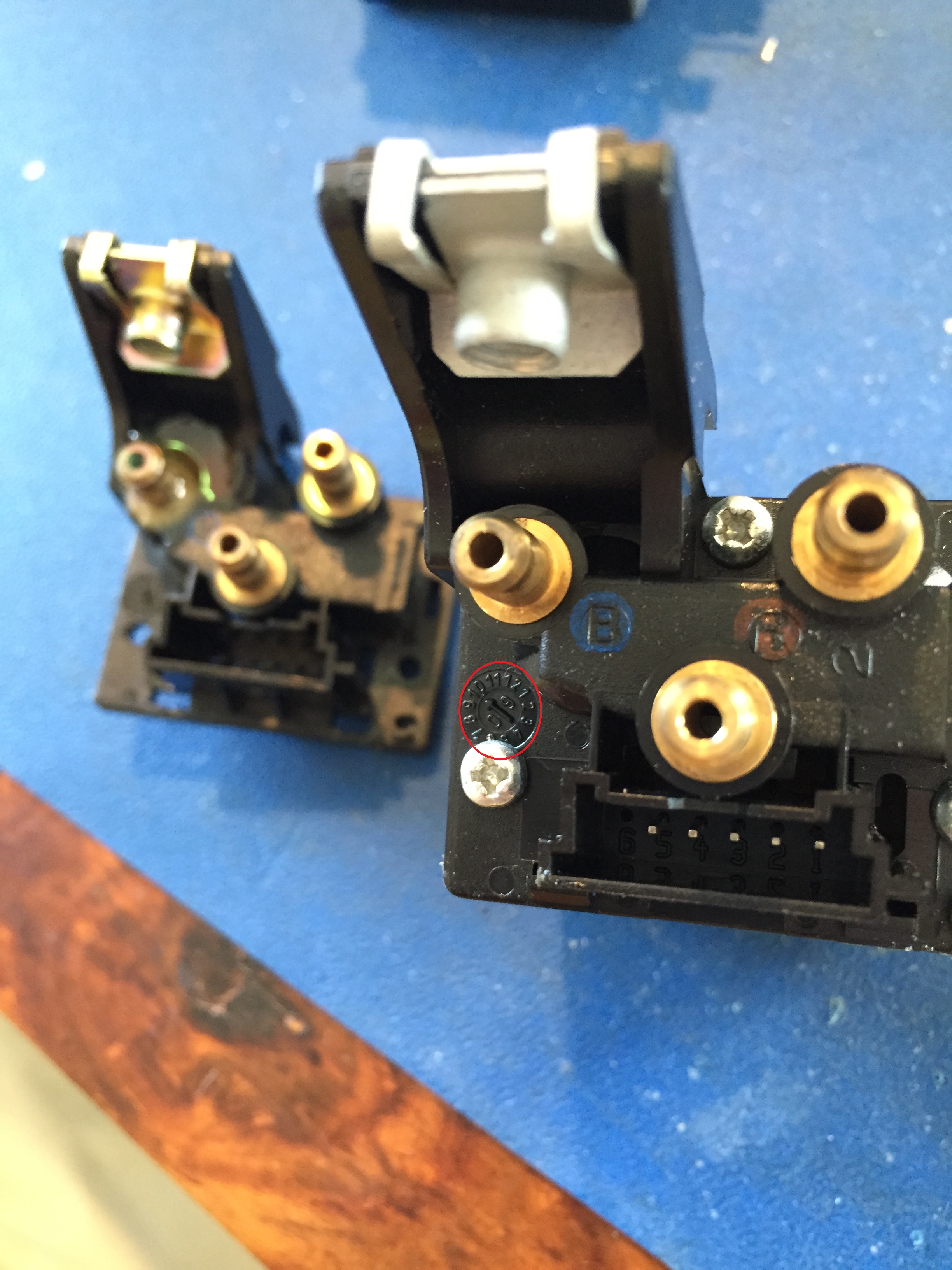

To fix, fill the cavity behind the crack and around the base of the brass insert with a 2-part Araldite or a similar hard setting glue. (in this pic i have the valve apart, this is not necessary) What i found interesting is that i had one leaking valve and one good. The leaking valve is stamped 2005 manufacture. The good valve is 2009. Maybe they improved it? When i re-assembled it, i noticed the lumbar pad plastic retaining screws that go into the white foam had worm the hole in the foam out, allowing the lumbar pad to slip down.
I re-filled the holes with expanding foam, should give it a few more years life. Hope this helps someone.

I also thought it was the rubber seat, the crack only showed up with leak detector.Surrey Sam wrote:Nice write up and investigation![]()
I did this a couple of weeks back, although I replaced the faulty solenoid with a new one - I've still got the old one in the bottom of the toolbox, so will have to pull it apart and check out the component failure. The last person to document in that sort of depth mentioned it was the rubber seal in their opinion, so will be interesting to find out (thread link below).
viewtopic.php?f=35&t=96867
For a skinny runt like myself who needs them at maximum inflation, it's nice to get them holding pressure again.
If it is the same on your old valve, you might have a working spare after some araldite
Let us know if it is...

Nice one, glad it's working for other people. Was the crack in the same position?

I didn't remove the brass couplers to find out i just sealed round them all

I could see the crack with the brass insert still fitted. Just have to look really closely.

lugars4, I can be a bit hamfisted at times. I think I'm worried about making a dog's dinner when removing the seatbelt loops. How difficult is it? What did you use to prise them off?

put 2 fingers in under the loop and push up then pull out

I used 2 thin plastic paint scrapers and put one in the top and one in the bottom and it popped off pretty easy.
