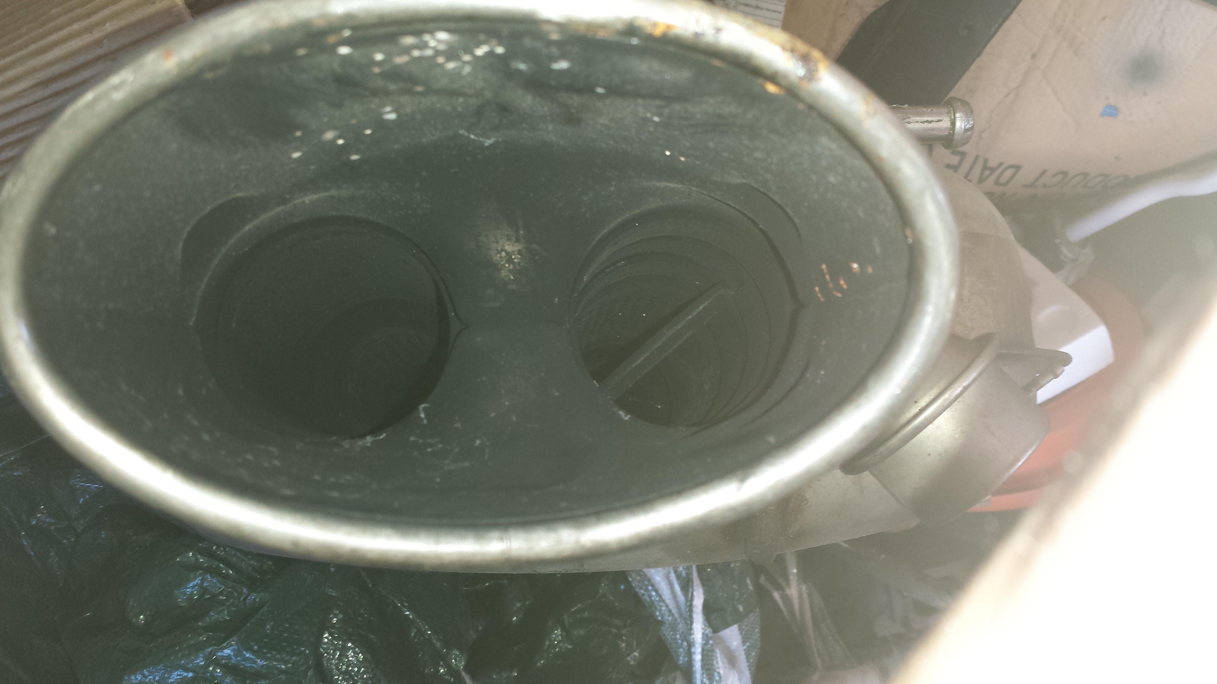

The exhaust valaves seem the same on mine even if the S button is pressed, could they be stuck? If so how can I free them ?

You just need to give the valves a good lubing and some gentle manipulating over time. Failing that and they are completely seized, the only answer is a Milltek :p

Valves - either they are stuck - if they don't move when pushed with the wooden end of a hammer say, they are seized. Soak with a good anti seize spray and give them a push. Can take weeks in some instances to work completely free with some persuasion. If they are moving, but not actuating, you may have a vacuum leak that will require VCDS and a particular vac check part of the power flap (in the air box if not removed) check. Search here for power flap check.

With the exhaust valves if I look under the car I can see the round valves but the moving part of the valves are they on top of the round circular thing I am looking at

Yes, that's it... they should actuate if all is well...rs4uk wrote:Thanks for the replies guys

I freed mine up by using a length of copper tube and an engineers adjustment tool, took about an hour a side being careful. Then once moving, keep them lubed as part as weekly cleaning

The valve without vacuum will be open, they open by the bottom half as its sat on the car swinging into the exhaust. Note the orientation of the flap isnt horizontal, it rotates at 20:10 for passenger side and 22:20 for drivers. So to move a seized item, gently tap 20:25 passengers and 22:35 driver side. Once moving you will need to lever the flap back and try again untill moving freely. Use plenty of penetrating oil. Might be easy to pop off the vac lines as they will be helping to hold um closed.

Hi guys
The RHS valve was open
The LHS valve was closed, I manged to get this open with wd40 and forcing the valve open (it won't shut though it's stick open)
But it still sounds the same?
Nowhere near as loud as this with valves open

What engine revs are you using and have you got Sport mode on?rs4uk wrote:But it still sounds the same?
IIRC in non-Sport mode the valves are open at idle but then shut and stay shut until approx 3000rpm when they open again, in Sport mode the valves are open at all rpm.

Carb cleaner is the best thing to use . then wd40 and wipe out all the build up . Done mine a few months ago and had no problems since
