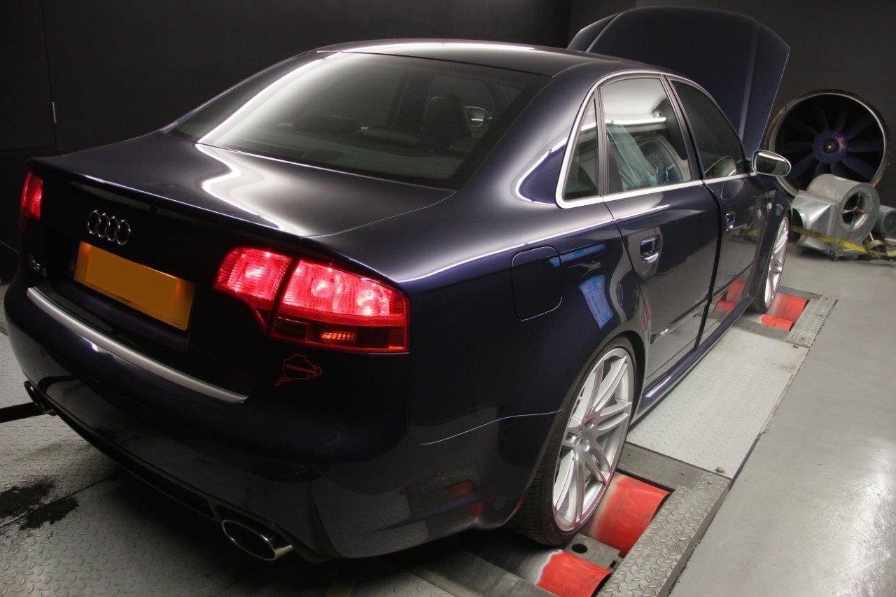

I had a Terraclean and MRC full carbon clean and porting and got 447PS after a Doug special remap, which took him most of the day.
The car was left as standard, i.e. no cold air feed and the inlet flaps left in place.

^ Another pic showing Mugello IS the best colour. 8)
