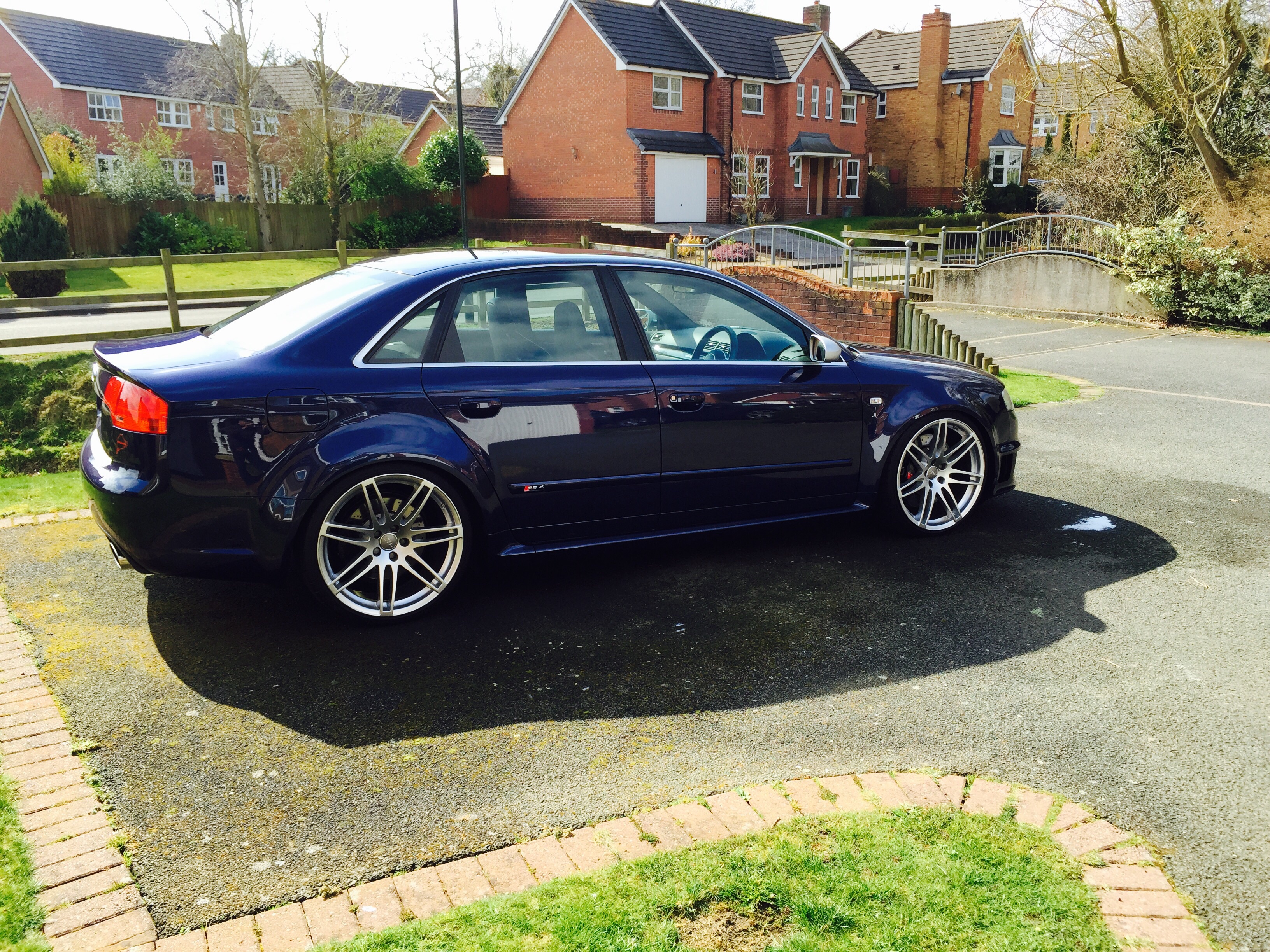

Re: 20" Wheels but keeping with Original Style
That's my last one with 20x9 ET25 and 255/30R20 GYEagleF1s, lowered on KW coil springs.
