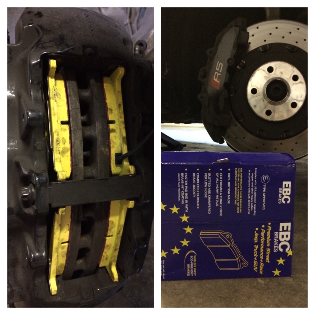

Post by hlbeckley » Sat May 09, 2015 8:58 am
Hi all, so changed my pads and 100miles into bedding in process but my hat they squeak!!!!! Anyone else had same issue or does this go away?
