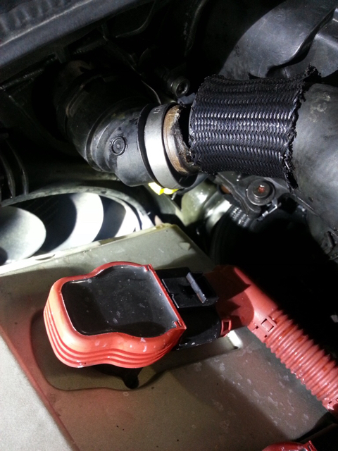

Jamiedal, I offer the following points based on recent expensive (US$4,300) experience in my wife's 2004 S4 Avant with 106k miles on the clock. She pulled a red coolant warning light with subsequent high temp readings.
Towed car to Audi, with the following findings:
Found top radiator hose blown apart.
Found the water pump, coolant overflow hose and secondary radiator to be leaking coolant
Found front crank seal to be leaking oil
Found oil pan to be leaking oil
Found oil filter housing and valley pan gasket to be leaking oil. (Note, we never had any oil leak show on the garage floor - it collected in the engine valley.)
Good luck with you coolant issue. At minimum, these are other places to look.
