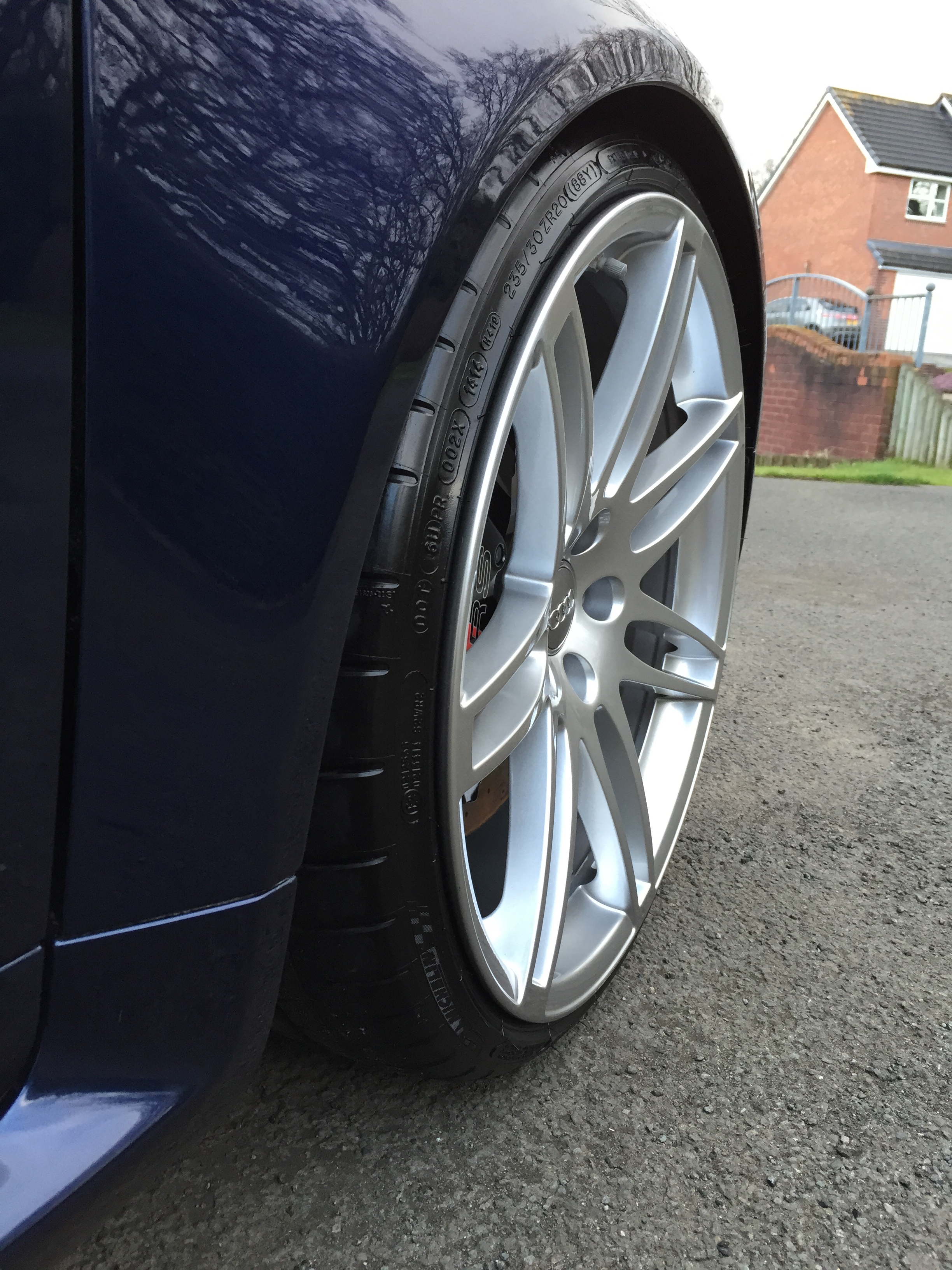

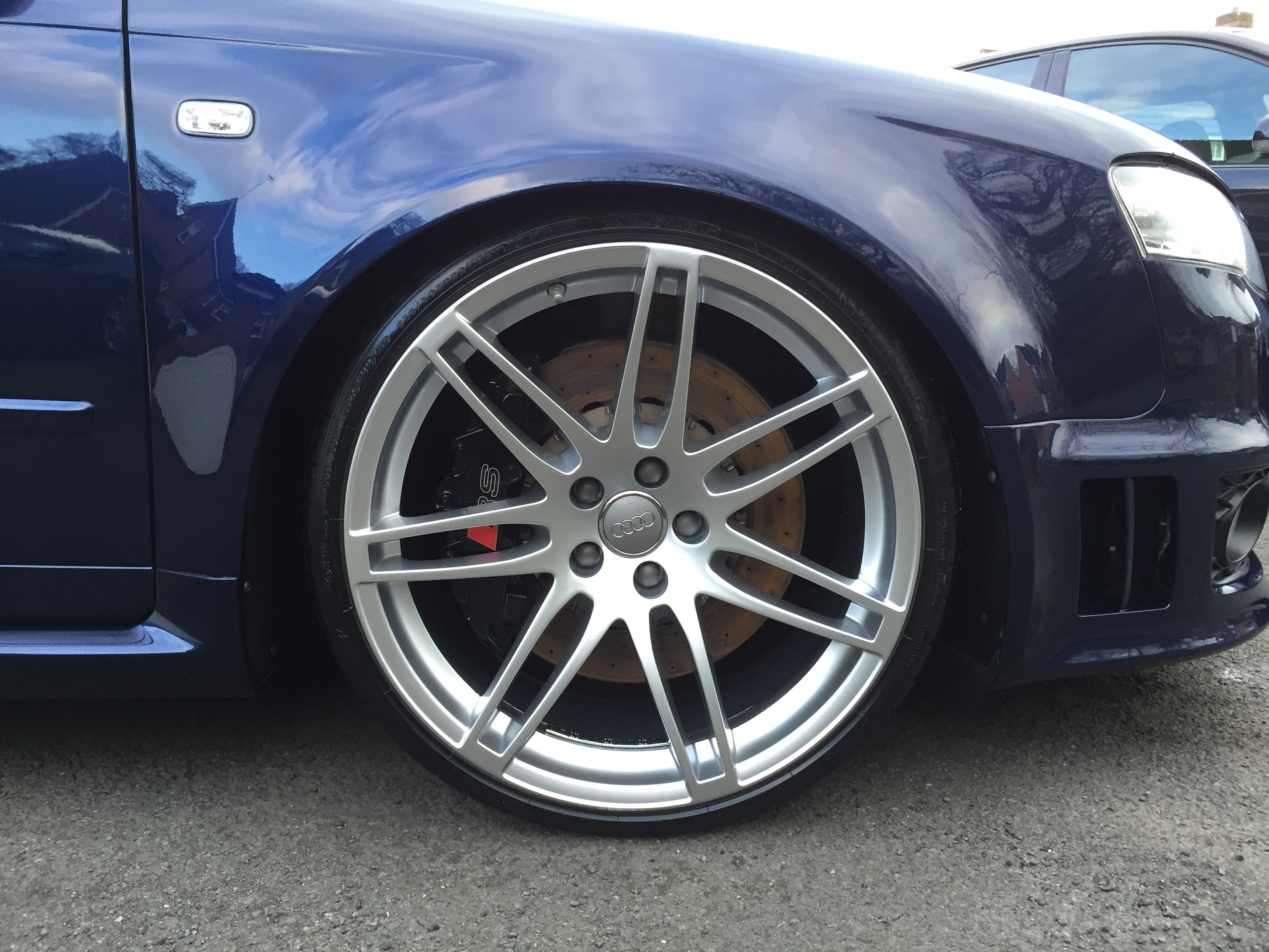

I now run S7 20" ET29 with 4mm spacers, 235 30 20 Michelin Pilot SS, lowered on KW V3 63cm front 64cm rear (ground to top of wheel arch) and adjustable top arms. Also had my wheel arches flattened at my mates body shop. I have no rubbing now.
This wasn't the case originally.
I used to run 5mm spacers, 255 30 20 Vreds, rolled arches, 64cm front 65cm rear with standard arms, I had rubbing and inner tyre wear. It did my head in. :drink:

Look at the stretch on those!
Looks like you sprayed the tyres on!
They make the RS4 style rims in 9.5 & 10 x 20, but with odd offsets.
So is ET29 with a 4mm spacer ET25 or ET33?

I'm trying to work t the perfect offset on 10x20s, with 255 tyres
I had the same wheels as Covkiller and had a lot of rubbing, I'd like to stick to 255 tyres hence my reason to go to 10j wide wheels

Nils you shouldn't have had any rubbing with 9x20 ET29 and 255 tyres unless you were really low. Mine are ET26 and don't really rub (or maybe even not at all).
Have you played with camber settings to avoid rubbing? You can dial in a bit of negative camber to give you that mm or 2 clearance without getting loads of tyre wear.
