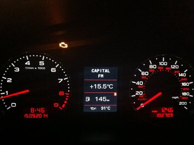

Ye mate my lights just come on tonight and it's bloody annoying here's a pic of the dam thing it's a nuisance ggrr!!Skid-136 wrote:Had the picture of the engine come up on the dash this morning,stopped the car and turned it off and back on but was still their.
According to the manual it's saying "emission control system" and to take the car to a qualified workshop as soon as possible in order to have the fault rectified.
Anyone have an idea what the actual problem will be?
Cat or lambda sensor maybe?
Car still drives the same just has the bloody light on the dash!
Is your light the same as mines on solid and doesn't flash!!

Odd that the MIL light is on without the EPS light.
Good news is that'll be a standard code - any garage or any reader (including 20 quid from Halfords) will be able to diagnose.
