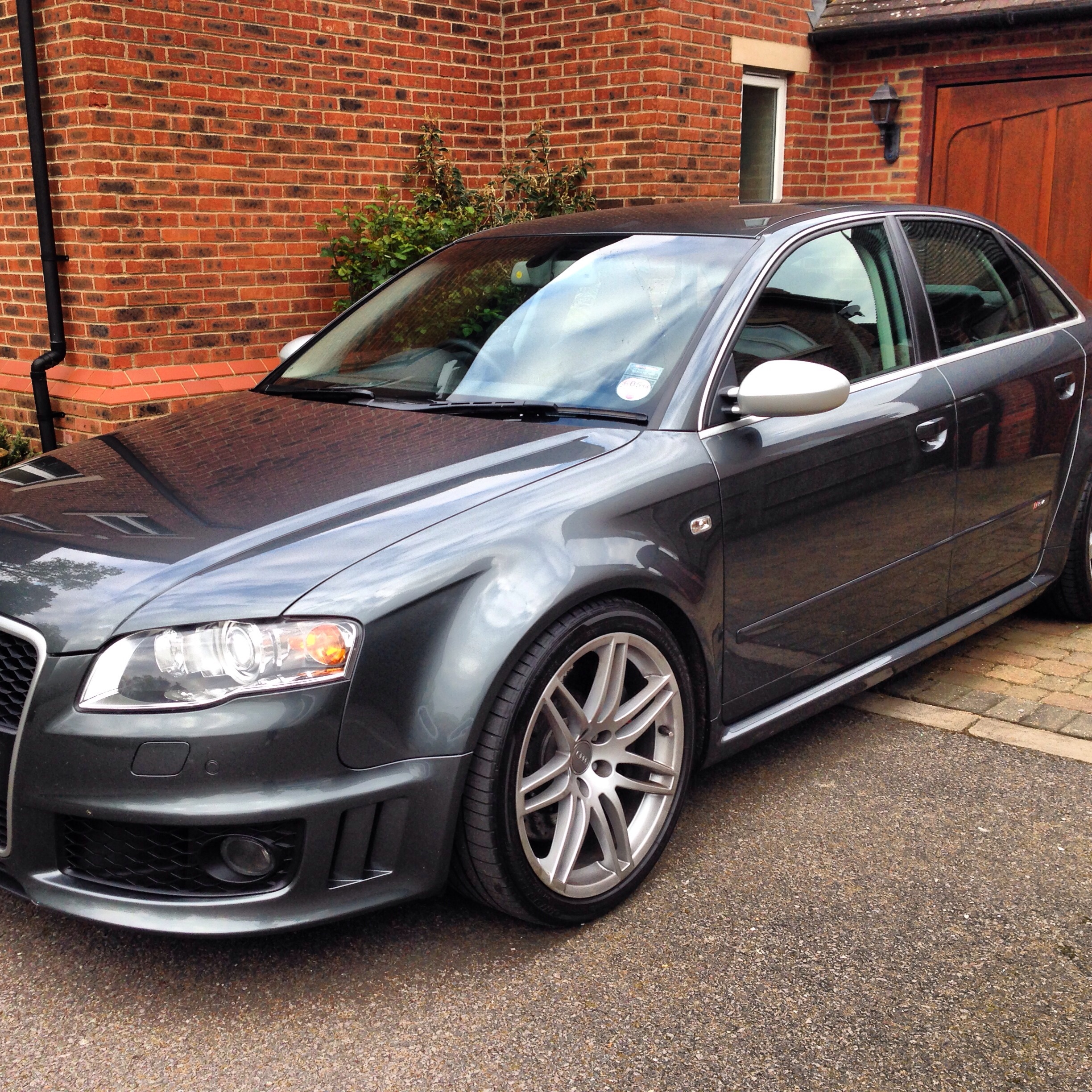

if your running a 255/35 you will be fine with a 10mm. You might need to remove the top screw in your fender liner as that is the most common area for rubbing. Here's a shot of my car lowered on Stasis/Ohlins and 10mm spacers front and rear. OEM 255/35/19 on stock wheels.

Edge - I've just done spacers and I've gone for 8mm all round - I have SS+ so, on the advice of Virdee (top bloke) went 8mm all round. No issues rubbing and looks spot onedge wrote:Everyone seems to go 8/10, there’s many pics out there for this.

I have A5 wheels at the moment 19"x9"et33 and use 11mm at front and 17mm at rear that corresponds with 7mm and 13mm. SS+ suspension and 225/40-19 PS2 tires..no rubbing!

Standard wheels running 255-35-19 cont have 10mm rear and 8mm with no issues

Ha ha there's only 3 posts with information about non 8/10 spacer people...bit like what what I noticed when searching for spacers.
Thank you guys, for the pics, thinking of heading off the beaten track and going 10/10.
So the only fear of 10mm fronts is possible rubbing on one screw or if you have a wider tyre or non OEM wheel.
