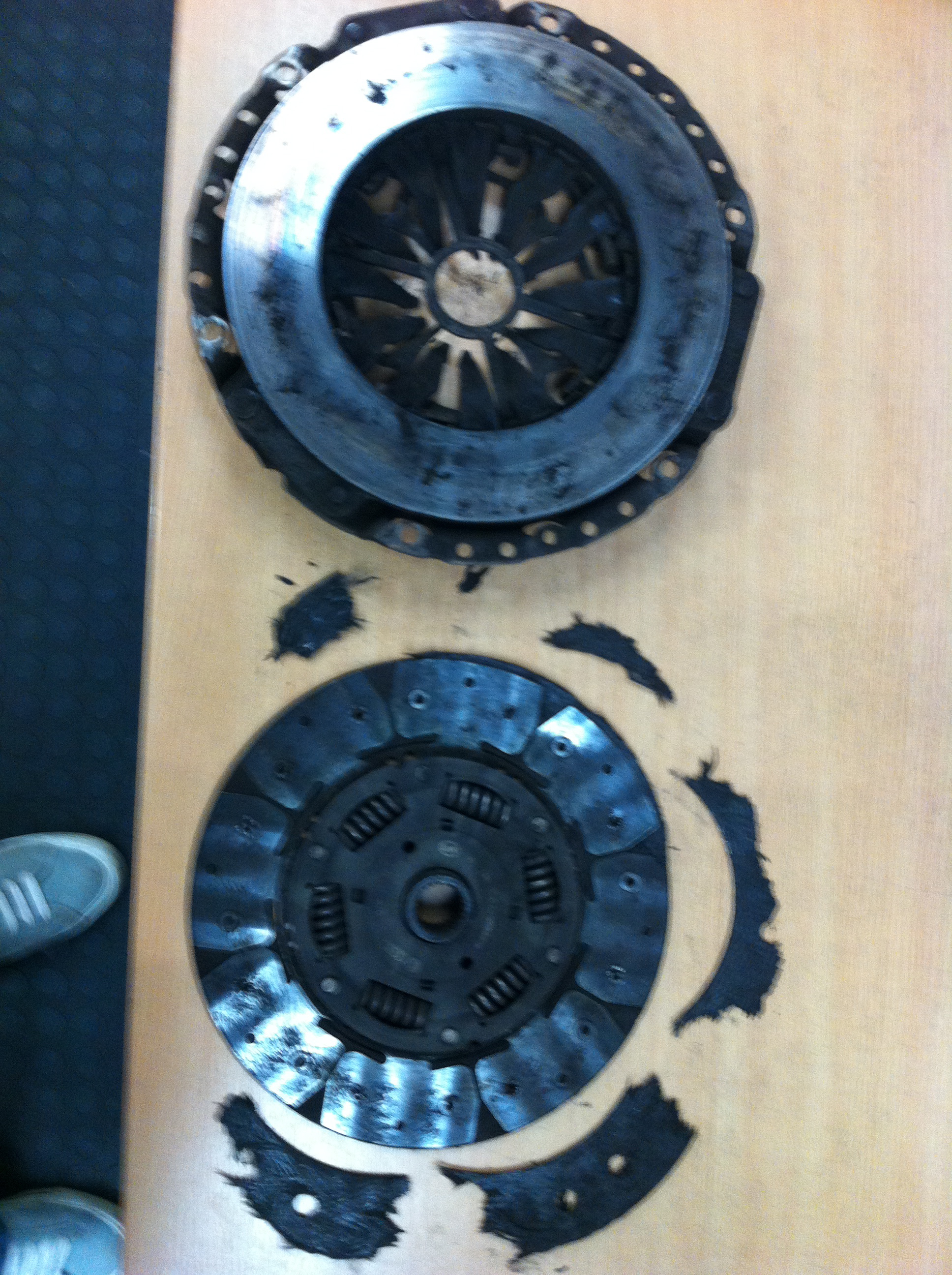

Just added a couple of pics!
Wha the <beep> t happened to the clutch? Looks like a fair bit of build up on the pressure plate too?! Too many launches? Lol
