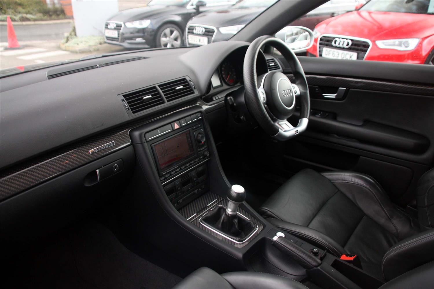

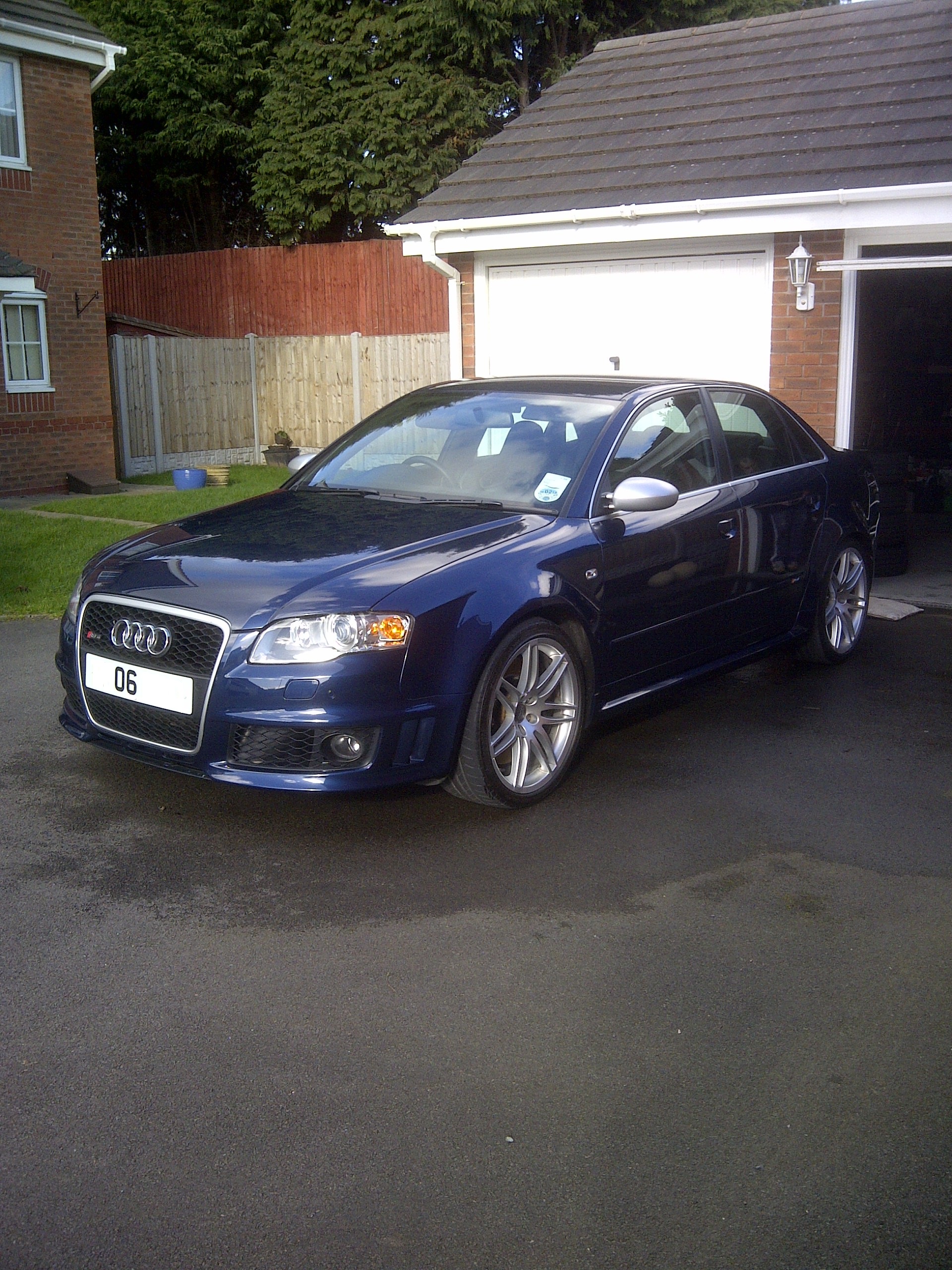

Thanks for the reply's. After reading that i think the best option for me would be to take it to a specialist like MRC and have a chat with them to see what i can do.
P.S The pictures attached are especially for you sync24
