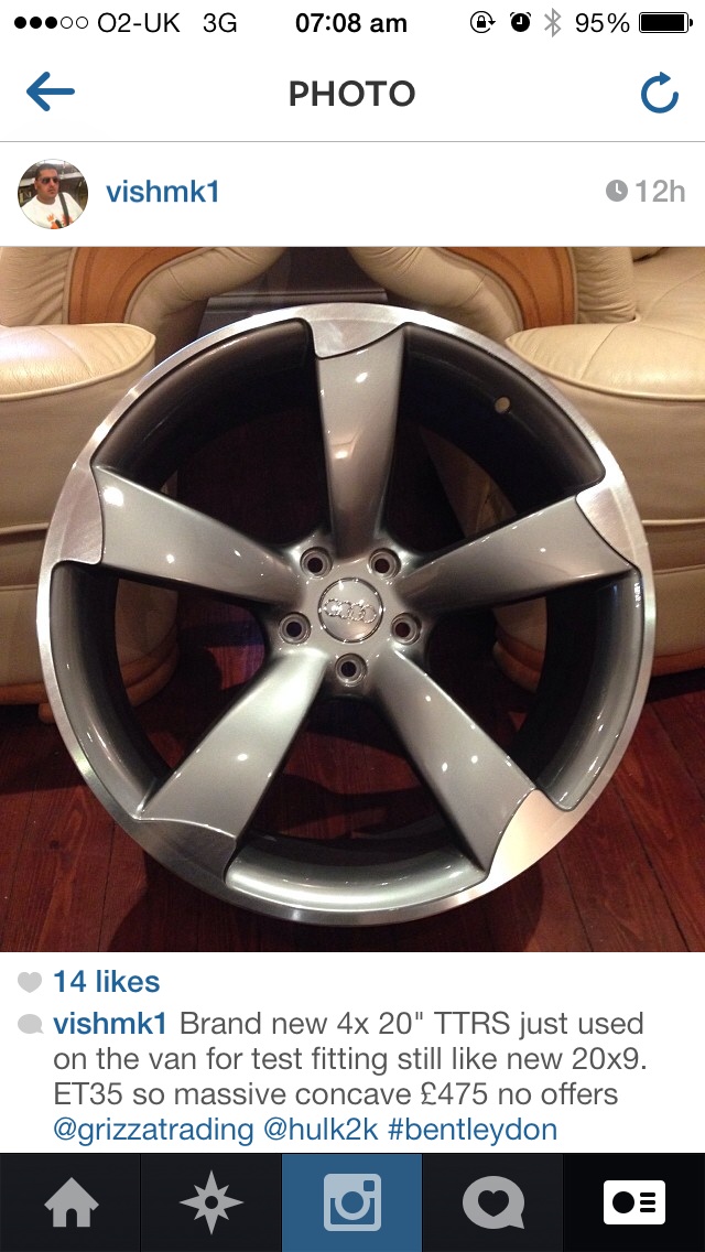

Re: Info on rotor alloys
These are the alloys and he's saying cos they are a et35 he's saying they're the same concave
THose are reps, i had them also but the mat paint in 9x20 ET35 and those dont have the massive concave as the OEM Rs5 ones..
plus you need around 18mm spacers to sit them flush
