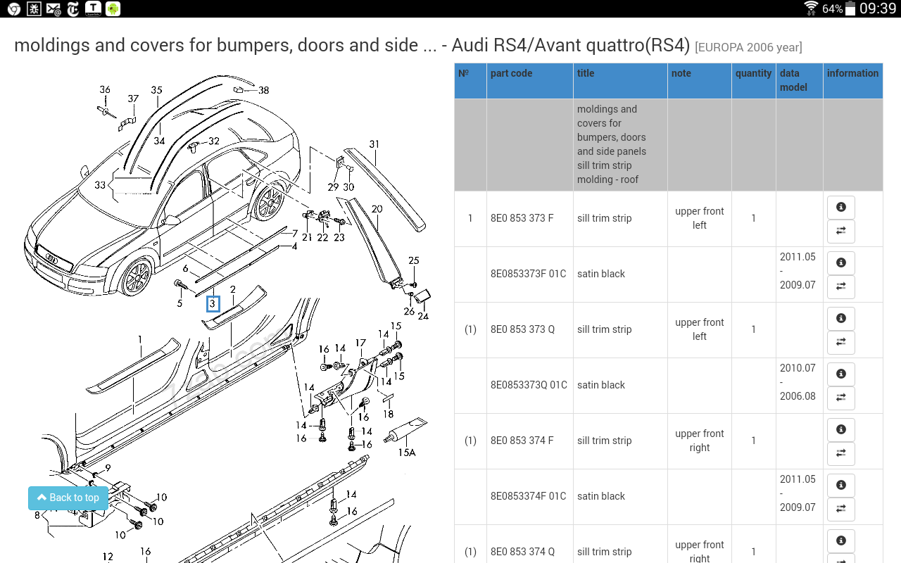

Hey everyone!
Can anyone give me the part # for the front passenger side door blade?
Re: B7 RS4 Door Blade Rust?
Posted: Sun Jul 30, 2017 9:48 am
by dhali
There you go .
Posted: Sun Jul 30, 2017 3:00 pm
by Paddski
New parts end of
Posted: Sun Jul 30, 2017 4:02 pm
by dhali
RS2s suffer from same problem . Best to buy full set now ( if your car is a keeper ) as they are reasonably priced .
