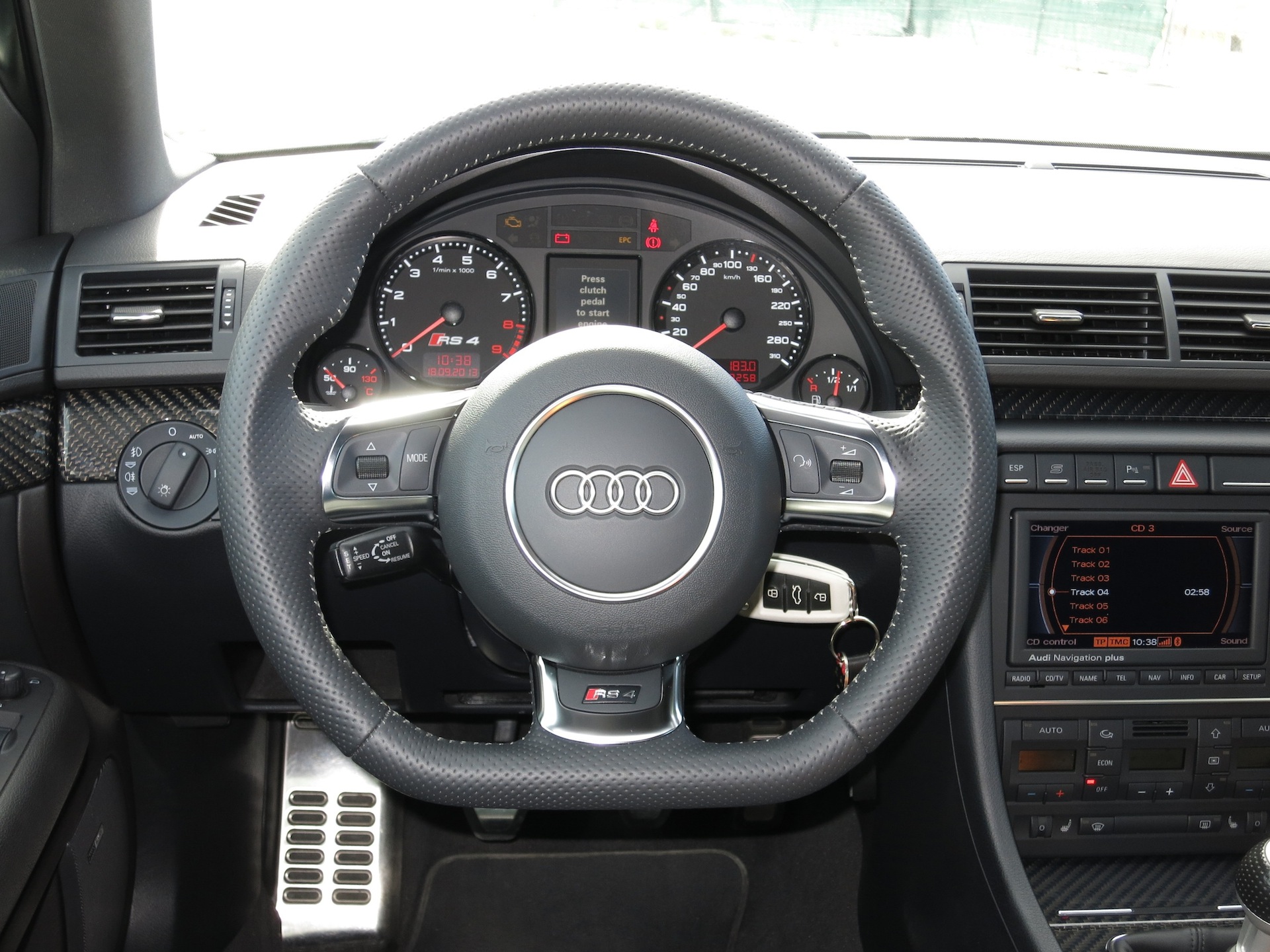

The TTRS wheel is the way to go if you have the MFSW (multifunction wheel). Its just about plug and play although there is a small modification necessary to the airbag wiring harness. I ran into this problem the first time I tried to install my TTRS wheel. I contacted HazzyDayz and Gareth supplied me with the modified harness. If I recall correctly, the difference was the airbag wiring connector shape and the newer airbags (round shape) use two ground connections instead of one.Cecilthesausage wrote:I think you can use the TTRS one.... I'm sure someone more knowledgable will be along to verify
The job itself is not difficult once you have the correct parts and the correct tools. It's a great mod although a little expensive. All wheel functions work as normal and the sport button stays where it is on the dashboard. Ask away if you have questions, it's all fresh in my memory - for now.

I've done this mod too - you can read about it here: http://forum.rs246.com/viewtopic.php?f=35&t=104008

Me 3, but mine's not perforated all the way round, just at the sides.
