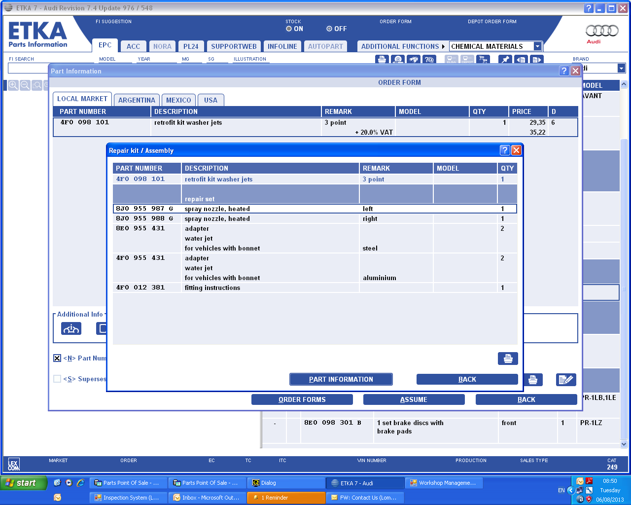

Just ordered the kit from Audi, its cheaper than I could find on ebay or other online places.
Heres what they sent me re parts list:
