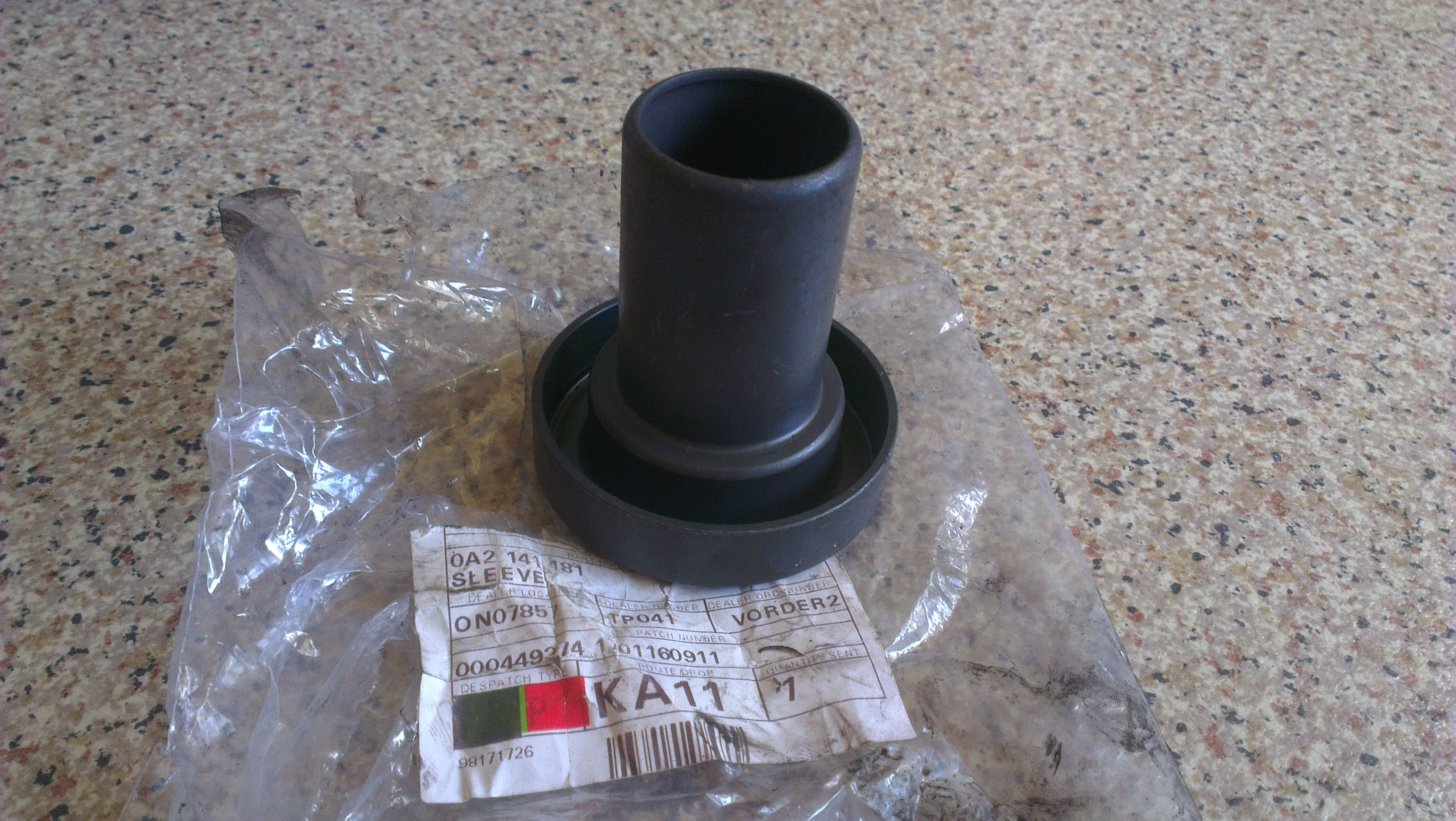

interesting http://www.schaeffler.com/remotemedien/ ... pkw_en.pdf
• Release-bearing guide tubes
Check the guide tube for correct fitment. Guide tubes should be centered and parallel to the transmission input shafts. Damaged or worn areas on guide tubes may prevent the release bearing from sliding freely This can lead to judder, clutch slip, heavy or difficult clutch operation. Damaged or worn guide tubes should always be replaced as part of a professional clutch replacement. LuK-AS has a range liste within our passenger car catalogue, identified against specific vehicle applications.
Note: Audi and VW models still found to be fitted with a plastic sleeve should have them replaced with the metal version LuK-AS No. 414 0002 10.
as I noted before, ours have plastic (or used to?)
plastic
metal
Re: sticky clutch weirdness

like many i have also suffered the sticky clutch syndrome, i too thought originally that it was the sleeve that arthur has pictured.
when i replaced my clutch i bought a new guide sleeve convinced that when it was stripped down the sleeve would show some wear,
however once stripped the sleeve was mint no signs of catching or binding so i didnt even fit the new one just loba pressure plate loba clutch plate and release bearing.
15000 miles later everything still ok, so maybe it is oem pressure plate.
the original sleeve in my car was metal as was the replacement pics below.

sar wrote:like many i have also suffered the sticky clutch syndrome, i too thought originally that it was the sleeve that arthur has pictured.
is that bolted to the housing like the flanged one?
is there a clip that holds it down?

ArthurPE wrote:is that bolted to the housing like the flanged one?
i never seen with my own eyes how it was attached arthur but i presume these picks from elsawin are accurate.
Posted: Tue Jul 16, 2013 8:01 pm
by ArthurPE
thanks, makes it perfectly clear
what is the texture/coating on the one you didn't use? was it the same as the one installed?
