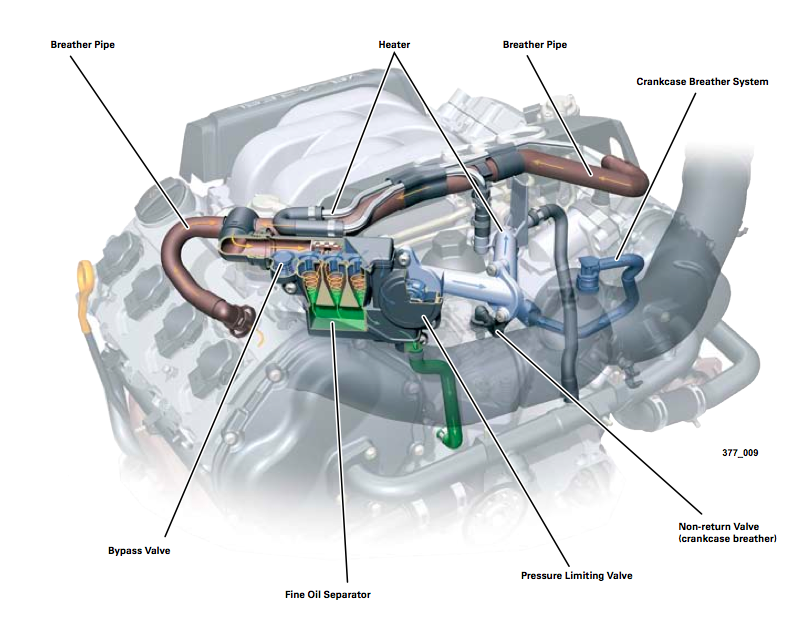

This picture is for the Q7 but same location, one would expect:

Tony, im guessing it's the 'non-return valve (crankcase breather)' bottom right in that image?

RS4-AL wrote:Thanks guys,
Is this an easy one to replace the PCV valve myself (as a fairly average car diy'er), or is something like this best left to the garage? Camberley Audi is my local.
I'm not too sure tbh, need to go have a look at mine to make sure that diagram is similar enough. I do know the PCV system has a breather pipe which connects to the intake just before the throttle body (mine cracked so i had to mend it) but it was difficult to follow the pipe to see where it came from.

The PCV is the unit that consist of the Bypass Valve, Fine Oil Separator and Pressure Limiting Valve in the diagram. It’s located under the Audi RS carbon fibre cover, behind the oil filter.
The PCV is sometime called The Oil Breather Valve or The Oil Separator Valve.
http://forum.rs246.com/viewtopic.php?f=35&t=96292
