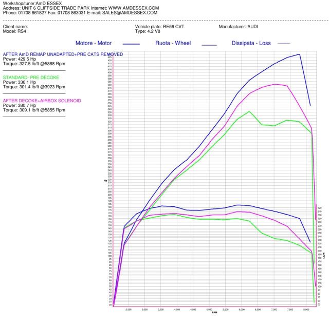

Re: Anyone have there decoke pre+post results?
Post by sutts » Wed Feb 27, 2013 11:20 am
Well worth doing IMO. AmD sorted out a vacuum problem with mine first (about 62,000 miles at the time) and did the de-coke. Gained over 40 bhp there, and more than the same again with the Milltek, pre-cats and remap. Car runs beautifully in all conditions now.
Post by spikeyboy101 » Wed Feb 27, 2013 2:25 pm
Had mine done at AMD back in August.
Paid £500 for the decoke.
Dont have the dyno graphs with me, but from memory i got 361 BHP on first dyno, after decoke and fixing an airbox vac leak dyno'ed at 431 BHP (with AMD remap, K&N Airfilter and Milltek Non Res Valved Cat back).
AMD also moved the airbox and manifold vac valves so they are eaiers to replace if they go wrong in the future.
Well worth the £500
Post by murph7355 » Wed Feb 27, 2013 2:43 pm
I guess the "problem" there is that more work was done than just a decoke. The vacuum fix in both cases could have been responsible for most/all the nominal gain. (Ignoring the other mods, which had a separate run).
I'm also always quite sceptical of charts when the operator of the road is the one who did the work. Am not suggesting AMD are shady *at all*. But a truly controlled test would not involve the person taking the exam marking their own work :)
The true test with any such mods is in the seat of the pants. A 100bhp increase would see a *huge* seat of pants difference (that sort of gain could make the difference between said pants being clean or not after a run :)).
