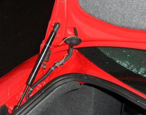

I have a fault come up on my DIS stating all the bulbs have gone on the boot (fogs, number plate) and my boot doesn't open!
This tells me that it's an electrical fault rather than bulbs, a broken wire maybe?
Anyone else experienced this and know an easy fix before I get my multimeter out and start pulling up carpets and trim :(

might be water in a connector. I'd be surprised if a cable had broken.

Exactly what it was!! Cheers though. :)
