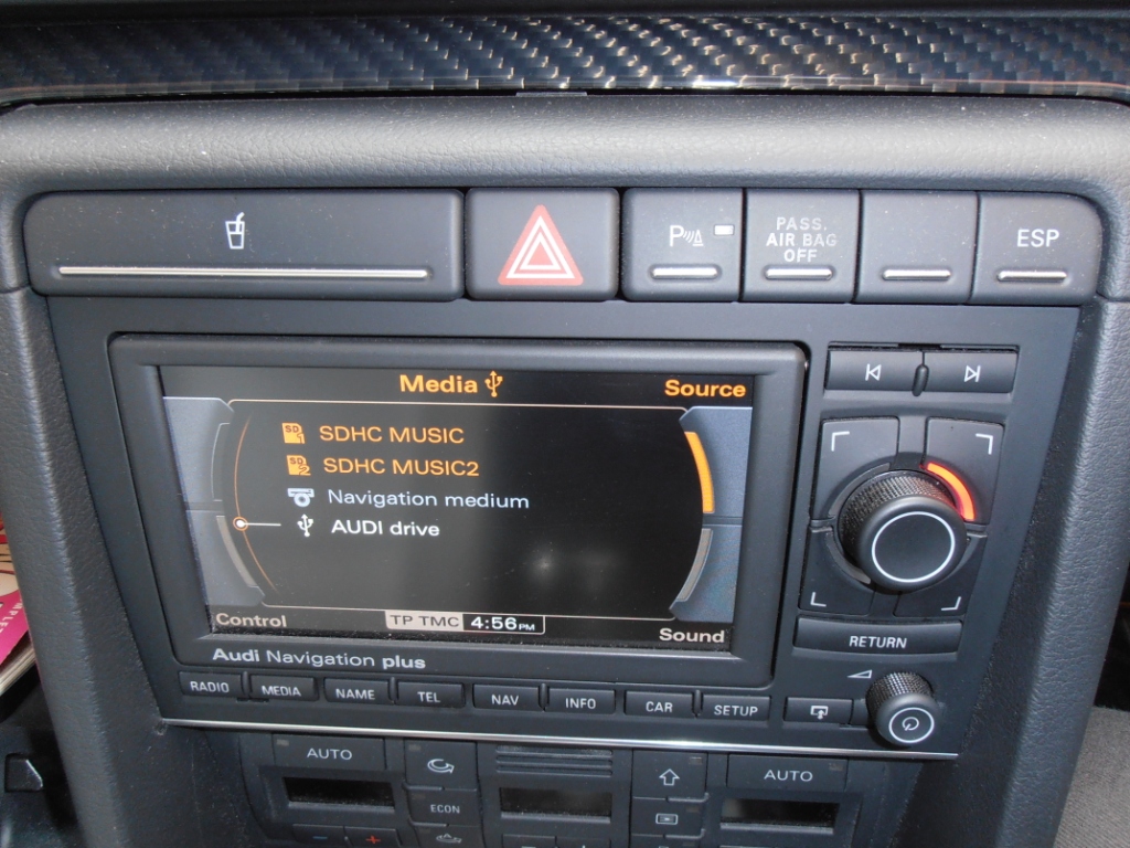

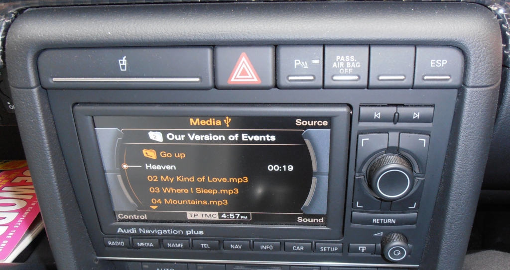

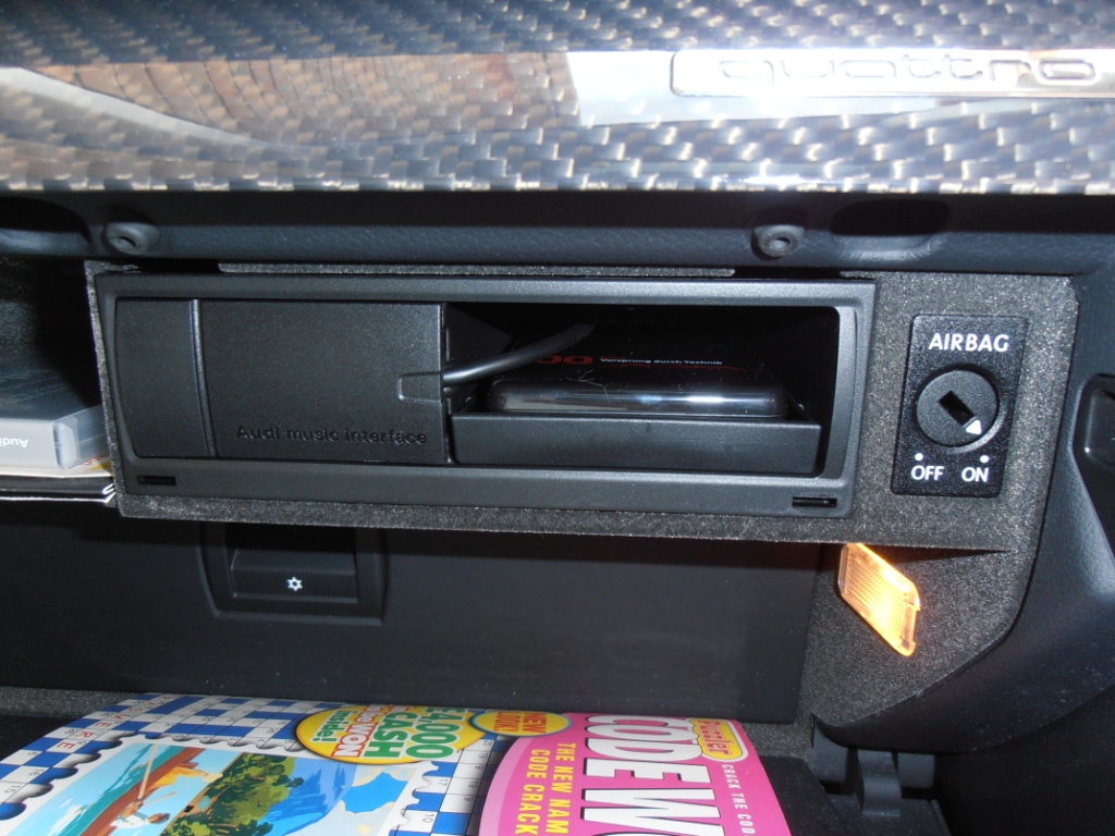

Well I finally got round to doing 2 things today:
1) checking the 64GB SDXC card - which didn't work, card wasn't recognised.
2) swapping the glovebox CD changer to the 8P0 057 785 AMI that I had bought over a year ago - which does work. I bought the 250GB Audi anniversary hard drive and cable, and have copied all my music onto it - and it's only about 1/3 full. Took me a couple of hours to do the swap (I had previously changed the audio connector to the 32-pin AV connector needed for the 2010+ RNS-E) and recode the RNS-E from 309753 to 309721 - no other recoding needed.
AMI unit in the glovebox, with hard drive in the drawer : Hard drive (in AMI unit) listed in Media menu: Album playing from hard drive:
