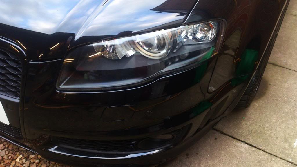

Rick can you please post some more pics of the headlights, I think that's a cool idea, very tempted to do mine :beerchug:

Post by Rick_RS4 » Sun Jun 02, 2013 10:01 pm

Cheers, looks great!! Have you seen this done before?
