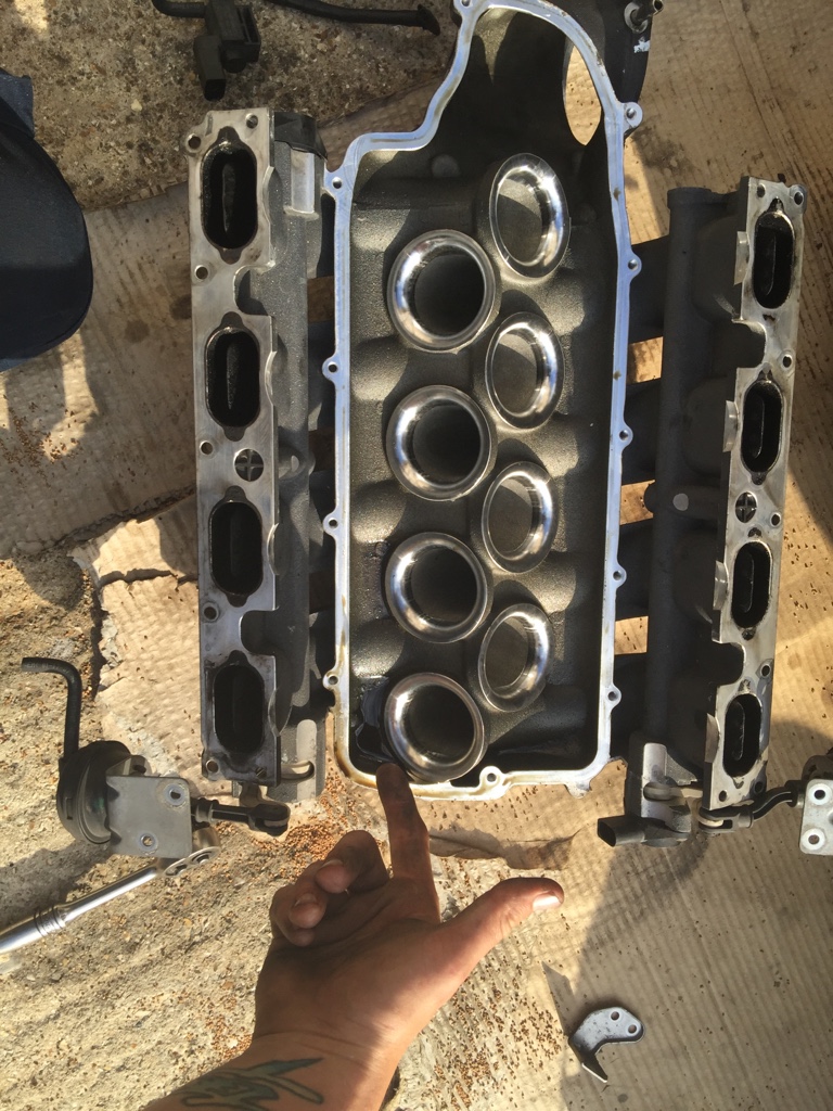

Right I'm 6/8 done !
Is the normal bit of oil here !! In the manifold Is it the oil / cooling system breather separator faulty ???
bazza138
Posts: 361
Joined: Mon Nov 11, 2013 7:00 pm
Re: Carbon clean with DIY walnut shell blaster
Post by bazza138 » Tue Jun 23, 2015 6:11 pm
bazza138 wrote:Right I'm 6/8 done !
Rick_RS4
Posts: 2882
Post by Rick_RS4 » Tue Jun 23, 2015 10:19 pm
common

Just back from hols. Yeah, the layer of oil in manifold is to be expected.

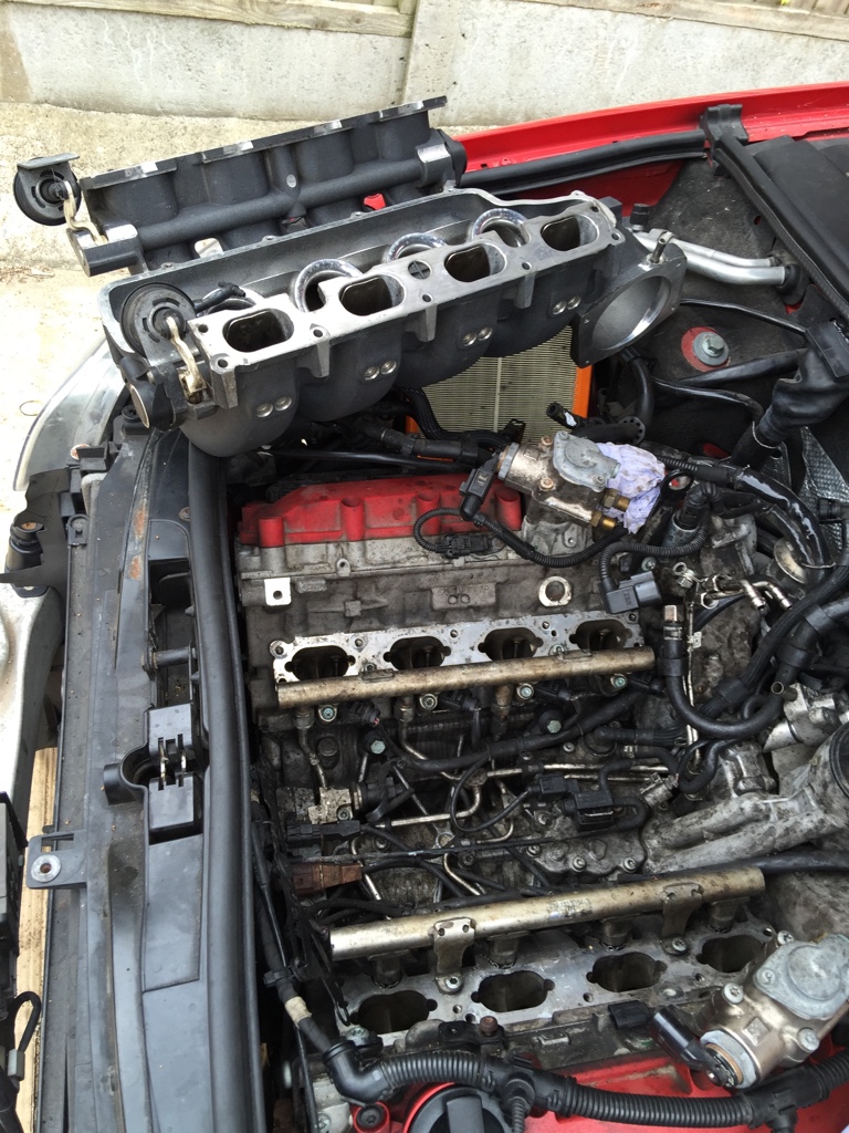

Post by bazza138 » Sat Jul 04, 2015 6:54 pm
Finally de coked done ! Spark plugs changed!
Now about to change oil hoses ! And oil & filter
Question
Esp light on dash !!
Dose this need to re set , or will this go out on when on 1st drive ?

docurley
Posts: 1215
Post by docurley » Sat Jul 04, 2015 8:48 pm
It should go out after a little while of driving.
Lukes3
Posts: 657
Post by Lukes3 » Sat Jul 04, 2015 10:11 pm
Or you have a vak leak on her. Look under the front carbon fiber cover where they join up you have put the pipe back on?

first time I did it i left of one of the manifold flap position sensors. That lit up my EML. I'd lay money on a vac line or an unplugged flap sensor. I've had the manifold off 4 times in total and only had the light on the once.
