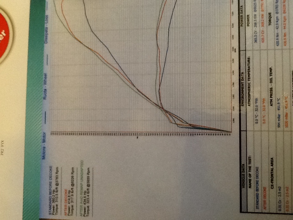

My car ran 399.4PS with a Revo remap pre decoke
I had a decoke and a revised Revo map on Wed17.04.2013 prior to an MRC dyno run on Fri 19.04.2013
Here ‘s my MRC Dyno results
Reading 3 – 425.9PS shows Revo’s map result post decoke
Reading 2 – 434.6PS Doug’s 1st attempt
Reading 1 – 439.5PS Doug’s best result
After Reading 3 Doug said that he could perform a safer map with even more performance. So I asked him to go ahead. Doug spent most of the day on my car, for which I am extremely grateful as the results speak for themselves.
Pre Decoke 399.4PS with Revo remap
Post Decoke 439.5PS with MRC remap
An amazing 40.1PS more
Thank you to Doug and the MRC boys.

Good result there - bet your well pleased.
Noticed much difference on the road from REVO?

Yes, smoother, pulls harder and a lot faster.

Why can't anyone just post a pre and post clean with exactly the same setup??? Loads of people want to see it, but we keep seeing posts with other mods at the same time......

Hi GlenRS If you're referring to my last post please can you point out where you see the additional mods and setup between my pre and post decoke breakdown.

Hi Covkiller,Covkiller wrote:Hi GlenRS If you're referring to my last post please can you point out where you see the additional mods and setup between my pre and post decoke breakdown.
Cheers Covkiller
Wasn't aimed specifically at your post, as there has been several calls for people to post up a direct comparison yet we appear to all still be waiting to see one. Even Spikeys post above is after a vac leak has been fixed and so im left wondering just how much difference if any the decoke made
But yes your post also falls into this, so i'll use it for example:
As you can see this is not comparable as it uses a different map, and I assume a different dyno?Covkiller wrote: Pre Decoke 399.4PS with Revo remap

Hi GlenRS
Same MRC dyno used for all runs.
Please see Reading 3 for the pre and post results ie:
Pre Decoke 399.4PS with Revo Remap
Cheers Covkiller
