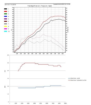

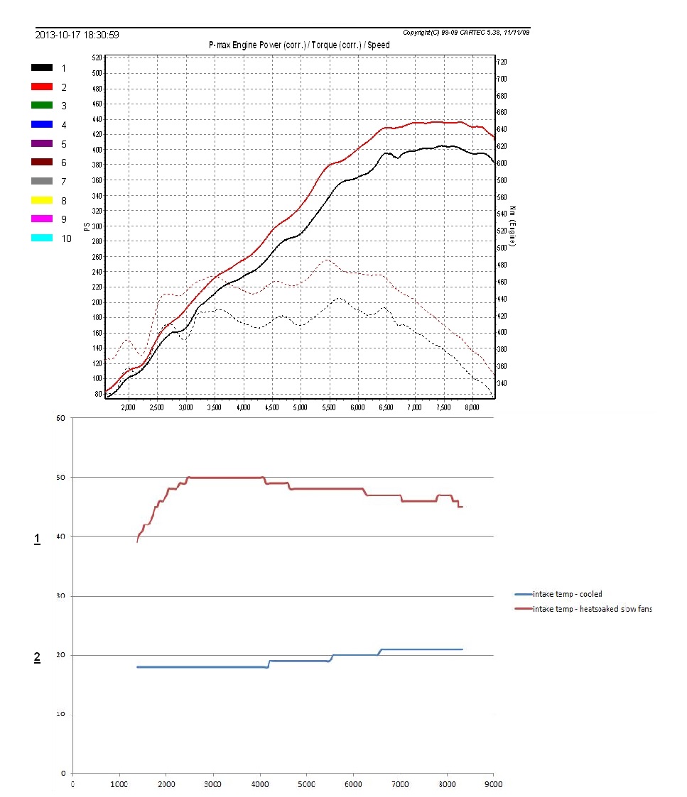

Same car, dyno results and logs of intake temps - cooled with axial fans and high pressure centrifugal fans, then left and cooled with one axial fan on slow speed
power drop is proportional to intake temps
