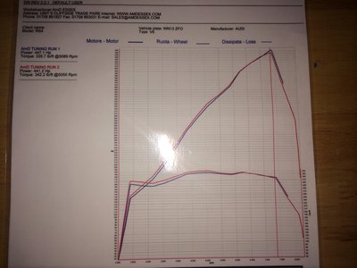

Hi matelengster1 wrote:Anyone got graphs? be nice to compare the b8 delivery against a decent power b7.see how good my arse cheek Dyno is at the feeling of a severe lack of torque in the b8.
Hopefully this is legible
