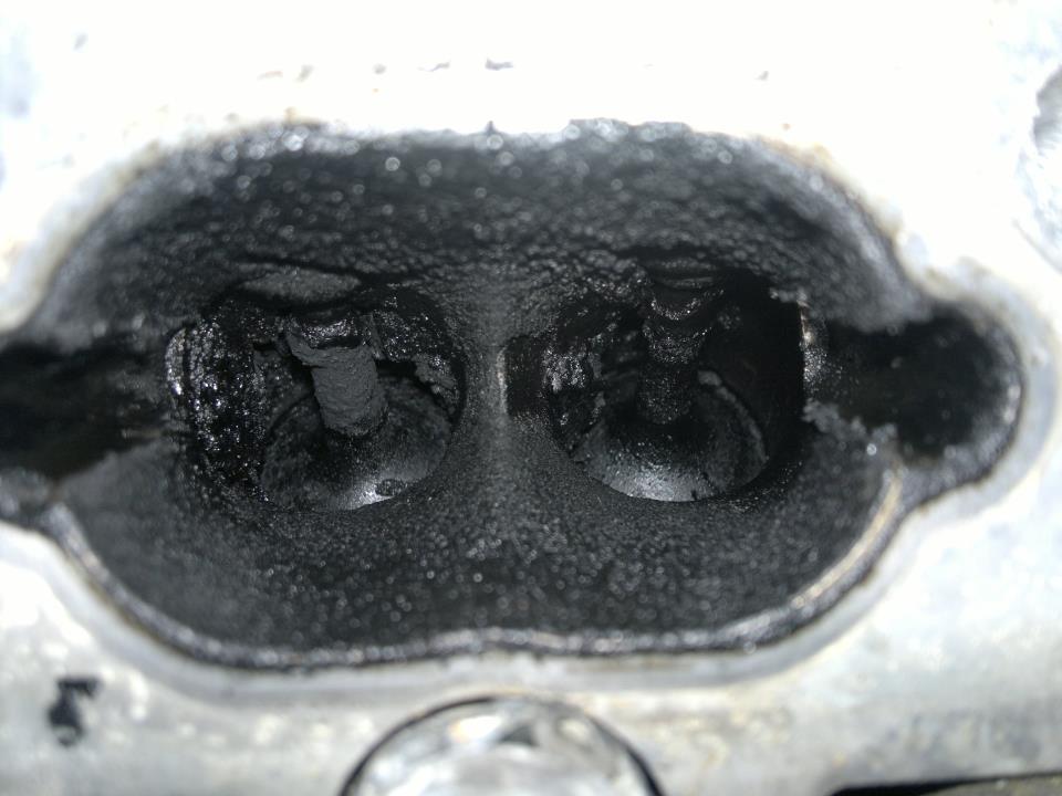

Post by rs4lee » Tue Sep 04, 2012 10:58 pm
this was the carbon build up in my RS4
