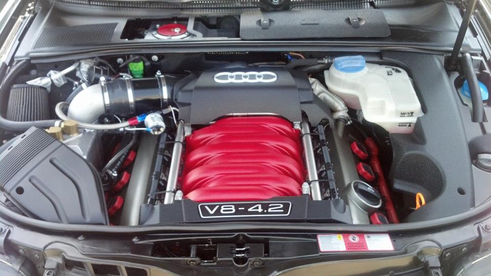

Ads here is a pic of the jhm intercooler set up on the s4, although things might have changed slightly for the rs4 I expect them to be similar.
b7rs4 phantom black, titan pack.

Post by adsgreen » Wed Jul 16, 2014 2:23 pm
Its well hidden :)
Is it the metal lines going to the throttle body area?
Yeah I would expect the high pressure fuel pumps on the FSI to crowd that area.

Here's what I think is a standard B7 S4 engine bay for comparison - it hasn't got the welded box on the left. That's all I can see different.

Ah yes - good spot.
So also quite a way from the cylinders.

...and what's that weird thing where the battery should be in the JHM pic?
