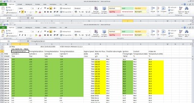

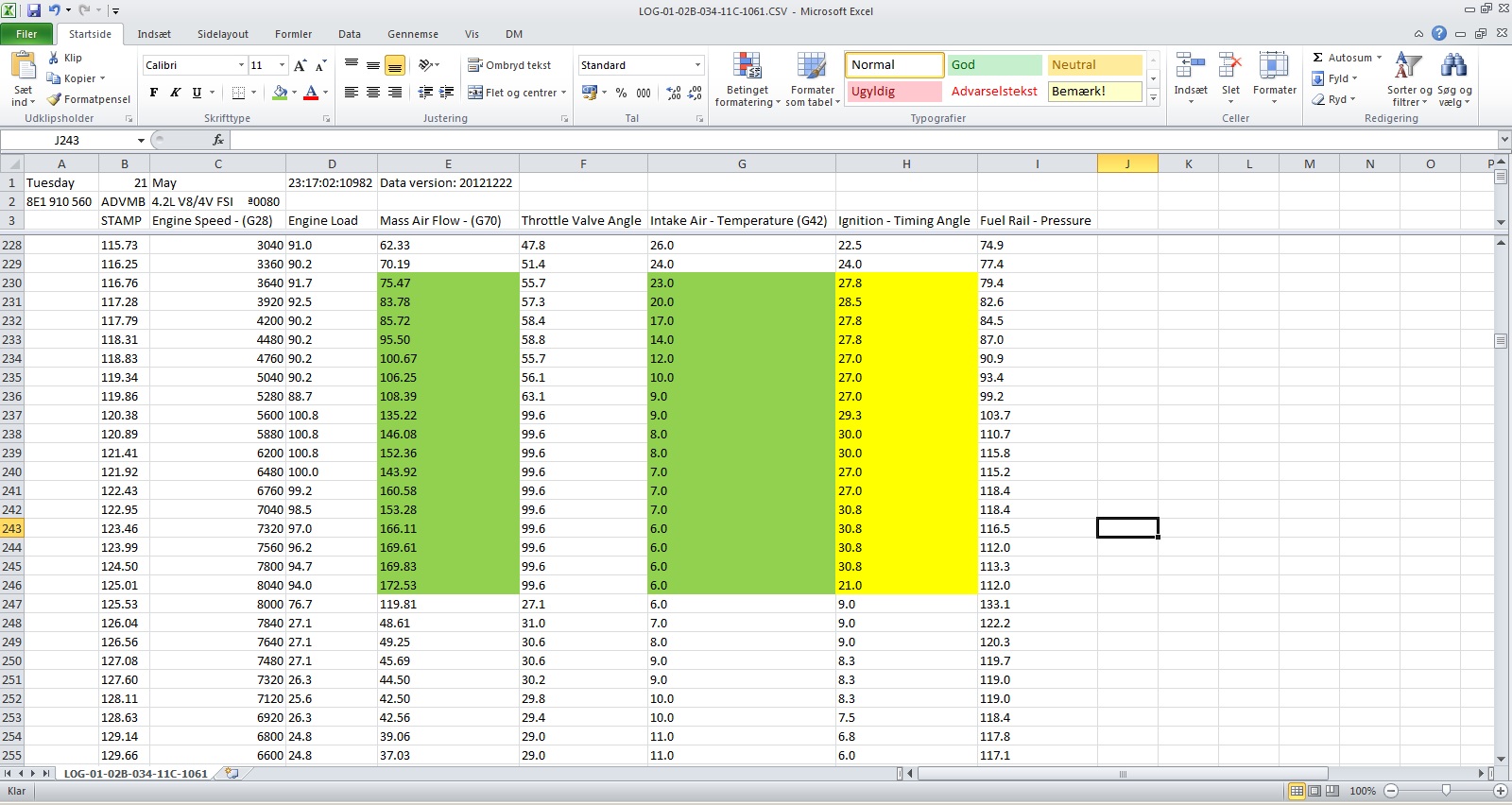

Hi Tony
Would you be able to do some pulls where you measure the Timing Retardation on all 4 cylinders ECU1?
If you create a VCDS adv. Measure (remember the turbo button for logging) with the following 12 measure blocks
Bank Number Value Sensor Comment
1 1 Engine Speed (G28)
2 2 Engine Load
2 4 Mass Air Flow (G70) Specification (Idle): 1.5...3.5 g/s
3 3 Throttle Valve Angle
3 4 Ignition Timing Angle Specification (Idle): 0.0...25 °CF
4 4 Intake Air Temperature (G42) Range: -40.5...+135.0 °C\nSpecification (Warm): < +80.0 °C (max. +115.0 °C)
20 1 Timing Retardation Cylinder 1
20 2 Timing Retardation Cylinder 2
20 3 Timing Retardation Cylinder 3
20 4 Timing Retardation Cylinder 4
31 1 Lambda Control Bank 1 (actual)
106 1 Fuel Rail Pressure
I have compared our data (but still need to see timing <beep> on yours)
I is obvious that your WMI nozzle is pre MAF / TB since you get much lower intake values when the WMI I running – The good part is the denser air, hence more air (you flow 172g at 8040 RPM – 6C temps – I flow 153g at 8080RPM but 28C intake temp – So due to the lower temps and denser air, you actually flow 11% more air than me (not looking at ambient temps)
The downside is that the methanol evaporates when cooling the air, and does not offer direct “cleaning” of octane boost, as when the nozzle is closer to the intake valves (mine is after the TB directly in the intake manifold)
Your timing is very conservative – you have a max timing angle of 30.8, and run an avg. timing of 28.25 from 3600 > 8040 RPM under 100% load – I run 33.98 degrees avg om the same pull, with higher intake temps - = 5,73 degres more timing on mine (avg)
I cannot see your knock / <beep> – I see around -2.3, so could actually run more timing
Remember I am running 99RON (DK Vpower + 15% Water / meth) = around 103 oct RON with the 117 oct meth
Knock values for the 4.2FSI RS4 engine should be between 4 to 7 although less is fine. If sustained knock values under load are over 9 then the timing should be turned down.
But looking at timing advance, I would sustain 20.28 % power on the timing (your avg 28.5 / 5.73 = 20.28%)
I am running timing 5 with the Revo – Could advance to 7 with the meth – but better safe than sorry
My lamda is typically 0.85 under full load - so nice and rich to cool the engine (with the meth also)
It would be great to see these values from your install – also an interesting idea to add 2 nozzles – 1 to cool the intake an tell the ECU / MAF of the cooler intake air, and 1 after the TB to boost the octane / clean the valves and run more timing
Mine
Yours
Mine
Yours
