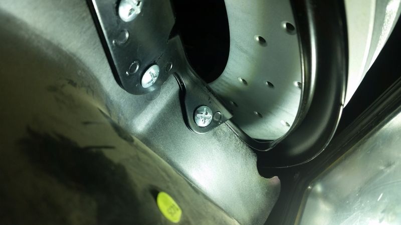

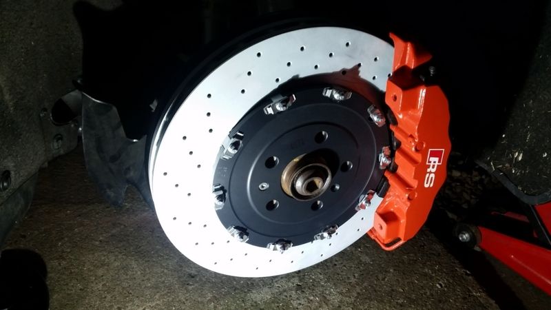

today i fitted new oem disks and decided to retrofit phaeton cooling ducts to help the cooling blowing out crap from the holes and hopefully help on the warping, will update in my build thread soon, they took some fab work but nothing major

Post by DavidRS4 » Wed Oct 28, 2015 7:46 am
Good idea Rick!
